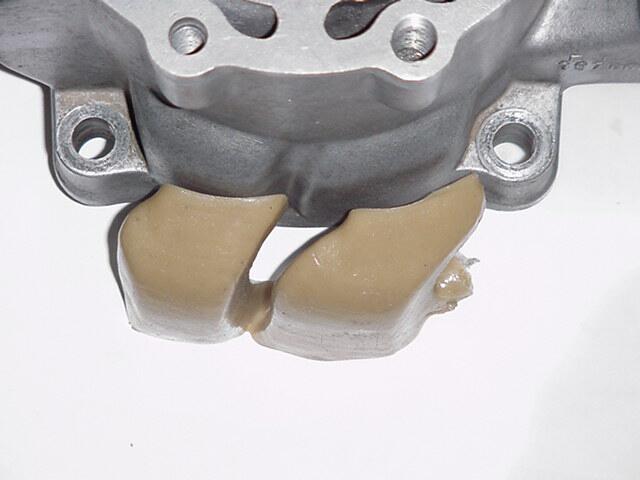

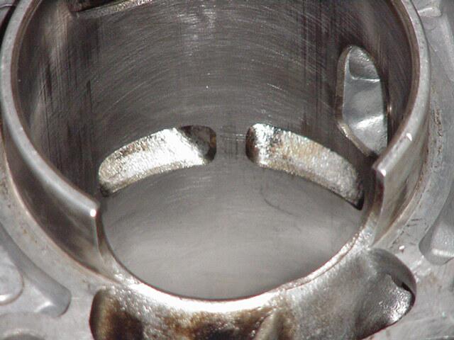

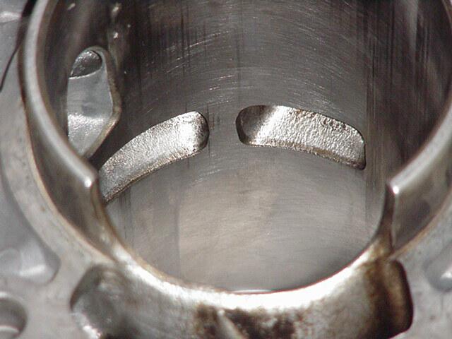

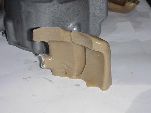

The roofs of the transfers are angled up quite a bit, their is not enough material left in the outside wall of the cylinder to make adjustments.![]()

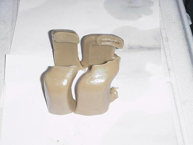

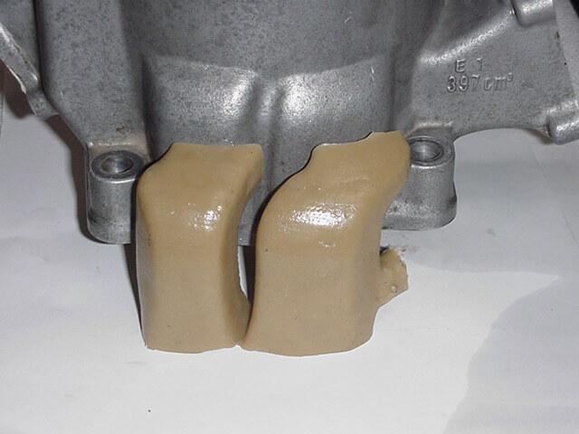

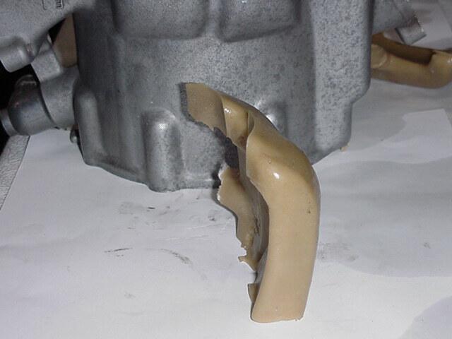

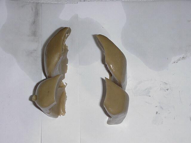

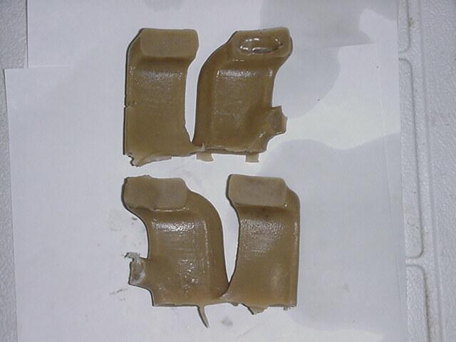

Using the molding silicone Sainty sent me I heated it up and poured it onto the transfer ports to see exactly what they look like.
I still have not perfect using the Vinamold just yet after a few more pours I will have it figured out to where my castings are not hollow and the edges are smoother, once the vinamold starts to cool it will shrink up in the middle I need to have more ready to pour in as the mold starts to cool...
