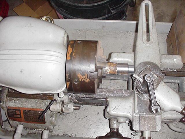

to accept the wider belt, I got lucky when I was in Florida a friend call and said
he was selling his house and needed a place to store some of his shop equipment
some of that equipment included a lathe :-)

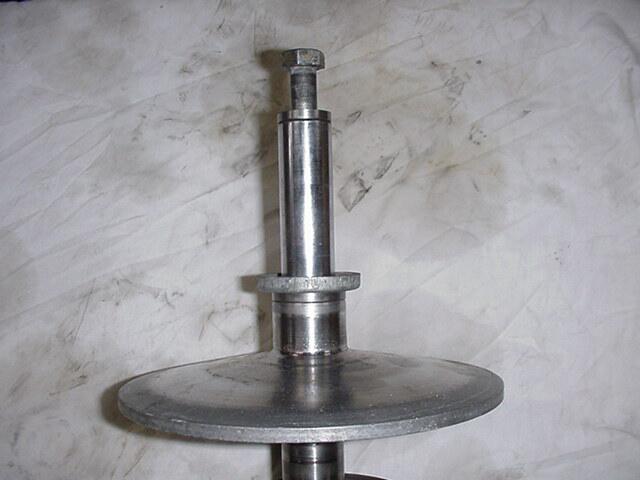

I made a spacer that will sit under the spring and provide enough width to accommodate the wider
belt, doing this will actually compress the spring if you do not make a equal spacer to use under
the cover, now the center bolt that threads into the crankshaft will have less thread engagement
than before, I got lucky and had a longer bolt that came off a junk Power Bloc that used to be
installed on a FL350, it was about 1/4" longer than needed but the length did not need adjusted
because there was enough thread depth i the FL250 crankshaft.

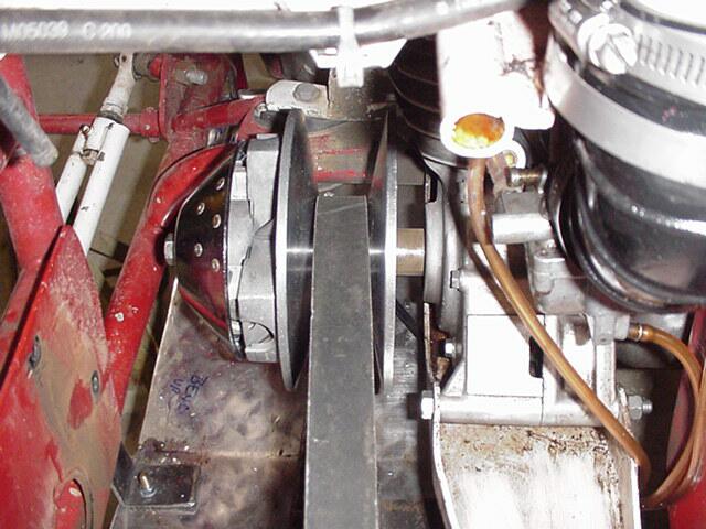

Here is the belt that will be run with the 790 drive clutch, it looks like I have enough side clearance
for the belt for when the engine is just idling.
