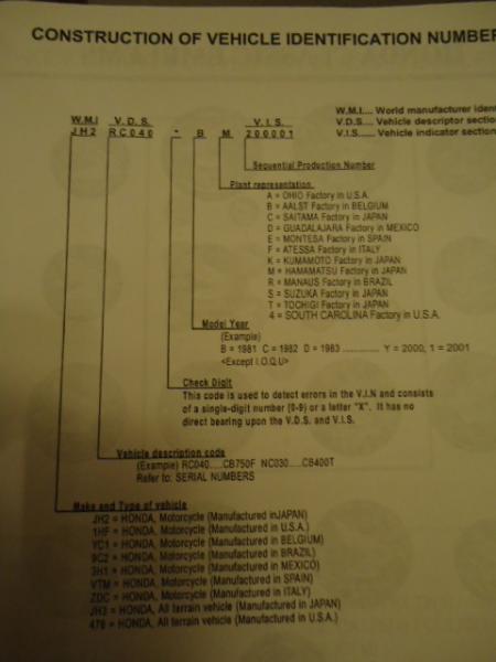

is this what you are looking for????

Resized

That's exactly what I'm looking for! Thank you very much!

My pilot has the last 6 numbers of the vin as 000109. does this mean it should be the 109th pilot off the assembly line?
PostPosted: Tue Jan 24, 2012 6:47 pm
I was just breaking mine down and I can decode it to the last 6 digits. Its the sequential production number but if this was the case they would have had to make almost 103,000 fl350's for my number to make sense. Could they have made that many?
PostPosted: Tue Jan 24, 2012 11:42 pm
From better examining that picture It appears the 2 wasn't actually part of the production numbers as the example is 200001. I'd guess the example would be number 1. so I'm thinking that I've got FL350 number 29xx off the assembly line? Maybe? If that would be so that's a way at finding out about how many have been built or at least give us a ballpark. I've seen the question before and can't dig up an answer on how many were produced so let's see if we can make some sense of it. Who has the highest number on the forum?? Ballpark is best as I'm not sure if anything negative could be done with our VIN numbers. So if I've got 29xx who on here has the highest number??? ::-:

Many honda VIN numbers start at 100000 or 200000 that doesn't mean they make a 100,000 just how the VIN started not many start at 0000001 ....i can post what numbers they started at if that's any good???...for oddy and pilot the last 4 numbers is the production number....
