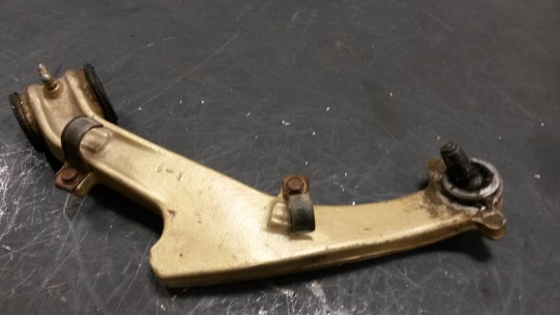

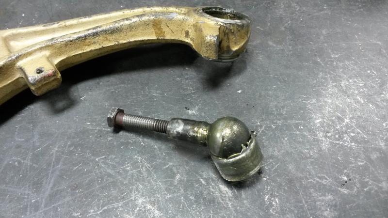

Since everything is basically done I decided to look into my busted parts box to see what I could find to fix. Found a bottom J arm with a snapped off ball joint. This is the one off of my brothers machine when he crashed it and went a good 130' down the side of the mountain. I actually have two of these in that box but I don't remember where the other one came from. Here is that thread: viewtopic.php?f=2&t=16961&hilit=another+crash+brother
No it's not fukd. This is repairable.
Anyways pic below and more to come.

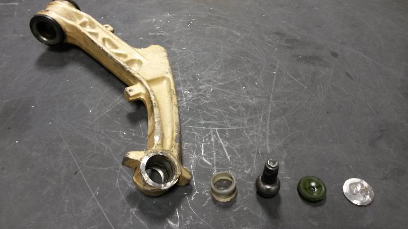

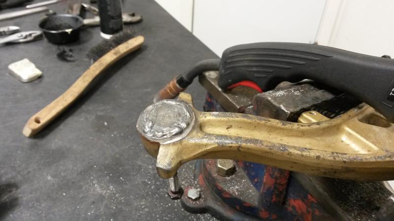

Well I basically finished it tonight. Still have to cut the head off the bolt, make a castle nut and drill a hole for a cotter pin.
To make a castle nut you can get one of those electrical cable tray coupling nut. Basically these a long hexagon threaded nuts used to join ready rod together. Some of you call it "all thread". Cut a piece off and cut slots on one end for the cotter pin to pass.
I know what you guys are thinking: 1) the idiot used coarse thread -- yup it don't matter because no real load on this because it's the taper that holds it all together 2) how are you suppose to lube this mess ?? -- you can't. No place to put a grease nipple. You prelube it with grease during assembly and the babbitt had small pockets on it where I put a bit to much grease on the pieces pre-pour. This left very small voids for the grease. Also babbitt (lead) is soft and not going to grind up the ball joint 3) The fool removed the plastic sleeve at the top end so now it's metal on metal -- yup this is one of the trade offs. This is not the Honda factory here. You could possibly use your old sleeve if there is anything left but this one was very very thin. You could see your finger right through the side of this one. The ball joint will not fall through the top hole anyways. Everything must come out the bottom end.
When this thing was all together it was real nice. NO play and you had to put the bolt in it to swivel it around. I got full rotation with no binding. This was just an exercise to show that you can rebuild your old joints successfully. It's better than throwing the J arm away. I am confident in this repair and would not hesitate to use it.

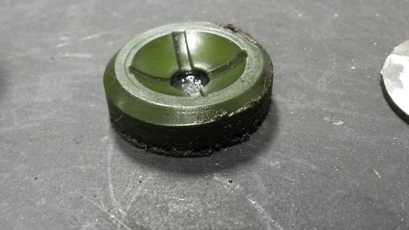

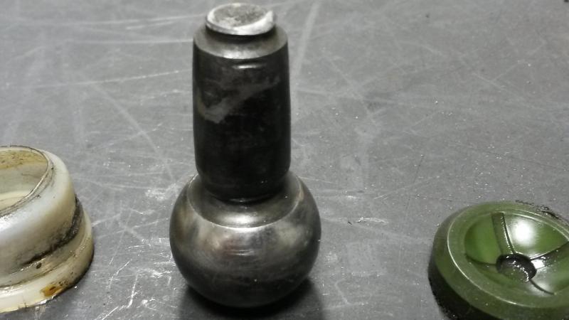

File comment: Grind around the bottom cap until you see a line around the cap. Then tap the ball joint and everything will come out the bottom

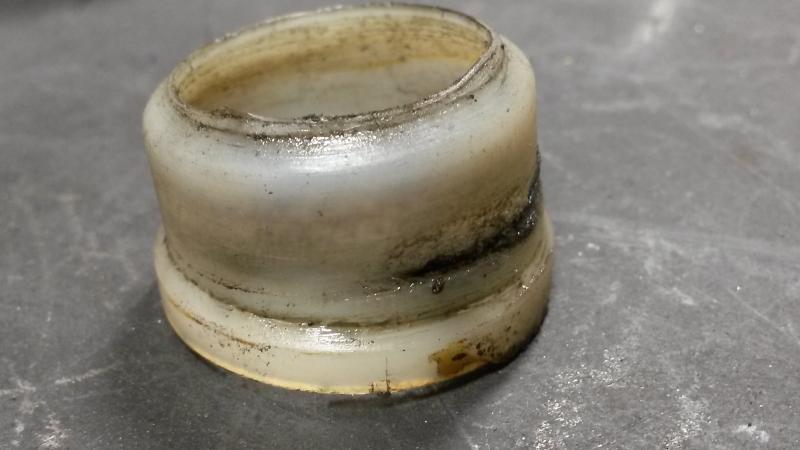

File comment: plastic sleeve
File comment: ball joint
File comment: bottom plastic cup

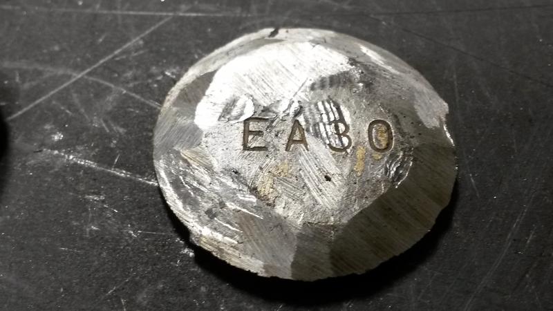

File comment: end cap

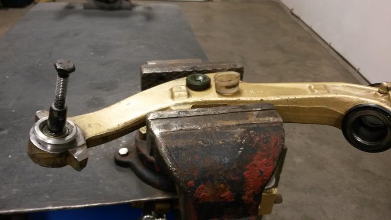

PostPosted: Wed Feb 14, 2018 3:10 am
More

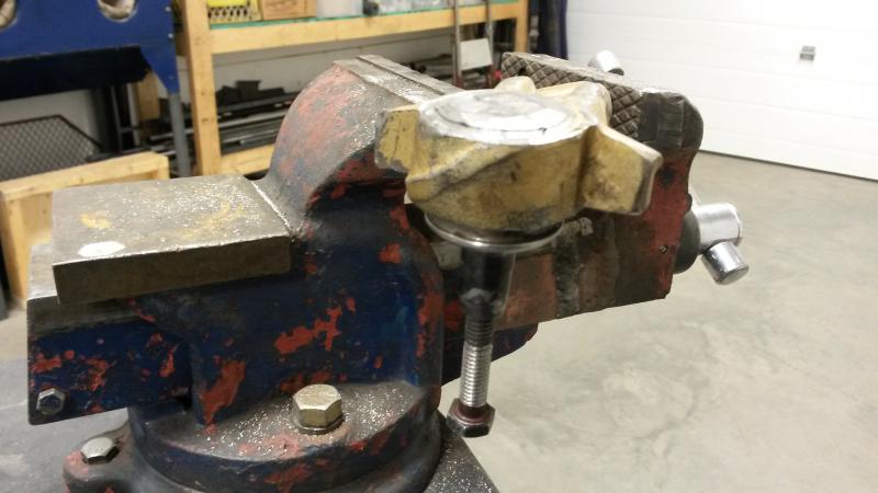

File comment: Grind the top broken part flush. Drill a hole in the ball joint about 3/4" deep and tap it for a bolt. Do not drill all the way through.

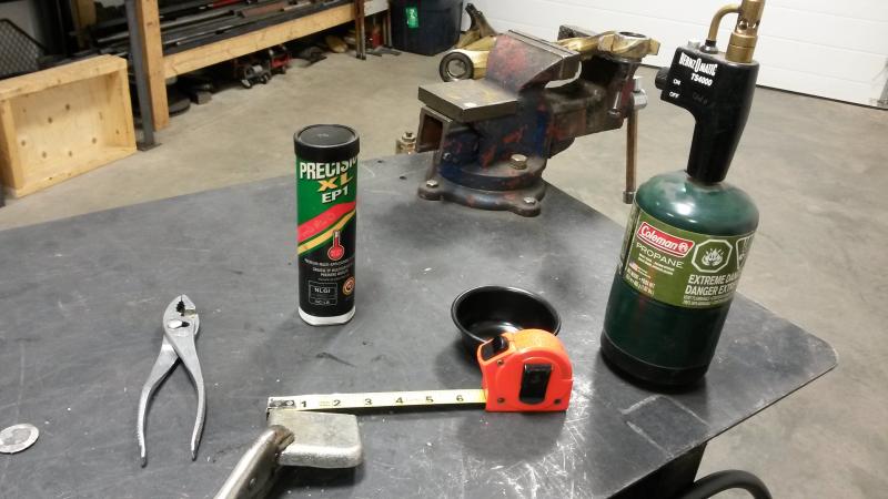

File comment: get some Babbitt from an industrial supplier

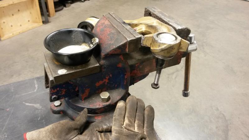

File comment: this stuff melts with a propane torch so melt some into a metal cup. Hold the cup with vise grips. Use leather gloves, glasses and a face shield
File comment: Grease up the ball joint and inside of the J arm. Put ball joint in and fill with Babbitt.

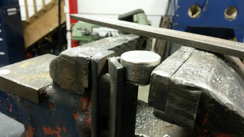

File comment: After it cools just tap it out and clean up the Babbitt edges. It will come apart easily.
File comment: You will most likely have to file the bottom of that Babbitt plug so that you can get the cap on the bottom again.
File comment: Grease it all up again, put the cap on and reweld
File comment: welded up
File comment: use some 680 Loctite to secure the bolt in the hole. Cut the head off the bolt and make a castle nut.

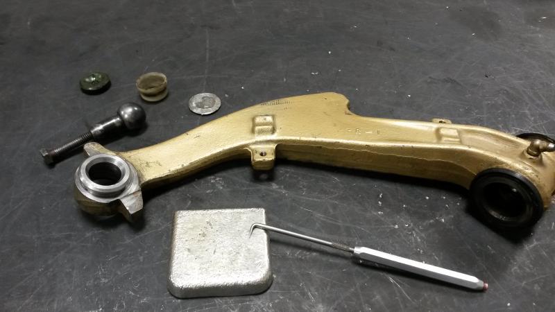

Just one of the many places you should be able to get Babbitt: https://www.amazon.com/Alloy-Number-Bab ... bitt+metal
Seems a bit expensive but I never had to buy any. We had that stuff by the ton where I used to work.
If you look at the pic with the tape measure you will see that ours came in 2 1/2" square bricks. I think its only 3/8" or 1/2" thick. I only had to use 1/4 of that brick for this job. Only melted half of the brick into that hot cup.

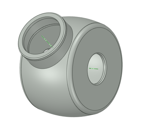

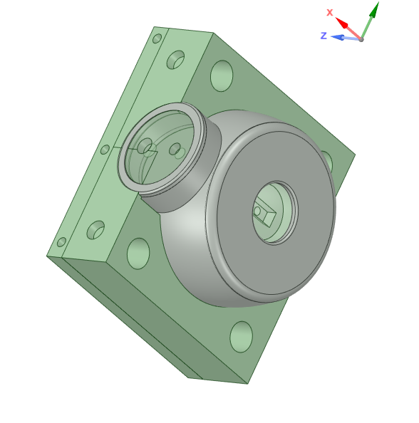

I'm also experimenting with molding to make suspension link dust boots, since the originals are NLA and I couldn't find a suitable replacement. In my case I recreated it in DesignSpark and then "subtracted" it from a box to make an injection mold. I use a medical syringe to inject the urethane rubber into the mold. I printed it on a resin 3D printer. I bought the rubber mix from SmoothOn, the same company that makes that Vytaflex you're using. I experimented with some flexible resins for the 3D printer, in hopes of just directly printing rubber parts, but they were not durable enough.
My first experiment was not successful enough to make a usable part, but successful enough that I think it's doable with some tweaks to the mold and my process. One aspect that may be an issue however is that the cured rubber had micro air bubbles in it. I may need to invest in a vacuum chamber. I'd been on the fence about one of those for other needs so I'll probably just pull the trigger on it and get it over with. BTW, I'm not an engineer or anything like that. I'm just a tinkerer that takes satisfaction in learning new abilities. Sometimes it's a hammer looking for a nail, if you know what I mean. But it keeps me busy and my mind occupied.
