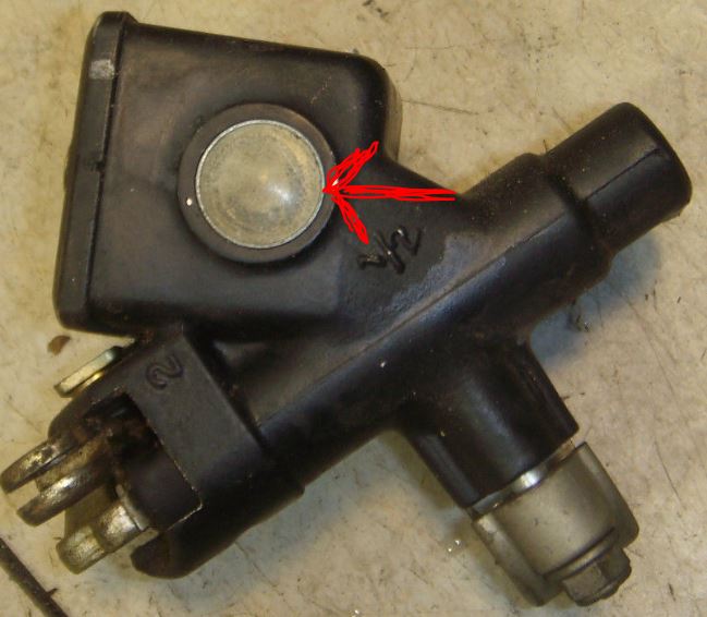

Hello,
I have a question regarding rebuilding the brake master cylinder. I know that you can buy the rebuild kits but none of the kits I have found include the sight glass on either side of it. Both sides on mine have dry rotted / cracked. I have seen pictures from others that have replaced the glass so I know it can be done. If anyone has any info on a replacement part # or where this item can be purchased from it would be greatly appreciated. Picture for referance.
Thanks, Curtis

Check with user "B S" to see if he still has any: http://www.pilotodyssey.com/PO/viewtopic.php?f=4&t=14143
Or check here: http://newrivercyclesalvage.com/sight-glass.html
Or measure and compare to the ones on evilBay: http://www.ebay.com/sch/i.html?_from=R40&_trksid=p2050601.m570.l1313.TR0.TRC0.H0.Xhonda+master+sight+glass.TRS0&_nkw=honda+master+sight+glass&_sacat=0
Also...
Replace the master cylinder cover screws and use some anti-seize on the threads and even the taper on the screw head.
And...be careful with brake fluid. That shizzle EATS PAINT!

I used this one on mine:
Look at this on eBay:
https://www.ebay.com/itm/360717704115
FL350 Odyssey master cylinder sight glass lens window

Thanks for the help & tips guys! I ended up ordering them from new river cycle salvage because it comes with the new screws. :-)
