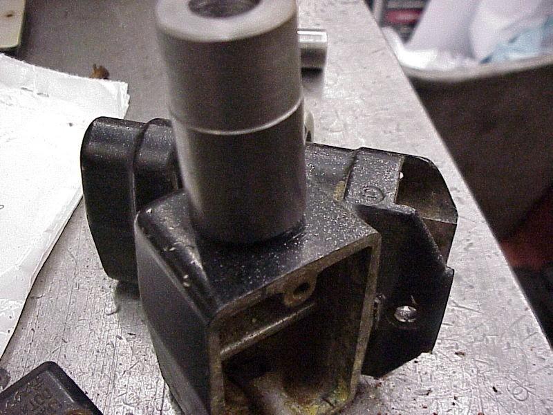

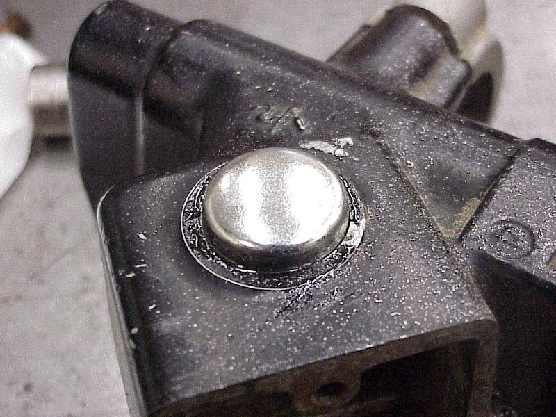

Hello I did this last year on one of my master cylinder so I thought I would share
what is needed
one bad master cylinder with leaking lens :shock:
set of 18mm frost plugs from auto parts store advanced auto part # 362744.1
small amount of Loctite 680 retaining compound
now this is going to sound wrong but this is what worked for me
Put the frost plug in the wright way cup in by pounding with hammer :-)
and steel piece of round stock or socket
after it is in put a screw driver on the in side and push it bake out
it should push out easy. You just re sized the frost plug to your master cylinder
now put a small amount of Loctite 680 retaining compound on both surfaces
you can try to reuse the o-ring but it my just squirt out on the inside of the master cylinder
and its not needed.
now put the frost plug in backwards cup to the inside of the master cylinder
tap it in with hammer :-) flush to the out side
now take a ball peen hammer or a ball bearing and peen it in and make a small cup
there you go all done
Note you should give it 24 hr for the retaining compound to set
thanks for looking SpeedChaser

File comment: put the frost pug in backwards with retaining compound on both surfaces small amount
