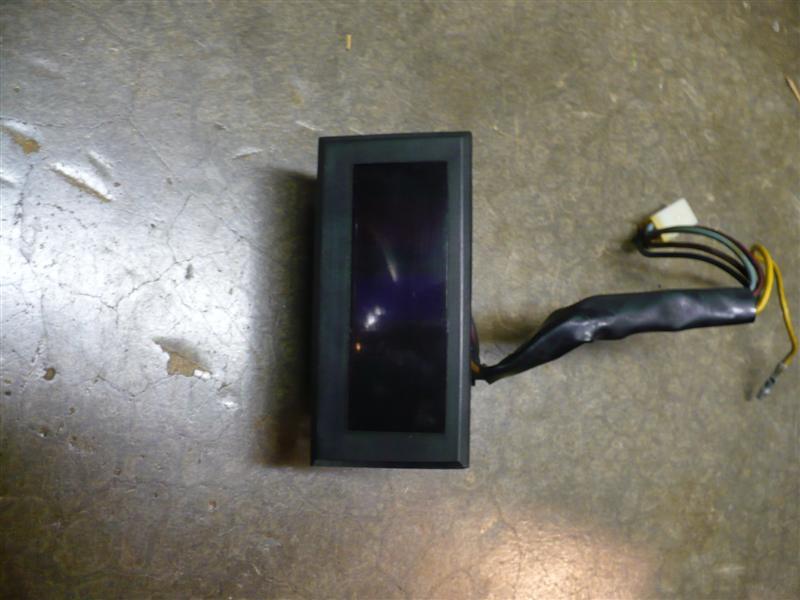

were designed for an 82-91 Camaro. I used a neutral/oil/high beam indicator panel
from an 83 Yamaha XZ500 Vision. This panel fit nicely into the Odysseys steering wheel
with minimal modifications. This particular indicator panel had all the necessary light
colors for my project .The neutral light was used for my neutral position indicator light,
the oil light was used for my emergency brake position indicator light and
I tied the high beam light into the high beam switch in the Odyssey steering wheel.

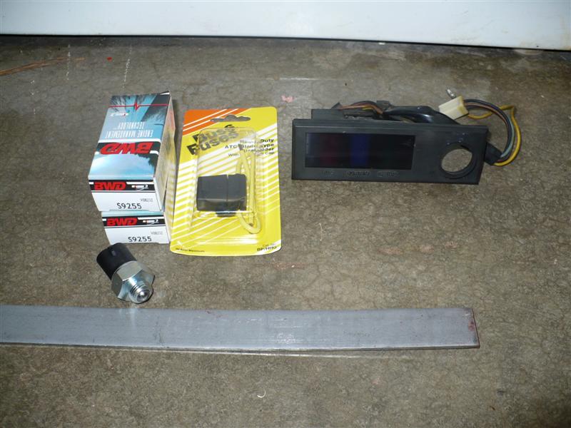

File comment: two Borg Warner switches for neutral and emergency brake position activators,waterproof fuse
holder,Yamaha indicator panel and 1"X1/8" steel stock used for switch brackets

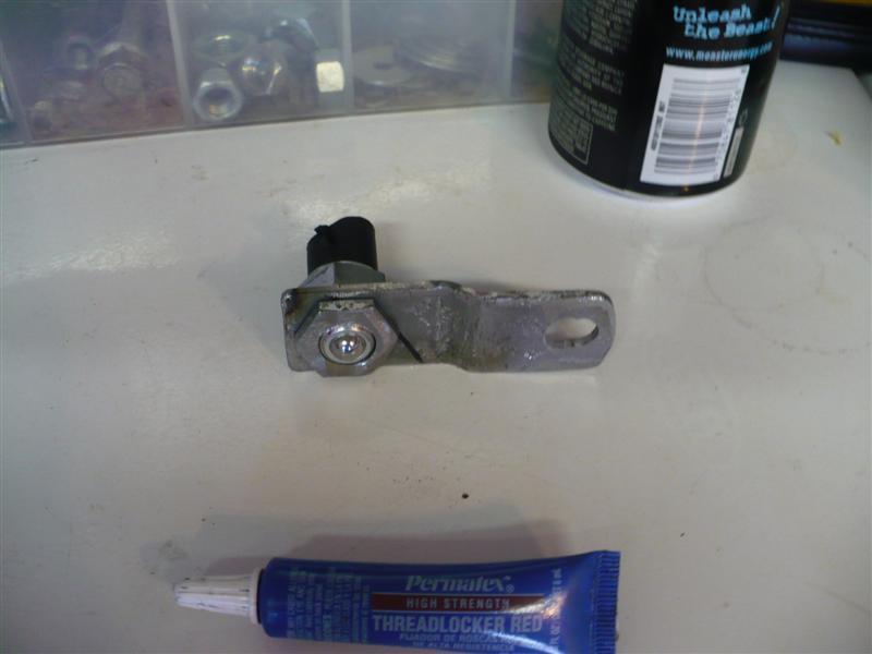

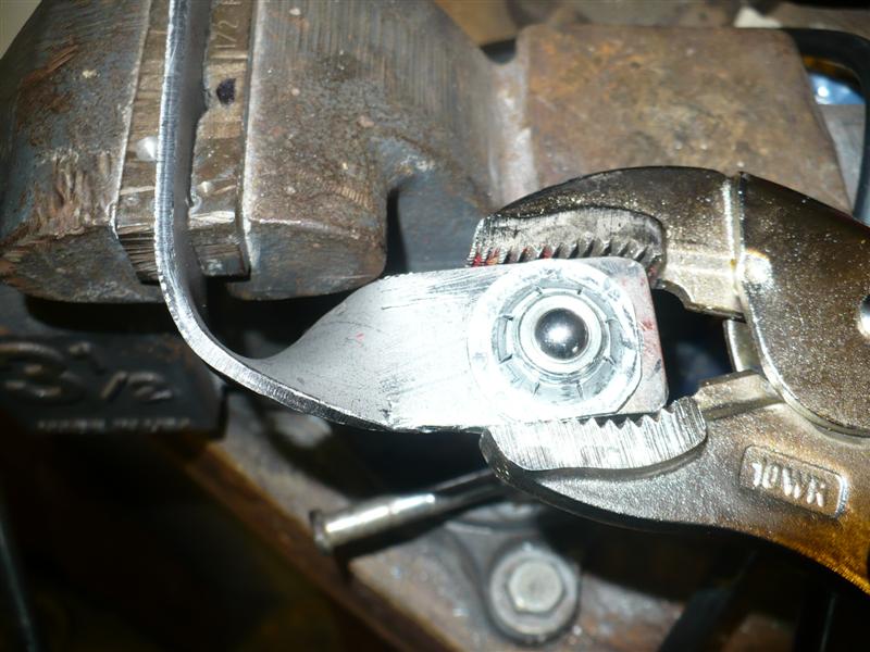

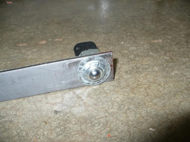

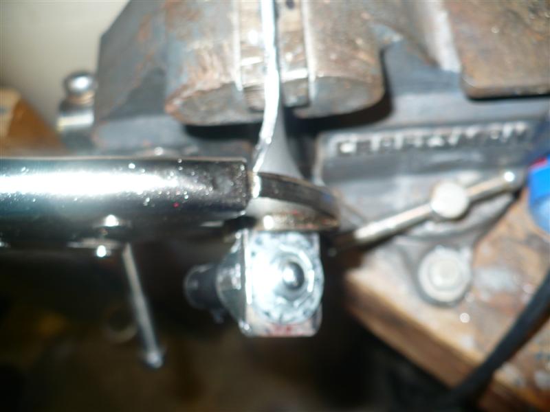

File comment: switch mounted in steel stock and ready for "neutral position" bracket fabrication.
I used a castle type speed nut to hold the switch in place.

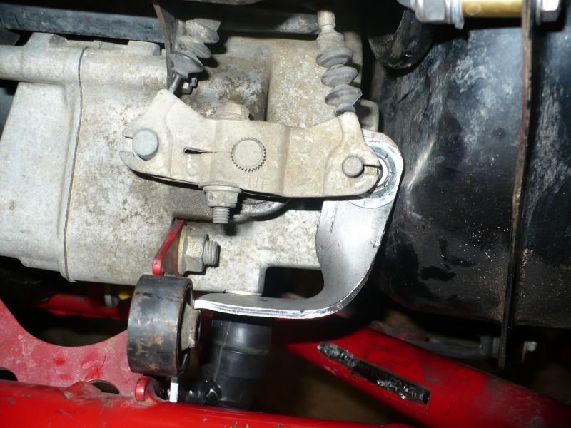

File comment: bracket complete besides rustproof dip and drilling mounting holes

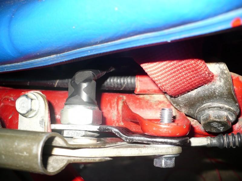

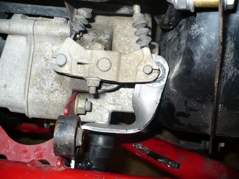

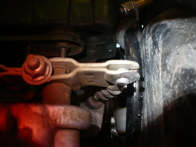

File comment: transmission lever was slightly beveled to allow lever to pass over the swith without binding. Both sides of the lever were filed
File comment: switch mocked up to properly align switch to transmission's shift lever,notice bracket is very close to gas tank, will later add rubber shield in case tank or bracket moves.

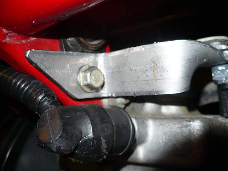

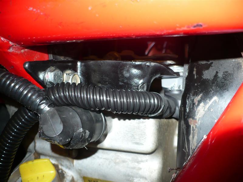

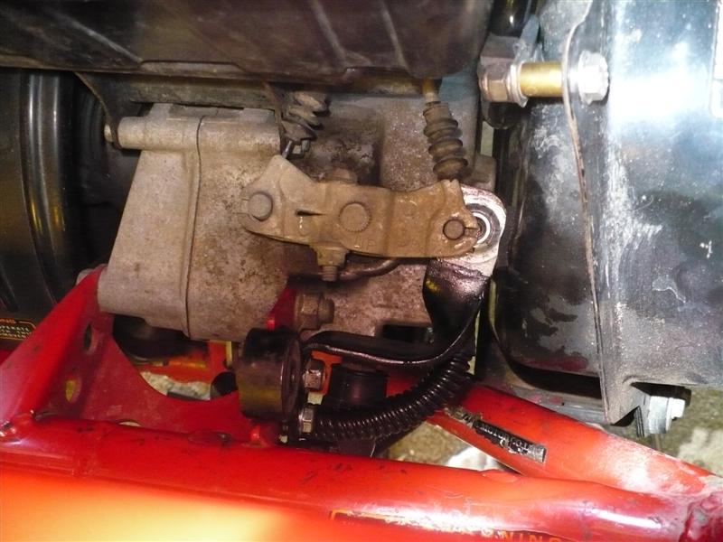

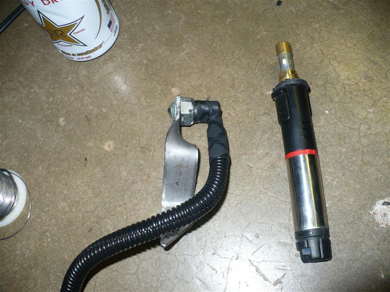

File comment: attaching wire, wire loom and heatshrink to switch

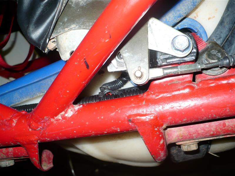

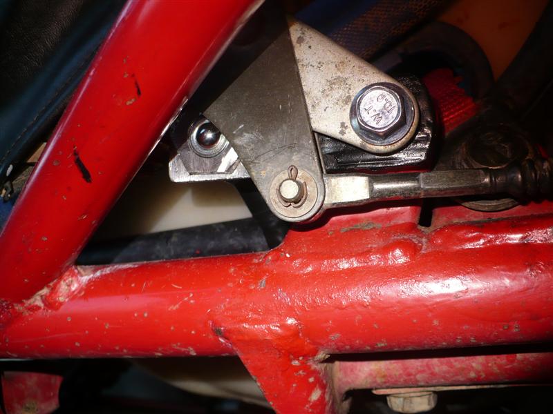

File comment: attached neutral switch bracket to frame with muffler's "right" bracket bolt. Will later add another bolt to bracket for better rigidity

File comment: emergency brake switch bracket complete besides rustproof dip. Used a jam nut to hold switch in place, had to grind jam nut to a smaller thickness due to lack uf threads on switch.Used loctite on threads

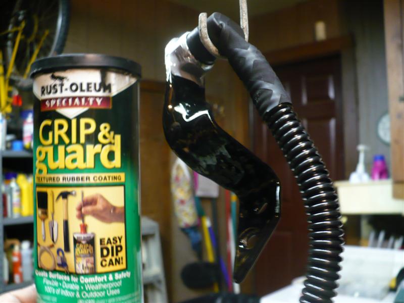

File comment: Dipped bracket in rustoleum's rubber coating to help control rust on bracket

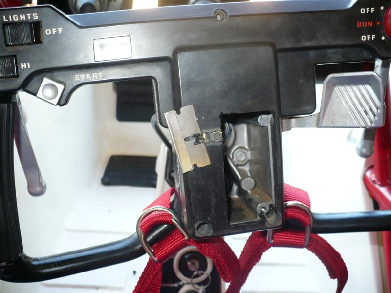

File comment: slightly modified the Yamaha's indicator panel by cutting off the ignition portion and beveling the sides.

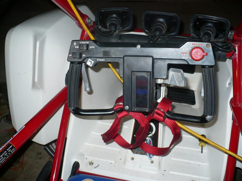

File comment: this pic shows ebrake in the "off "position
File comment: this pic shows the e-brake pulled up and engaged. Notice the switch is now engaged.
File comment: mocking up Yamaha's indicator light assembly in the Odysseys steering wheel compartment.

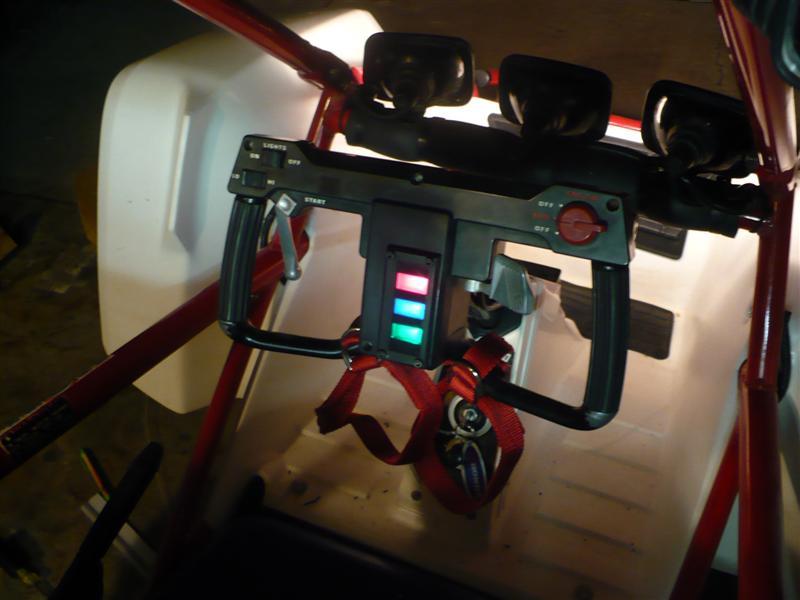

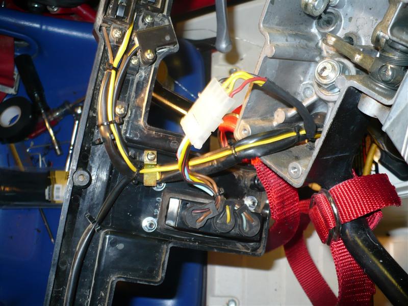

File comment: indicator panel mounted,I used a simple 4 pin plug for easy removal.When installing make sure plug and wires are not obstructing the throttles lever travel and cable.Ground,and both switch wires were pulled through the Odysseys steering wheel grommet

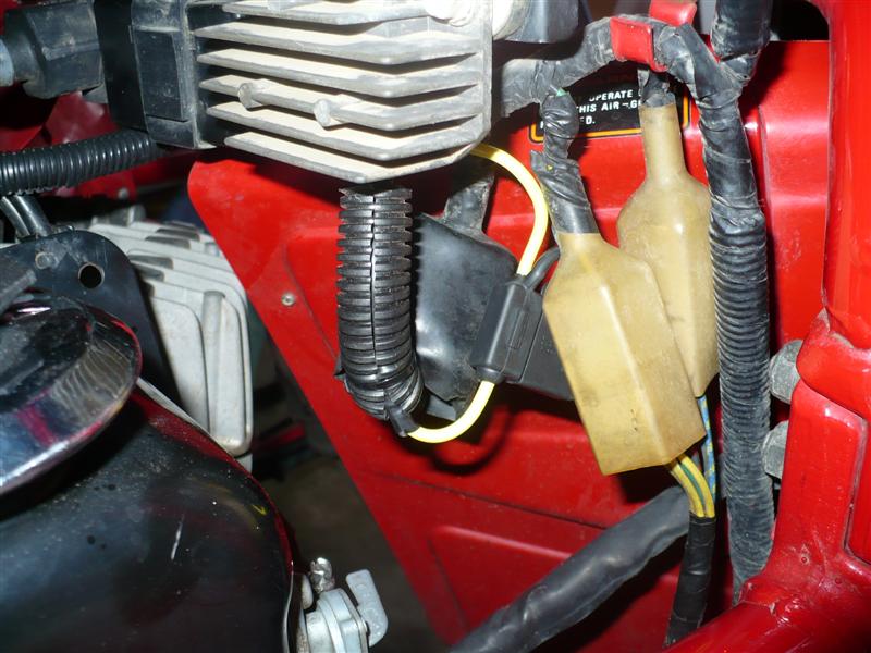

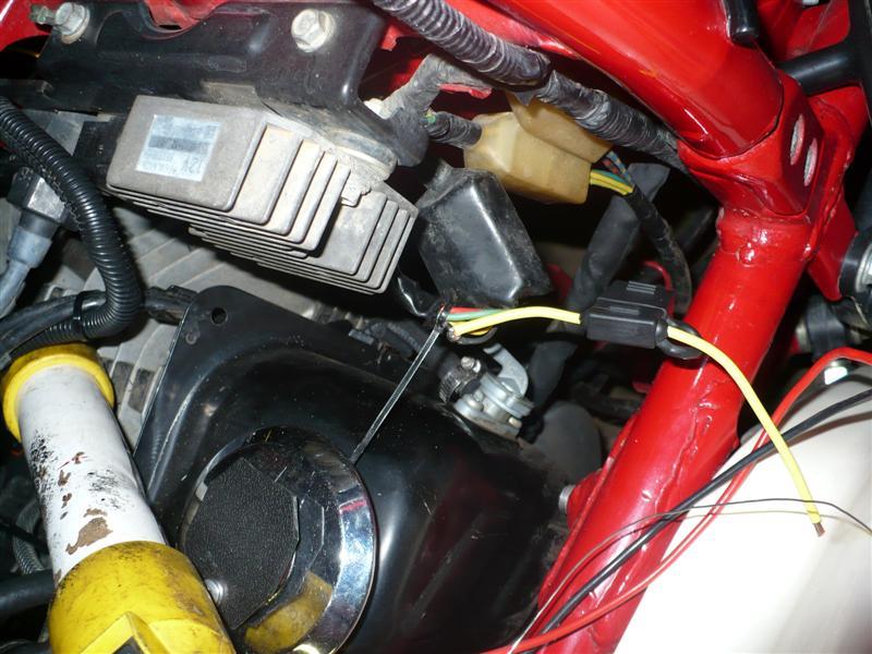

File comment: Both switches have two terminals.One wire from the terminal of each switch goes to the steering wheel and the other goes to here,the Odysseys regulator. From the rectifier is a black wire, this wire feeds the lighting,starter relay etc.

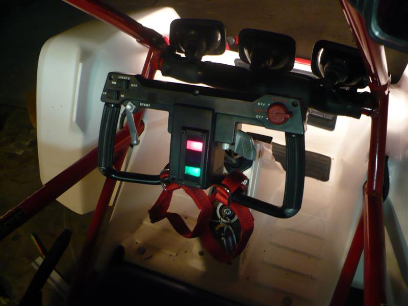

The fused holder was not necessary however if my indicator panel, switches or wiring shorts it will be easier to trace with this fuse in place, I used a 5 amp fuse. All three indicator lights were grounded at the rectifier bracket's grounding bolt. You can see two green wires there. I grounded them there so it is easy to find later if I have a bad ground.
I thought about simply getting some panel mounted LED indicator lights for this project but no one seemed to know if the lights would show up in direct sunlight. I could have gone with super bright leds but then they would be blinding at night. I figured a factory panel would be built and suited for both daytime and night time applications. This panel shows up well in direct sunlight and the high beam indicator is not glaring at night.

File comment: new loom to stering wheel
