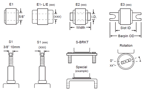

The problem here is that you have to verify bolt sizes and you will find that most do not use the large bolt the oddy uses on the rear shock. Also you need the correct shock ends so verify this before you order shocks (see pic below, you need the E1 style), I know Polaris uses the S1 style. Also the weight of the machine these shocks come from must be close to an oddy or the valveing will be off. But anything is better than the stock setup. The only problem with the oddy rear suspension is the spring rate. If you buy a set of 170 lb approx springs then the rear suspension is good. You only need shocks if yours leak and your to lazy to rebuild yours.
