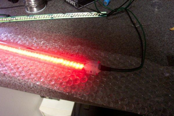

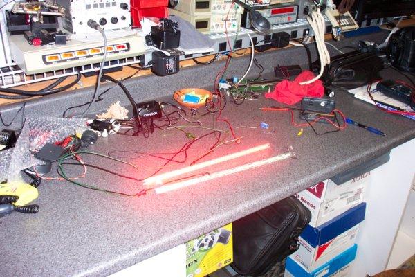

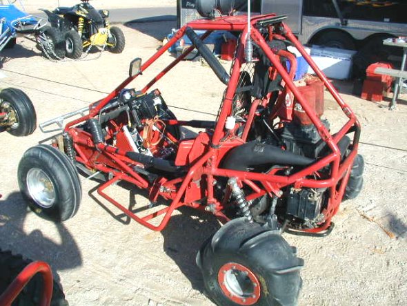

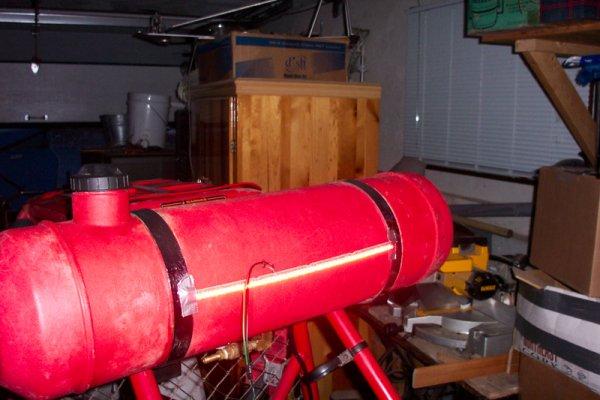

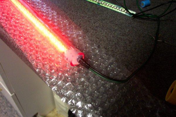

Pics of the old design using flexible tubing and silicon end caps.
The current design is a PlexiTube and marine Epoxy end caps.

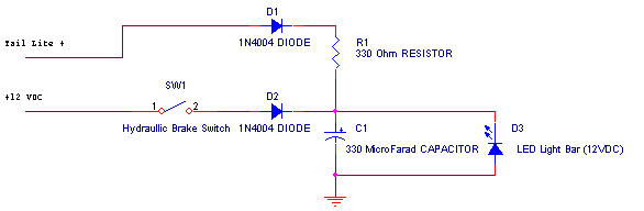

They work fine with the stock harness.
On the 350 I had to add a banjoe bolt switch for the brake lite.
Dim for lites and bright for brake is done thru this circuit.
I beleive 8VDC is my desired dim voltage.

The LED bars showed up today.
There not the same but, similar.
The spacing on them is a bit more than the other ones I had gotten.
Thus they are a bit longer too. Bummer we want smaller.
Similar brightness. However I wouldn't think they will be a band of light like mine
already is. We'll see though.
I'll need to post pics.

Well initial looks are still looking good.
Some measurements show they appear to draw more juice. 600ma at full brightness. Not bad.
On one dim setting using 330 ohm resistor make the volts drop to 10.16 volts an draw 11 milliamps (ma).
Now a little brighter resistor setting 165 ohms it drew 20 ma and that's at 10.5 volts. That was bright enough to see it beam on the ceiling.
The input voltage was 13.9 volts from a bench power supply like for a CB.
A plus though. I should be able to trim these shorter. Use the excess parts for prototyping the OEM replacement.
I could use a light meter now.

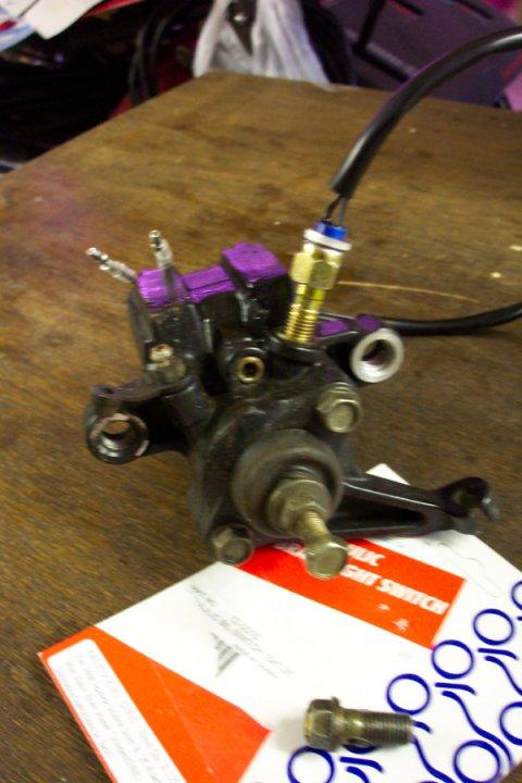

OK for the 350 guys we need to add a brake pressure switch to the rear brake caliper.
this goes onto the / replaces the banjoe bolt that bolts the brake lines to the caliper.
The one I used is a K&S Technologies Inc. Hydraulic brake switch
Part # 12-0010 its a 10 mm dia. x 1.25 mm pitch single bleed brake switch.
http://www.denniskirk.com/jsp/product_c ... uId=210369
Credit for this switch really needs to go to a member that I've lost track of whom they are. A year + plus back someone noted these switches and I got one and tried this out....
more to come.

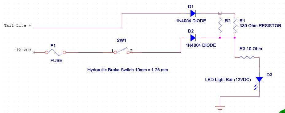

More info:
Here's an update to the schematic for the new LED bars we located.
Note: The 12 VDC remarks are relative. The input voltage was from a 13.8 VDC source.
The New LED bar is sensitive to over voltage. The inline resistors compensate for the vehichle
voltage. Assumming a decent regulator is inplace on the vehichle.

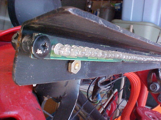

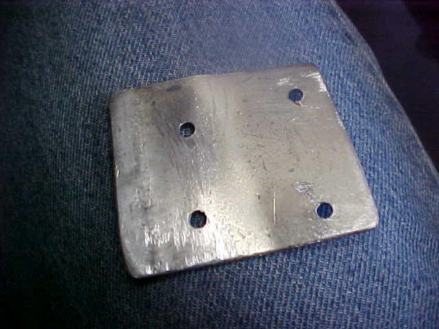

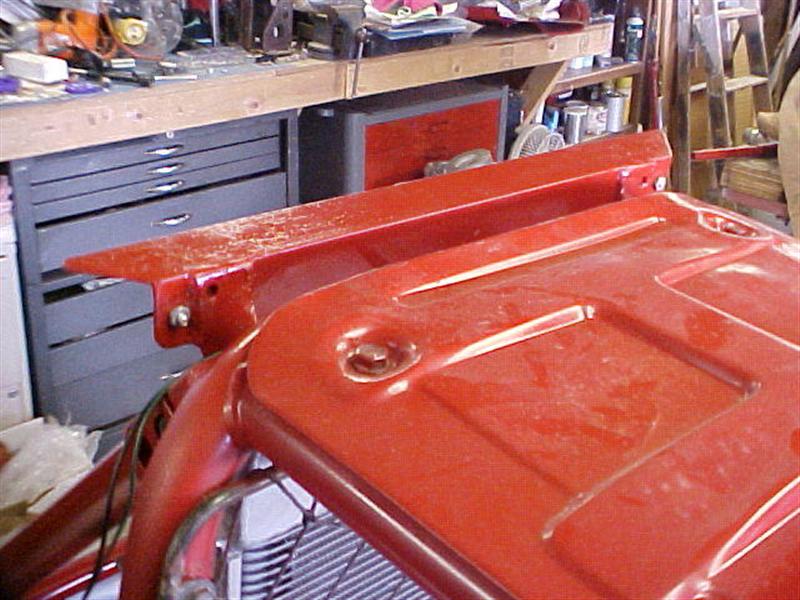

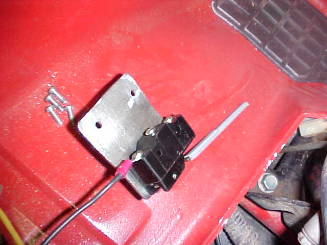

I have made a couple of "Shade Tree" LED brake light/tail light setups for my 350s over the last few years. I got the LED brake light strips from Ebay for 10-15 bucks. I mounted them to a piece of angle iron. Next, I put a diode and a 330 ohm resistor in line with the factory tail light wire so the power will be dimmed with the lights on(tail light). Next I ran a couple of switches from the key on(hot 12v) wire behind the key switch to two long armed micro switches that I mounted to a plate to support them. The long switch arms ride on the brake arms above the master cylinder so the switches with close when either brake lever is pulled(raised). I ran another wire from the outs on both switches to just above the resistor/diode combo so it will allow the full 12V through the LED when the brakes are applied, not just the dim tail light voltage. I have been using them for around 3 years and have had no problems. Odyknuck told me to try using a hydrolic switch (in the brake line), but never have tried it. I painted one red and the other black. Any more questions about my setup, just ask.
Gary

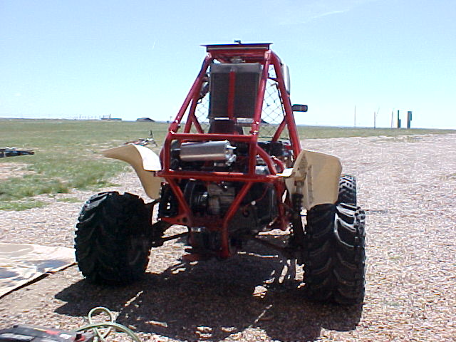

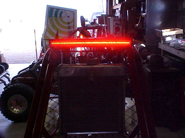

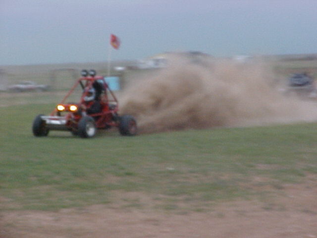

A few more pics......
Hoser, Dennis, Jerry, Lightspeed, Ike, Curtis, Fed and several others have seen them in action and I have been told they work great when following me.
PostPosted: Mon Jan 22, 2007 4:03 pm
Posts: 805
Location: Bolton Ma
Hi Nukem.
I believe it was your original posting and chat on your lights that got me motivated to make mine. THANKS!
That is right it was the suggestion to use a hydraulic switch that got me going full steam. They work great. I chose to only trigger off of the rear brakes only.
They do work great when following. You can see them through fog / dust very nicely.
