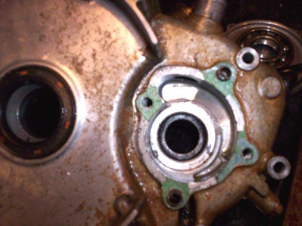

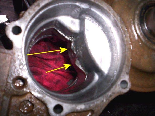

File comment: area under water pump impellor, piece of shoulder is missing

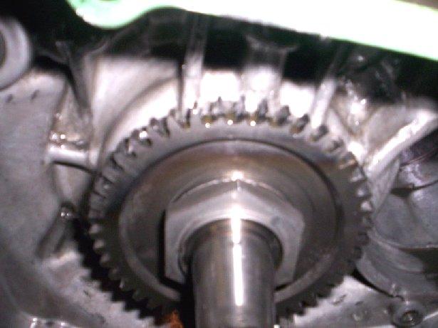

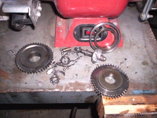

File comment: balancer gear teeth wasted

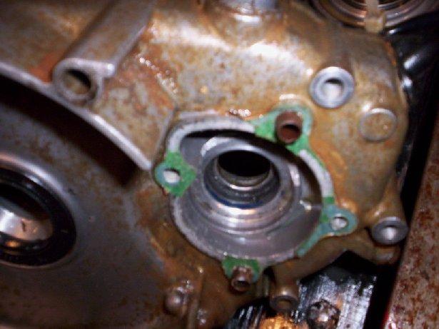

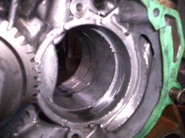

File comment: damage to r case where balancer bearing goes
File comment: damaged teeth on balancer drive gear

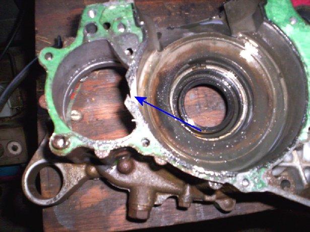

File comment: looking inside balancer area, you can see where last mutt assembled the case with part of the gasket sticking out wft!
File comment: wp shaft broken

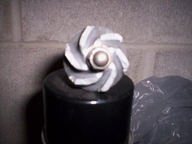

File comment: wp impellor wasted
File comment: area on case where gasket wasn't install properly yrs ago

On another note is it possible that that gasket failed? And not installed correctly.

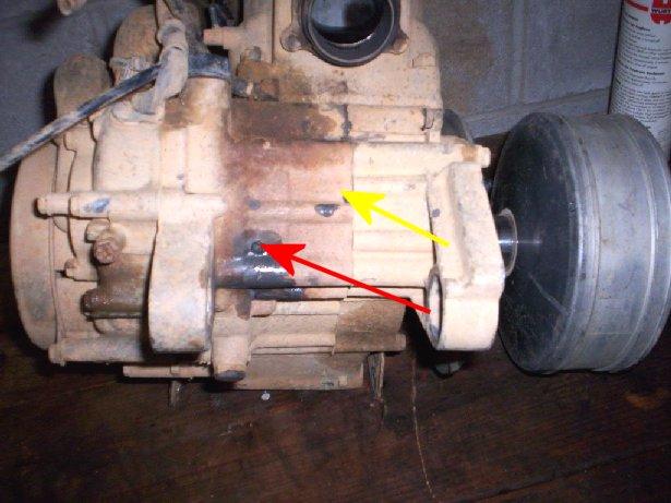

PostPosted: Sun Jan 11, 2015 12:03 am
Posts: 550
did the case get welded up or did it get replaced on this, My son broke a piston that intern broke the case in several spots, I figure if I can weld on the space shuttle the Engine case was a breeze. We re machined both cases put it together with a lot of new seals and bearings had the cylinder done up to match the new piston and she is ready to put in. Just put 240 Ml in the balancer and going to install after dinner. I know this is a old thread just wonderd if they did what I did or replaced. I found the cases to be the easiest thing on the whole darn pilot to weld to! The steel is absolutely crap to weld on, the cases easy go figure lol
