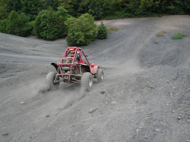

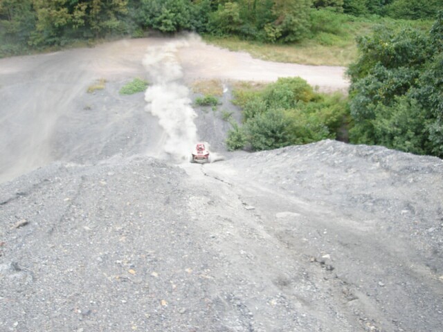

I was going through some pics and found some of PilotNuts pre filter mod I took while we were at ECJ, great proving grounds plenty of dust that day.
Air box dual inlet mod.

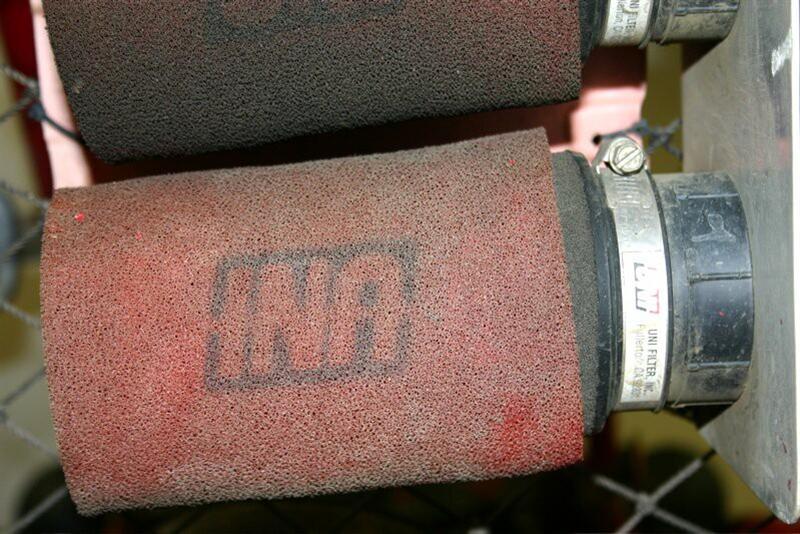

Pre-filters doing their job.

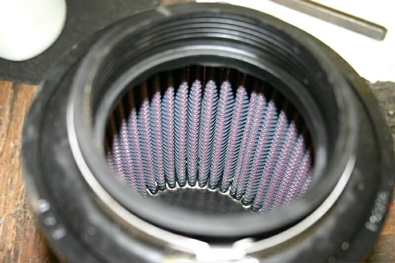

This reminds me I used a K&N in the airbox. I better go pull maintenance on it before ECJ.

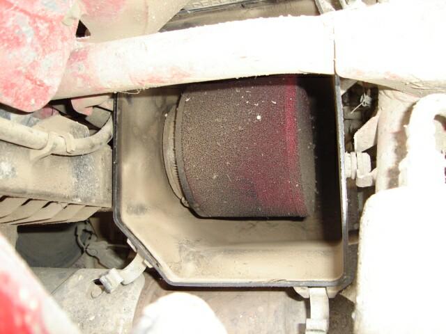

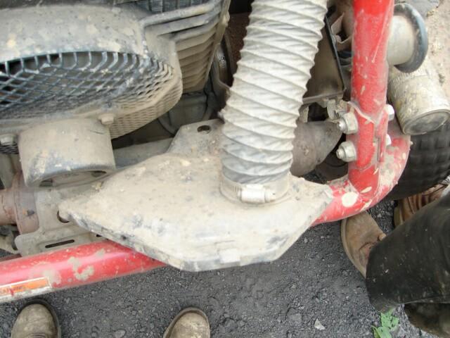

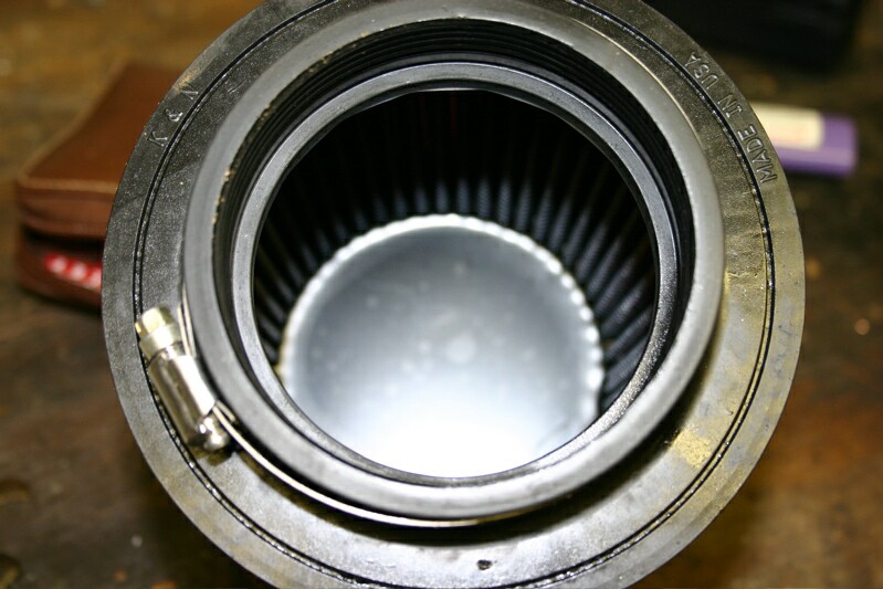

Took some pics of what it looks like iwth out any maintenance for a year +. But only three rides.
File comment: By the way. Most of this debri is from opening up the airbox lid. That paint is from me pressure washing her. And the twigs are well... the PA Ride. :)
File comment: upper prefilter
File comment: lower prefilter
File comment: The area I put the liquid electrical tape onto. Here you see I took it off.
File comment: trying to show you inside the filter.
File comment: its out of focus. sorry. however you can still see dirt streaks formed from dirty air flow depositing over time.

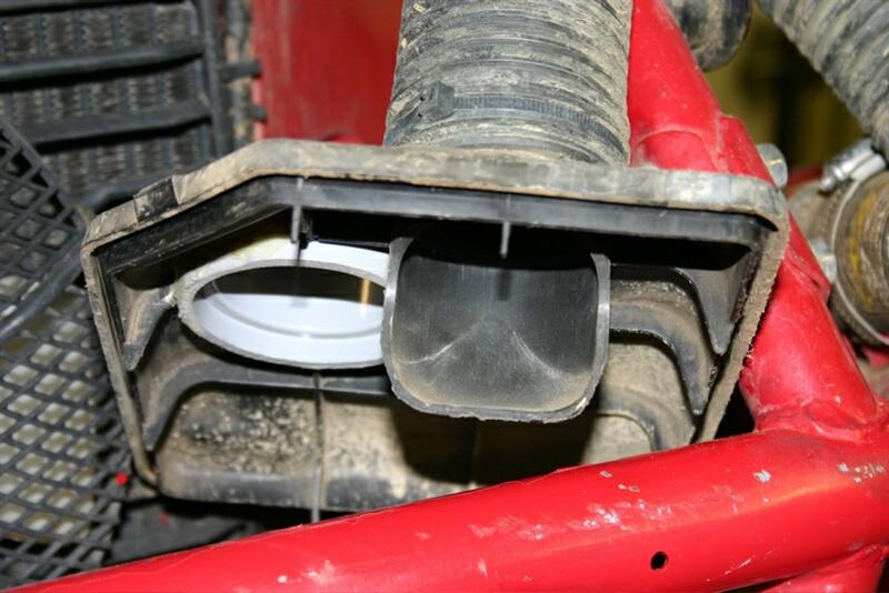

more

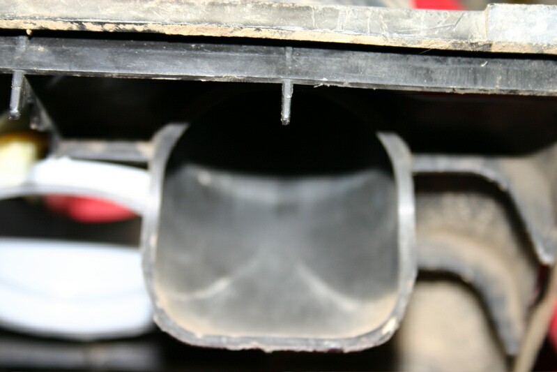

File comment: Or is it that I have a bad airbox Gasket? Both for sure.
File comment: On the inside of the box that the airbox leak is at.
