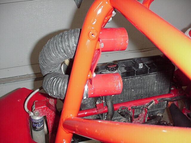

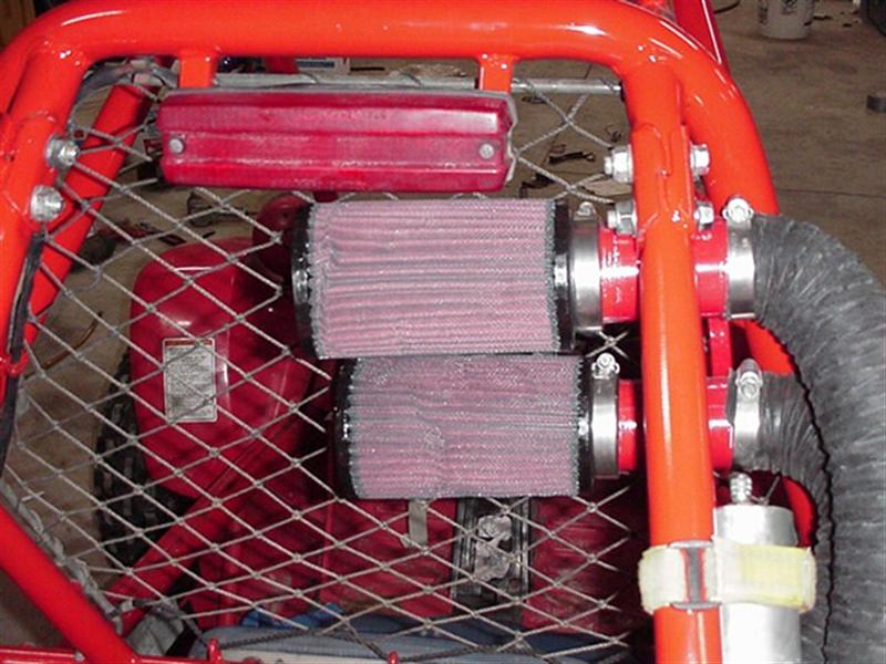

Another Prefilter upgrade, I want to eliminate the Prefilter box and switch to K&N filters
so I can eliminate the leakage I have been getting around the foam panel filter without
modifying the filter box and making it over complicated also using the K&N as a Prefilter
I can wash the filters wile on the road .
Using some 2" muffler tubing and a strap of metal I fashioned a filter mounting bracket.
Note on K&N filters learn the FACTS about these filters before using them on ANYTHING don't believe the MFG's claims they can claim anything to sell a product then YOUR stuck paying the bill when you find out different, don't take my word for it take the test yourself, I use them for prefilters ONLY and only because of the ease of cleaning, I can clean them on the fly in my RV or in the bathroom sink at a gas station, to properly clean my foam filters it requires solvents and more time than I want to spend on a ride trip, here is my findings on the K&N Filter Central ((The Dirty Truth)) page viewtopic.php?f=1&t=5491

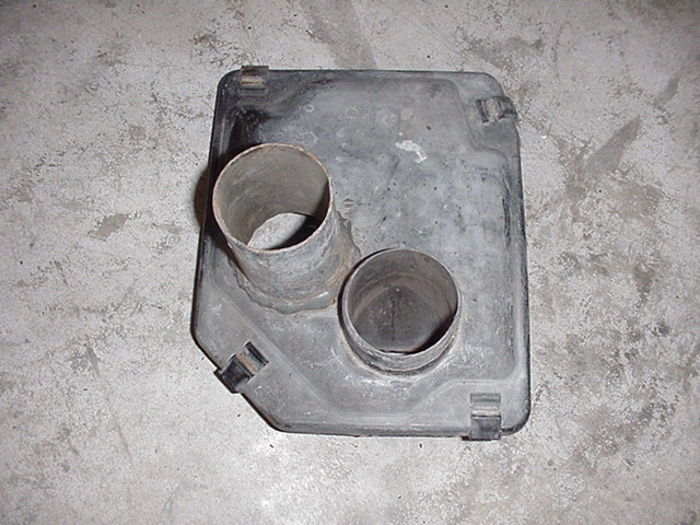

Modifying the lid to the air box is pretty simple using a hole saw and another piece of 2"muffler tubing, this picture gives you a good idea where to locate the second hole.
Update I have noticed many of the newer air box modification are cutting a single large hole in the air box then installing a single large air filter, while designs that vary from mine are fine and dandy I would like to point out the reasons why my design is like it is and has a proven track record under ALL operating conditions, read on
I use two filters and two holes for a reason, one is for fit and finish, two smaller tubes relocating the air intake to cleaner cooler air is easier than using one large tube, it also allows me to IMO properly position my prefilters where they can be the most effective, first lets discuss the dirt, NO filter is 100% that means it will pass dirt, as the filter loads up with dirt the dirt is beat, blown, sucked and bounced to the inside if the filter, what you don't want inside your filter gets their by mounting my prefilters horizontally like I do the dirt that has made it pass the prefilter falls to the bottom of the filter and little to none of this dirt works its way down the tube to the main filter in the air box.
Next look at my design what happens when your riding in the rain or caught in a downpour well with my design you keep riding water will not work its way into the air box it will run through the filter then drain out.
I jet my Pilot, set it and forget it, I ride from 0 feet to 6000' elevation , from 50 degrees to 85 degrees with the same jetting on colder drier days I will put a piece of duct tape on the inside of the air box blocking off one of the intake openings this changes my jetting from idle to WOT (Wide Open Throttle) enough where I don't have to go inside my carb and change jets and make needle adjustments.
Consider these when making your design choice.

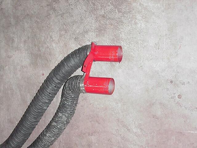

Once you drill the hole with a hole saw you slowly easily bend over about 1/4" of the
end of the muffler tubing then slide it up through the bottom of the new hole pop rivet
and then seal with silicone caulk.

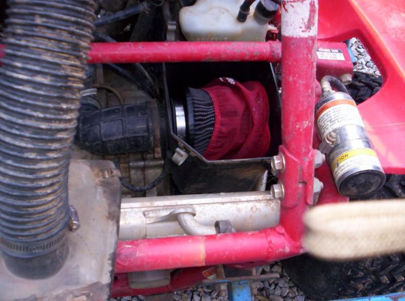

New filter mounting bracket for 2004

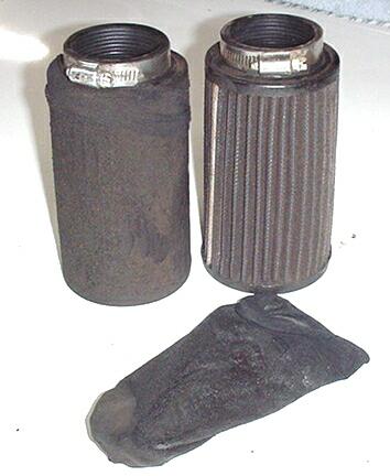

I decided to add some nylon stocking's over my K&N pre filters for the Florida ride (12-15-01)
after the pleats pretty much get full of dirt and mud at the Land Between The Lakes
ride earlier this fall, I picked the nylons over the pre chargers to keep the cost low, 1.97
for stockings that will make 8 disposable covers or 10.00 each for pre chargers that you
need to wash when you service the filters.

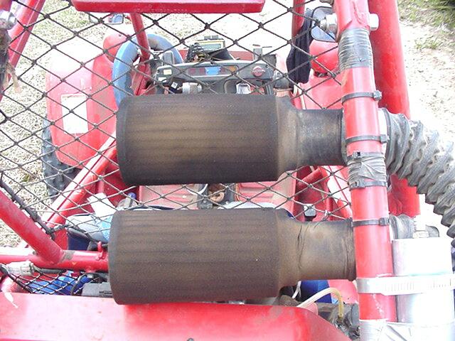

As you can see the forward side of the filters gets much dirtier that the back side.

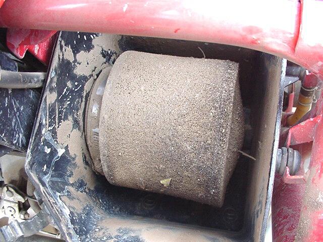

Here is what my main filter looked like after almost 3 days of eating dust near the Big Scrub
camp grounds, the filter is clean but keep in mind that this filter will still need serviced even if
it does not look dirty, the oil used to coat the filter in time will evaporate so for maximum protection
I recommend removing inspecting and oiling the filter from time to time.
