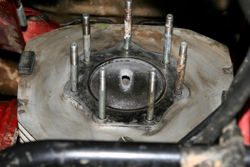

yay I broke my cherry.
This is obviously too lean but the hole is right in the center. This is a wiseco piston, are they known for that? I would have expected the hole to be near the exhaust port.

Looks like deto to me http://pilotodyssey.com/Fuel-Squish-Detonation.htm

thx hoser, I'll check those out. A few more things that make me lean towards it being lean,
1. cooler temps
2. higher elevation
3. I went from a 9 to 8 plug the week before
4. I have been in this motor (( Internal Combustion Engine ? )) many times and it always had a nice almost rich carbon cake on the piston, it seems to be gone now.
motor (( Internal Combustion Engine ? )) had 175 psi the week before, running fresh 93 octane. is that too much compression for 93 octane? its about the best gas I can get easily here.

Hey Sun,also look at your head studs Mate,they look stretched to me-overtorqued over time.
I would replace them,cheap insurance...Baz

Sorry to hear, but sooner or later it bites everyone. 175lbs is well above stock, what did you do to get that? I can't remember what you have done to your 350.
Cooler temps will give a slightly leaner condition, but higher elevations would actually richen the mix. You would have to have a fairly significant elevation change to make much of a difference.
I have run 9,8,and 7s in my 350s. I normally can't tell much difference according to my EGT, just less build-up on the piston dome and exhaust areas as they get hotter, but I run my machines well into the rich side of things(dark chocolate plug chops).
I have never holed the center of a piston. I have shattered them, scuffed them and siezed them many times in my early days learning jetting and before I started doing leakdown testing. Do you have any pics of your last check, I like to see the "wash" on a piston dome. That is another great way to check burn/jetting conditions other than plug chops.
Gary

I have a hillside honda head on that one, it upped the compression a bit. Its also why the studs are so long. Last I checked the piston it looked great. Nice thin carbon layer, and you could see the flow marks, perfectly symmetrical. May have a pic somewhere. Before this race the motor (( Internal Combustion Engine ? )) was running rich. It would foul plugs pretty quickly. every 90 min of run time or so. I never leak down tested this motor (( Internal Combustion Engine ? )), I bought it from a mechanic would had just rebuilt the entire thing. I pulled the head and the piston was new so I never went farther than that. I guess I really need an EGT.

175 psi is to high of compression for 91 octane. Make sure the squishband is correct for that bore. I would do a 50/50 mix of 110 or 112 leaded fuel, run an egt to help get you a safe tune and do a leak down test, just to be sure there are no gremlins hiding. And fatten it up 2 jet sizes.

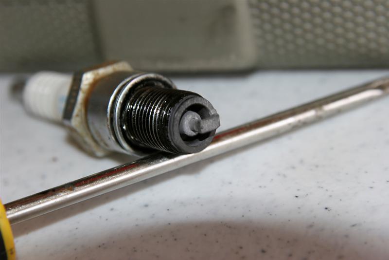

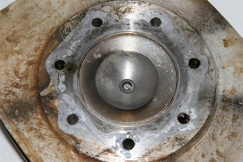

Here are pics of the dome and my plug, certainly looks overheated. Gonna order a new piston and check the squish. I can see debris down the exhaust port, hopefully when I get the jug off nothing major will have made it down into the bottom end.

Oh ya, that was very lean. I am sure temps past 1350 easy according to the plug.

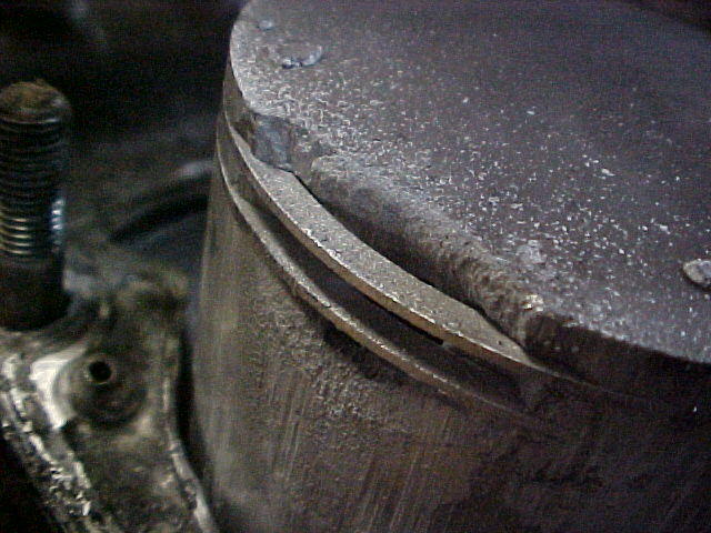

Here is a pic of my 420/350 melt down a couple of years back. I not sure if anything was in the bottom end, felt fine turning by hand. I could split the bottom end and clean each bearing by hand or try to flush it. I decided to pour some straight gas in the bottom end, spin the crap out of the crank, shake it around some, then poured it out onto an old towel with a couple of white paper towels on top to see if I could find any stuff in there. Tons of crap came out! It took several flushings to get it clean. After it was cleaned, I added a 50/50 oil/gas mix to relube the bearings.
Just something to consider. The metal particles are aluminium and should be a lot easier on the bearings than a bearing failure(steel particles), but I don't like the idea of any particles in there. It can't be good on the cyinder/piston walls.

Would do me a big favor. Take that plug and cut the threads off and measure the smoke ring or lack of. This may conferm a thought. I take it the plug is the 8 was it used or new ?
