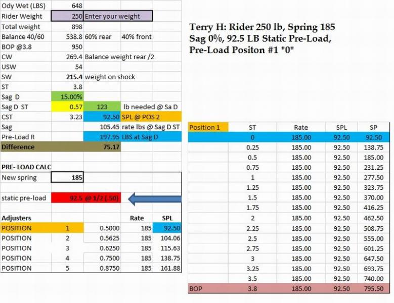

Good morning all. What I did is make up two different models of the chart to compare Terry H set up using the 185 spring. The first is his spacer which adds 92.5 lbs of static pre load to the shock and the second with a spacer thickness supping zero static pre-load.
I added a line of reference “Difference”. What this means is the amount of force require starting the shock compression. This additional force is required to overcome the spring force applied to the shock.
Important item here for math to be relevant would be corner weight and balance %. Once Terry has assembled the machine He can simply get those numbers easily. He first fills all the fluids and places a bath scale under the rear tire. Logs that number and then puts on whatever gear he wears and does it again, then places the scale under one of the front tires. This confirms the balance and corner weight numbers
Rear Corner weight no rider__________________________
Rear Corner weight rider and gear _____________________
Front Corner weight rider and gear_____________________
Now we look at the effects on the shock. Has the shaft moved under the weight of the machine wet (full of fluid) and has it moved under weight of machine with Rider and Gear.
Spring stake Static___________________
Spring stack Wet_____________________
Spring stack Wet, Rider and Gear______________________
Now we can take this information and compare to see if the chart works, need refined or just plain junk.
No matter what it will provide very important information to use as a guide.
Adnoh

Thanks adnoh! I am just short of clueless on how to read and apply all these values but I assume that position 3 is the best?
 Post subject: Re: Rear springs...
PostPosted: Sun Mar 24, 2019 10:02 pm
It seems straight foreword to me.
In that first chart he shows you have some kind of spacer that you made that adds static pre-load to the shock. The key here is in the top left of that chart - the green numbers. You want 15% sag and you need 123lbs to get it. Now you look at the "Position 1" chart. You add the SPL number and the SP number together and it must be 123lbs. If it's not then you got no sag. Obviously in that first chart you got no sag.
In that second chart you do the same thing. You see that if you use no spacer that adds pre-load you get a lot closer to that 123lbs needed for some sag. You see that in blue in the "Position 3" chart. You add those two numbers again. You are around 139lbs instead of 123lbs so you got a bit less than the 15% sag we were shooting for if you don't make a spacer that adds pre-load.
I was asking adnoh for 15% sag instead of the 30% most machines run because our oddys have a pathetic amount of travel to begin with and we have a bump snubber which takes up even more of our pathetic shock travel. I plan on cutting my snubbers in half and in fact I have already done this on one of my machines (my personal machine).
I am a bit lost on that BOP (bottom out percentage) number.
Adnoh shoots for just over 500 lbs but yours is through the roof at over 700 lbs. I am not sure what this means at the end of the day though because your a bit fluffier than I am and that puts a lot more load on everything.

Terry H, if you would like I can do my best to explian the numbers and how they relate. It would be good to know if you want. It will also help understand some of my babble.
If others want I can post here or in new thread. Terry's choice
CO, BOP is basically the spring force compressed at a given distance. Take the shaft laenght times the rate plus any static pre load. What I look at is the wheel rate for a given sprung weight. This is a better gauge of where you need to be. Trying to keep it simple so I am using the springs rate for chart. This is why I have to determine a corner,unsprung to get a sprung weight. The weight the shock supports.

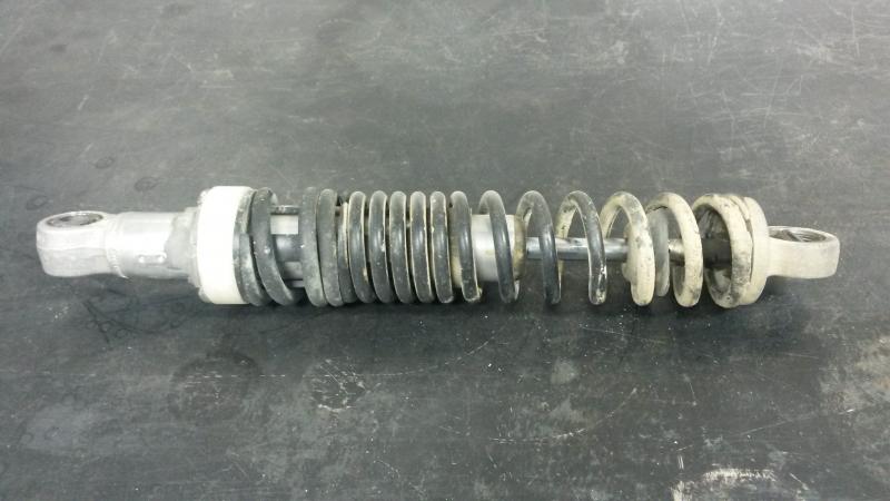

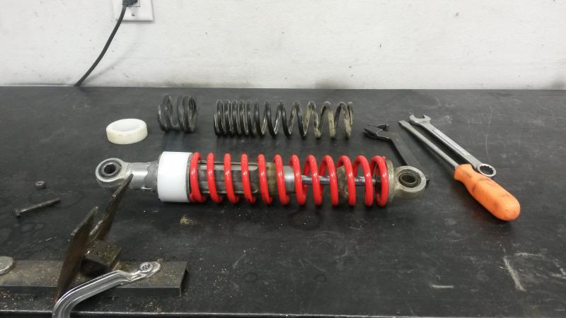

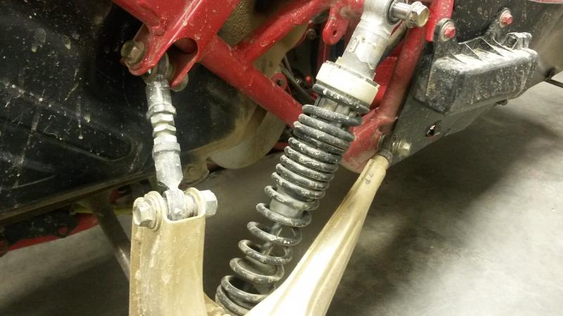

I installed the springs tonight.
It will be a week probably before I can even think about a ride and a ride report.
In the pics you will see my old set up.
I did not tell anyone or post about this set up, but a couple of members knew.
What I did was use stock FRONT springs and then cut the old rear springs to make up the difference in length. It worked very well believe it or not. My brothers machine came with #130 springs when I bought it and this set up felt very similar to those. It was way better than NO rear suspension with the original stock rear springs that the oddy has. I ran this set up on two machines. The death machine still has this. If these new Eibach springs work out then I will buy another set and install on the death machine.
Adnoh: According to your spring chart I needed #140 springs set in the #3 position.
I could not get #140's from Eibach so I got #145's. I set them in the #1 position.
Will report here when I can.
CO

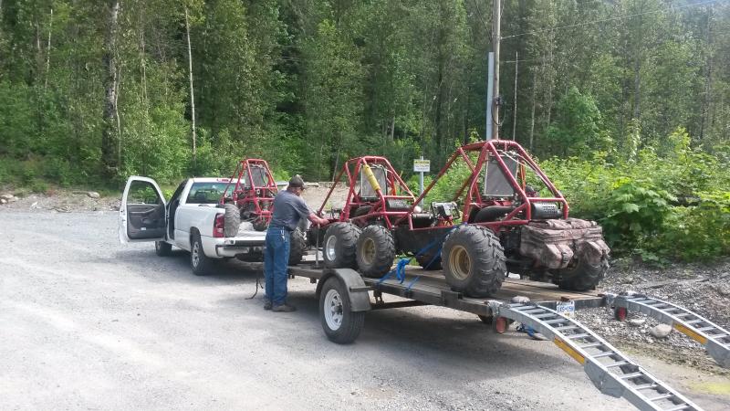

Well we went on a short 2 hr ride today (without my brother who hasn't been out in 2yrs).
The death machine with the homemade head and welded piston wouldn't run right as soon as it came off the trailer. It's still that fuel issue and apparently it's not fixed yet. We left the beer poacher behind at the truck. His son in law and I took off. The kid was running my brother machine -- it ran fine. I was in mine with the new springs. It also ran fine.
Now a ride report on the springs:
I am 135 lbs and running the #145's in the first position at the start of the ride.
They seemed a bit soft as I bottomed out a few times but man what a difference. I didn't even feel the bumps and it was a totally different machine. I now understand the reason for sag.
I stopped and went to the max preload setting. It was now a stiffer machine to me but I only bottomed out once.
Keep in mind that I run on logging roads and they are rough to say the least. Boulders, sticks and unseen washouts that jump out of no where.
So from what I can gleen from this ride is that the #145's for a 135 lb guy would be awesome for a good road but you have to run a stiffer set up on the rough stuff. I did not try to jump the oddy. I never do this anyways. I don't think a guy can jump this set up as it would be to soft in my opinion. Handling was great on the smooth sections of this logging road with the soft initial set up.
All in all I am happy with these springs and I have some adjustment.
