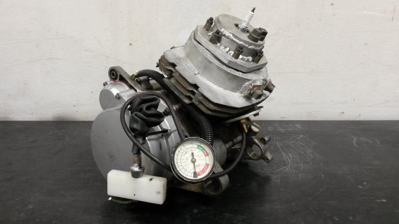

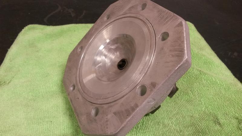

Pics of the semi finished head

PostPosted: Tue Dec 18, 2018 8:52 pm

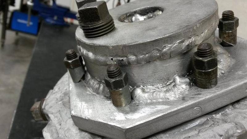

Just finished the pressure test.
OH GOD this is bad right now LOL.
This is what I was worried about and commented on earlier in this post.
I only got two small pin holes in the weld on the cap (very easy fix) but the entire base is leaking all the way around. I welded this on the inside on purpose because I needed the outside clean and clear of weld for the head nuts.
Looks like I will be force to weld it on the outside.
Die grinder/re-weld, die grinder/re-weld, die grinder/re-weld until I get it right LOL.

It's difficult to get an air tight weld, on the first pass, on aluminum, with a mig. Preheated and tig would probably better the odds. The welds could be made a lot smaller that way too.
I would love to own a tig machine but there is no way in hell I am going to pay that kind of money.
I don't own a plasma cutter for this reason as well.
rmesser wrote:
What if you were to use a bolt with copper spaces, like a thick washer in each hole so the weld would not affect the bolt head area. Am I making any sense?
Yeah you are making sense.
But the problem is not the bolt hole itself, it is the clearance needed for the bolt head.
Any welding on the outside severely cramps this clearance issue. Two of these bolt heads actually just touch the outer ring right now but there is clearance to turn them. Any welding screws this.
I guess I should clarify this a bit better. When I say bolt head I actually mean nut because I am using the Honda studs on the head.

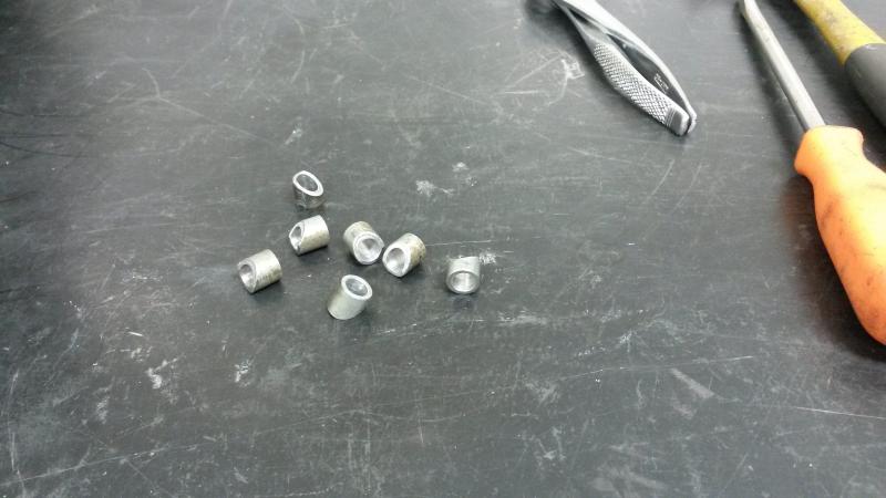

PostPosted: Fri Dec 28, 2018 2:09 am

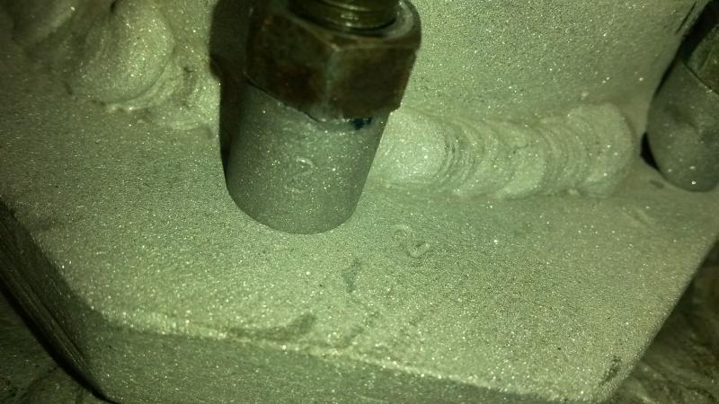

Picking away at it.
Had to make some custom washers because after the welding was done, there was no way the nuts would clear.
Now I have run into another issue. I forgot to drill/tap a hole for the temp sensor in the head. FFFF. Now I have to pull the head again ----------- for about the 100th time.

PostPosted: Fri Dec 28, 2018 10:44 am
Are you going to weld those spacers in place? You will almost have to, so you get proper torque.
PostPosted: Fri Dec 28, 2018 2:10 pm
It's tough to weld steel to aluminum -- :-) .
Nah good enough.
Besides I am running an O-ring so once it reaches crush you don't need more. Even though it will be a point force, it will still be a force on the plate. I will slightly over torque it a bit and have thought about it. Also when ever I torque down one of the heads on my machines, I also use the blue non permanent Loctite because on all the other heads the bolts are inside the water jacket. You can't get at them unless you drain the system.
PostPosted: Fri Dec 28, 2018 4:13 pm
Ok - why not just make them from aluminum and weld? Oh hell don't answer - you know what you are doing.
PostPosted: Fri Dec 28, 2018 4:41 pm
I thought about that after you mentioned it but I don't have any aluminum round stock that small around here at the moment. But most important is that I am afraid to weld on this head again. I had a hell of a time sealing the leaks and if I weld on some aluminum spacers I might end up with a leak somewhere in behind one of these spacers. I know what you are after but unless you were standing in my shop last night watching, it wouldn't do justice to the leaks issue.
I have to work with what I got and hope it all works out.

My first thought is you are not getting a full even contact patch under the spacer since it's angled. I went through a similar issue when I built my exhaust manifold. Looks awesome.

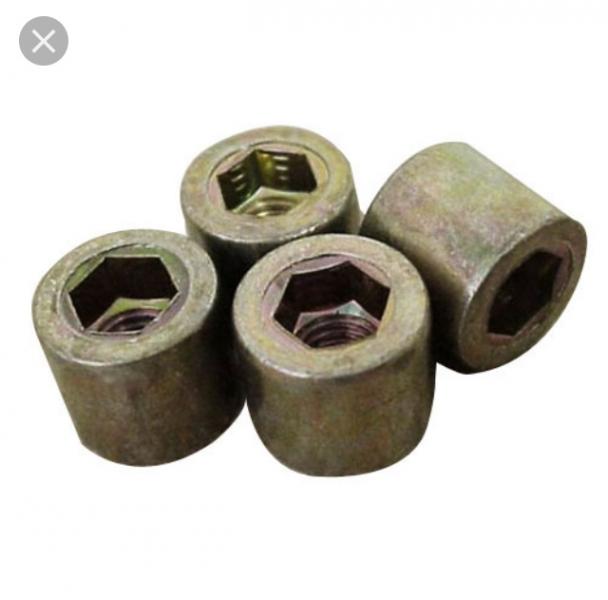

Could you not grind down the weld so that the nut fits better? And i would suggest an allen nut (like this) in replace of the head nuts
An allen nut is skinnier and would give you more clearance because you do not have to fit a wrech on it.

I've made spacers exactly like that in the past. The only problem I had was the studs bent when I torqued them down, this made it difficult to get it apart when needed. It was on a home made brake.
PostPosted: Sat Dec 29, 2018 6:52 pm
It seems I may be missing something because several of you don't like this idea. So re-examining this issue I think I will file down these spacers so that they hit the weld area and the base plate at the back of this spacer. Some of these spacers actually do that right now. Looking at the one photo posted, it looks like I can get away with one or two non angle cut spacers as well. Going out to the shop now to work on this project.
PostPosted: Sat Dec 29, 2018 9:44 pm
Posts: 848
Location: Palm Coast Florida
I aint knocking it. My studs were smaller than what you're using, and I cranked them down probably tighter than what you need to do.
PostPosted: Sat Dec 29, 2018 11:17 pm
Joined: Wed Nov 15, 2017 1:38 am
Posts: 56
Oh ok that makes sense I wasn’t getting it at first. That is a good fix though

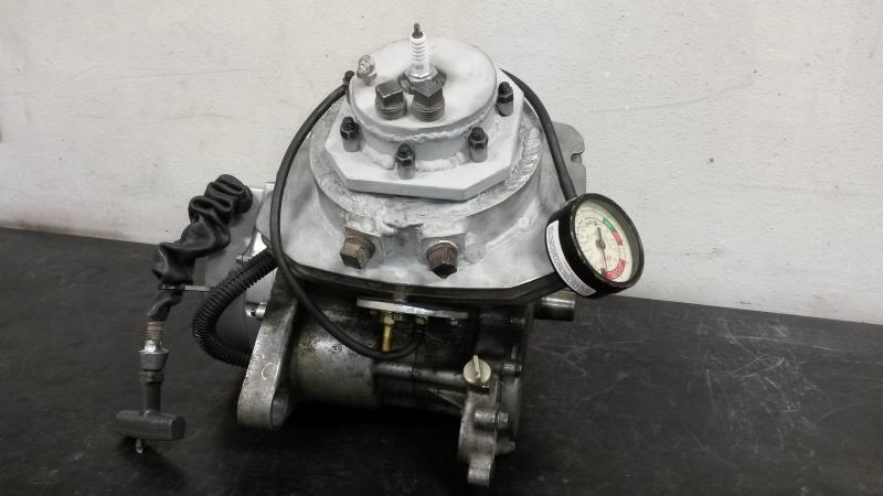

PostPosted: Mon Dec 31, 2018 2:02 am
Ok -- Engine is together now.
Will pressure test this Engine tomorrow when the silicone and blue Loctite is dry.
I put a ring of red silicone next to the O-ring in case the O-ring fails. Probably wouldn't help but it is worth a try. Put blue Loctite on the head nuts.
Numbered all custom made spacers so that they get put in the correct spot.
Replaced the homemade "T" handle on the pull start.
If this thing passes the pressure test I will start the installation. When complete will fire it up in the driveway and heat cycle it. No riding around here this time of the year as there is snow in the hills and it is raining like hell here the last few days. Today was nice -- the sun came out for 2 hrs, then fell behind a hill.
