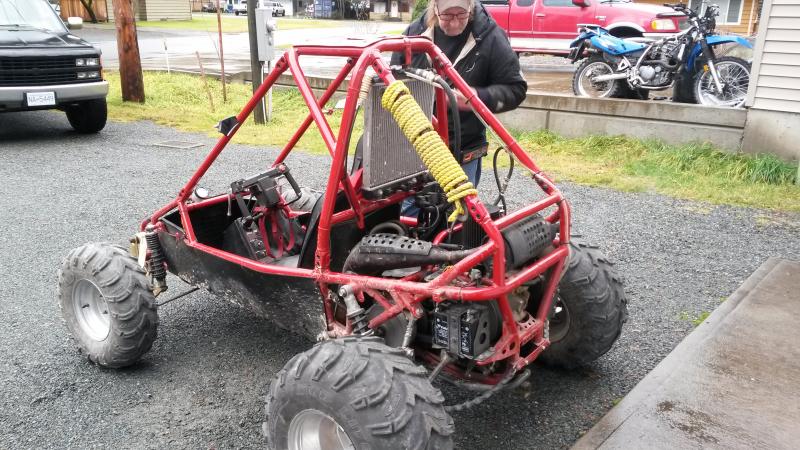

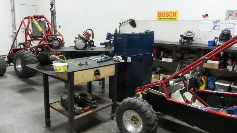

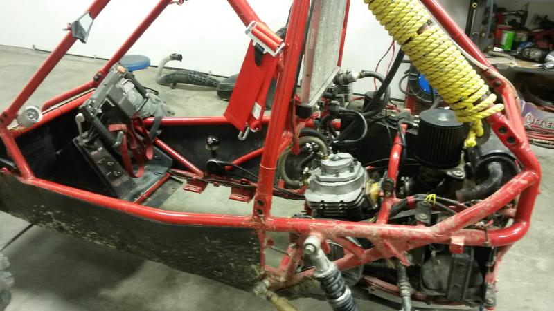

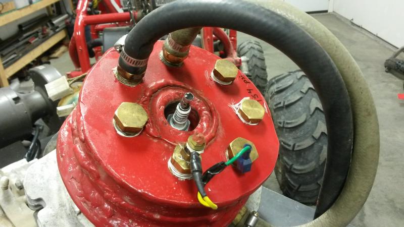

Well I yanked the red Engine out of the death machine and its a good thing.
It had very little counter balancer oil -- wtf -- I know it was full. The little bit that was in there was clean so I doubt the seal was leaking. Will have to do a pressure test on this thing to be sure. No leaks on the outside of the Engine. Also if you look close at one of the pics you can see that the sparkplug lead was broken and when I pulled it off the plug, the metal bit stayed on the plug. I don't even know how this thing ran and go home on the last trip. My buddy said it was running fine ??
My homemade Engine mounts seem to pass the test. They look good. Even though it has only been out a couple of times I am calling it a success. Homemade intake on this one as well and it passes.
Will try to install the R401 Engine tomorrow but will have to take mom to the heart specialist on Thursday. It may be the weekend before I spark it up.

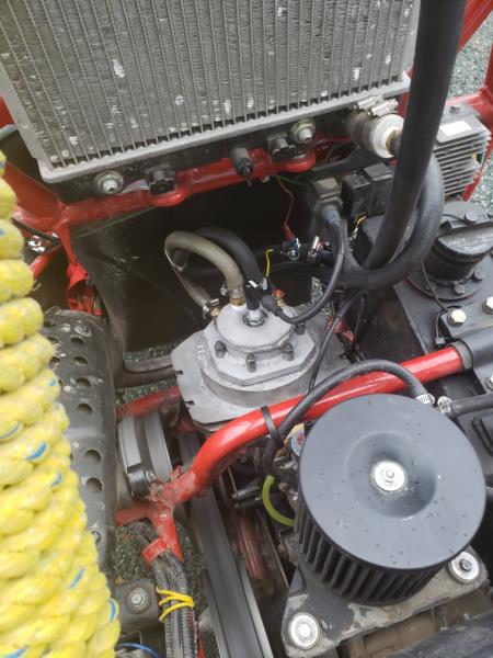

PostPosted: Thu Jan 03, 2019 4:04 am
Well it's in there :-) .
Just have to hook up the new temp gauge and start it up.
It will be started on Friday because I am busy Thursday.
I will warm it up and if it is not raining, run it around the block :-) .

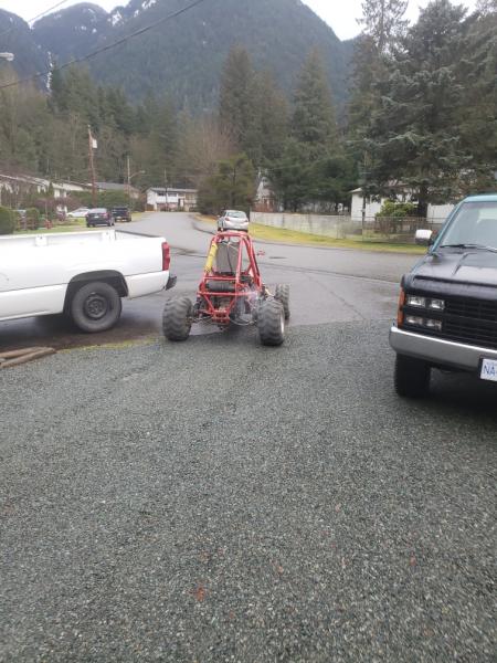

PostPosted: Fri Jan 04, 2019 5:12 pm
https://www.youtube.com/watch?v=3zhqCccFsGc
I'm shocked.
This thing is strong for something that has a welded piston, used rings and a homemade head.
It spins the wheels on pavement. You can pull a nut on the street no problem.
Found two small issues. I have a microscopic leak under one of the fittings on the cylinder so I will have to weld that up. Also when giving it full throttle sometimes it misses but I think this is a carb issue.
The bottom end is real strong and the head stays cool. I think I may have stumbled upon a good thing by making the head this small with a small water jacket. The water will flow through quick so it is constantly getting a fresh supply of cooling water. Just a theory. Hard to be 100% sure because it is winter here so its not hot outside.

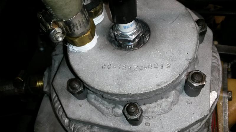

Ok I got the CO [Screen name] and the 18[year] and the 001 x[first experimental] but what is the significance of the 30? Is it cc's?
PostPosted: Mon Jan 07, 2019 12:56 pm
Holy crap you're good.
Yup 30 is the cc's.

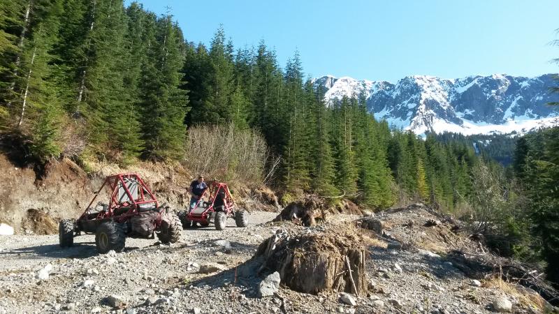

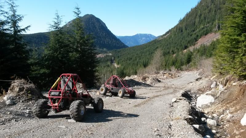

Update:
Went for a short ride up Hunter creek today.
Dozen of washouts to drive through because of the snow melt and little creeks running across the road.
Had an issue with fuel supply. Filter to small and has crap in it. I consider this a complete success as far as I am concerned because it didn't blow up and ran well until the fuel thing. Yes you can weld a badly damaged piston, run used rings and make your own cylinder head successfully.
I close this thread and call it a success.
