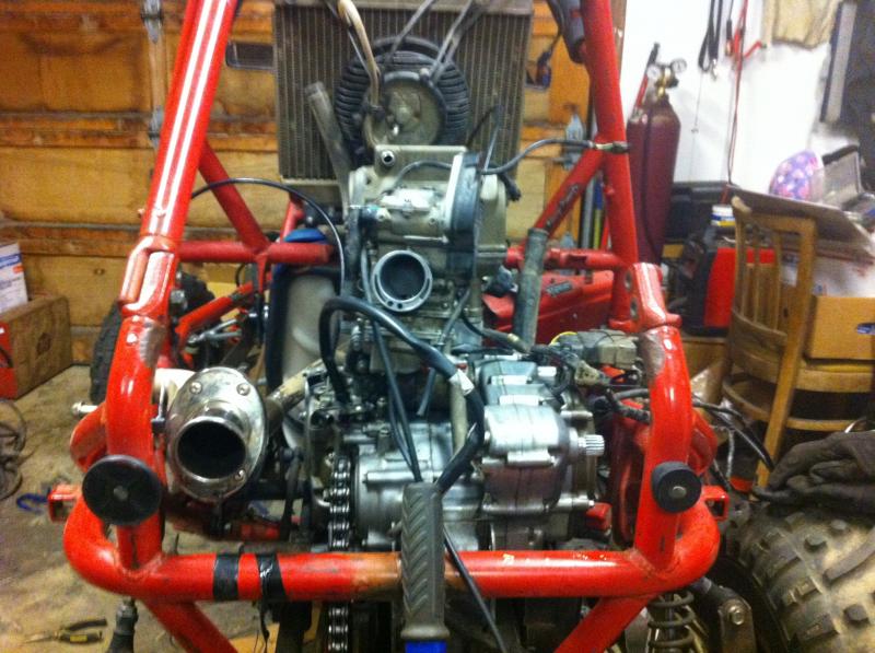

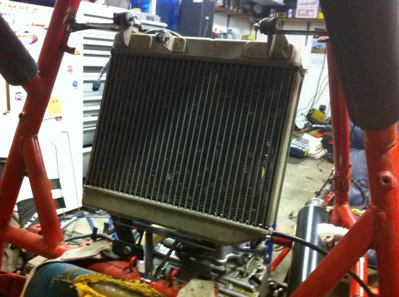

Got more done on this project tonight. Got the exhaust done and rad mounted and shifter done. Also got the clutch and throttle cables to hook up and work. However the throttle cable is very sticky. Is there some kind of cable lube that you can try and spray in them.

I have seen people make trays to lay the cable out in and let them soak in gasoline to dissolve grit and dirt, then let hang dry and add your favorite lube (KY, Astroglide...LOL) most people either use WD-40 or PB Blaster or something like that. Let it hang and soak all the way down the cable.

i was talking to a buddy and he suggested fluid film..it pretty good stuff, that cable moves but i has been sitting for a while iknow that. the spring in the carb is just not strong enough to pull it back right now. i will try cleaning it and grease it and see what happens

i use this stuff. It works good. and that neat little tool alows you to inject the fuid through the cable.
http://www.rockymountainatvmc.com/p/43/ ... Cable-Lube
 Post subject: Re: fl450r
PostPosted: Tue Mar 05, 2013 7:18 pm
Try a motion Pro Cable lubing tool.
Or....do an internet search and you will see there are a couple of places that sell these.
Here is how its used.
http://www.youtube.com/watch?v=NG6JO9f0Q6U" ."..

There is a liquid graphite stuff the Harley shop uses, but I don't remember the name -- have to ask my buddy. It was like $10/bottle but it was better than any "liquid" cable lubricant out there. And it would spread/soak over the cable fibers like CRAZY as soon as you applied it, and it would eventually spread over the whole cable. Crazy stuff.

This is the stuff...
http://www.jcwhitney.com/film-lubricants-dri-slide/p2017157.jcwx
Coil it up lay in the bottom of a bucket of gas.
Put a rubber hose over the end like 3/8 hose clamp it on blow out cable with compressed air, pour solvent in the hose force it through with compressed air.
Buy and use the cable lube, you can hang it up and spray it in the rubber hose let gravity work on it over night.

so currently i have rad mounted behind my head but i was wondering on your opinions of mounting it on the side of the oddy in this area. it would be nice to have the area behind the seat for my gas tank, as this Engine was gravity feed.
