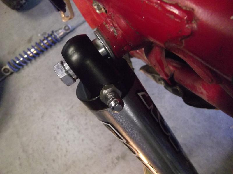

I almost got these mounted last night but I purchased a mounting bolt that is too long so back to the hardware store I go.
As mentioned before, the lower mount requires the Works lower shock mounting kit. The upper mount requires something to take up the space in the mounting hole due to the .100" difference in diameter. The shocks also come with 4, half inch spacers to allow both upper and lower Heim joints to have plenty of rotation.
This weekend, I will finish the mounting. Hopefully, I will be able to go take her out for a quick test ride. I have the strange suspicion the nitrogen charge will need to be bumped up a little from the base line of 200psi.
Also with the top Heim, this should allow for a little more swing in the shock should a U joint break possibly saving the shock from severe damage.

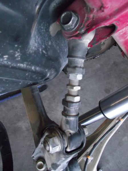

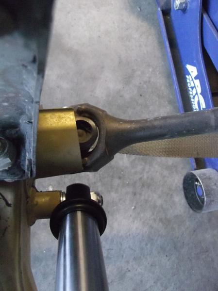

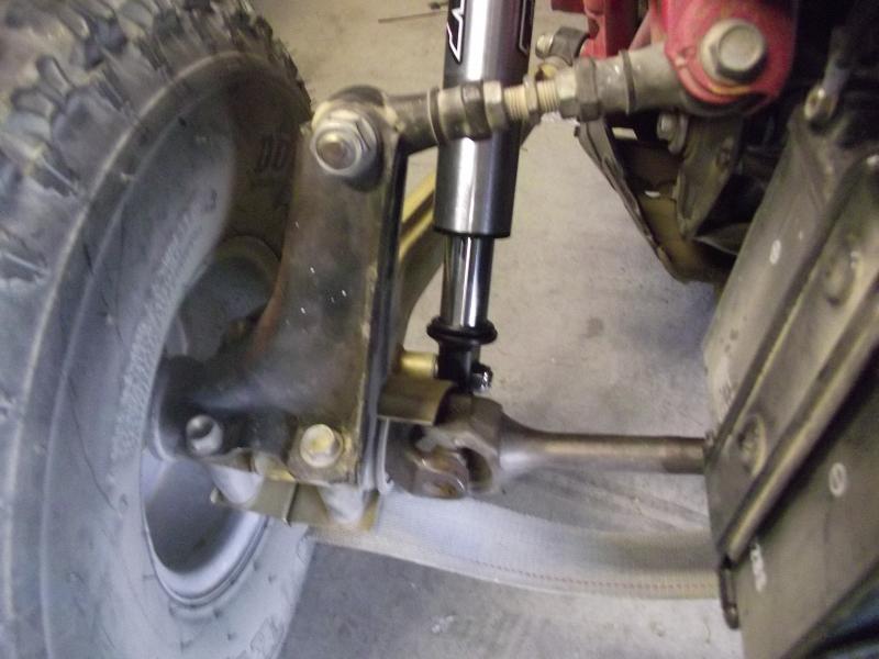

Well I got the shocks mounted and there is great news and not so great news.
1st the great news.....these shocks are 15.29 eye to eye so no modifications for mounting and no U joint binding.
The not so great news is that at 200 psi out of the box, they do not have enough of a charge. The stock charge is 200psi. These will need to be bumped up to at least 300psi.
When I step down on the back of the Ody I can compress the shocks all the way down to their stops. When Released the shocks only travel back to about 3/4 travel.
File comment: U joint gap at zero camber and full shock extension. Probably .020" clearance.

File comment: Shock at Full extension
File comment: Shock after compression not fully rebounding on its own.
File comment: Upper mount view

so what did you use on the top bolt to make up the difference
PostPosted: Sun Nov 10, 2013 2:05 am
A piece of copper tubing.
