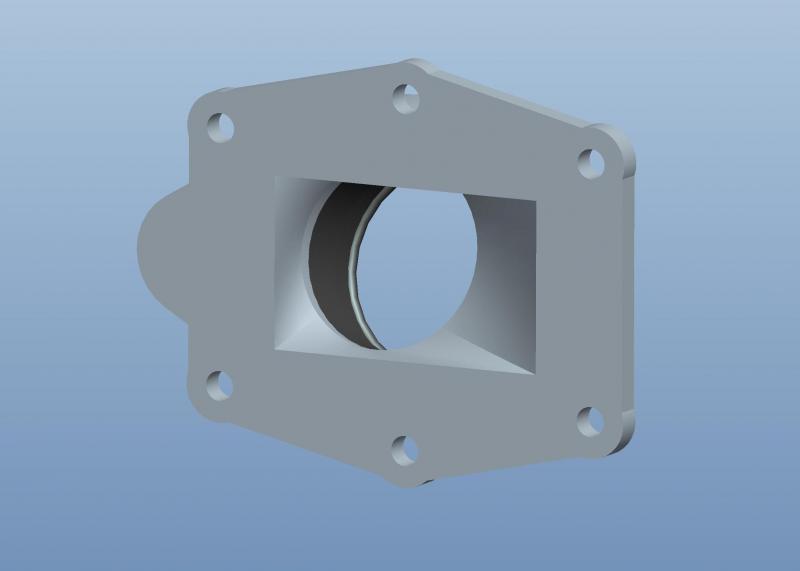

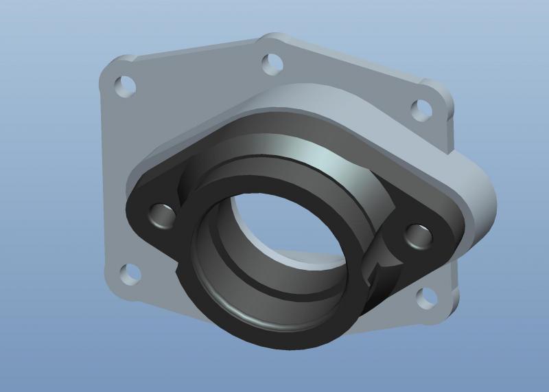

This outta' do it. There's nothing on the mag side of the intake that would prevent extending the intake plate over a tad to make room for the boot flange.
Here's the 3D printed version...(since this IS a 3D printing thread topic, lol)...
