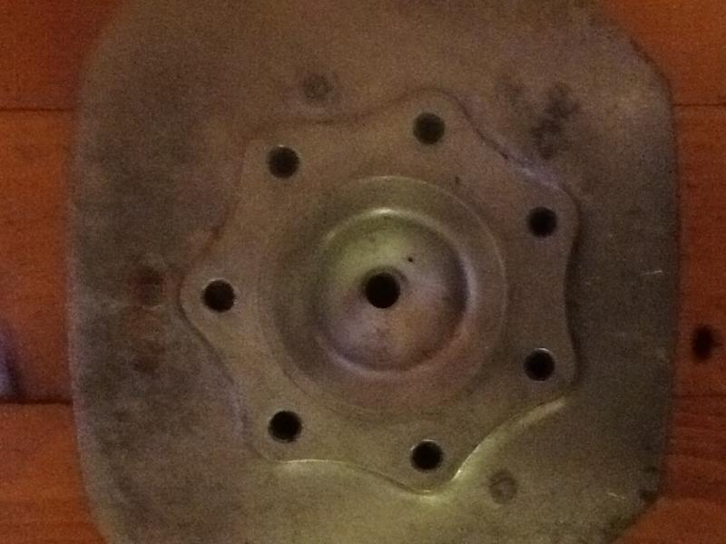

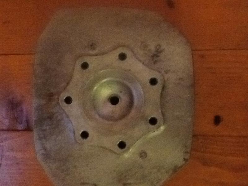

Any pics of the head wonder if it has been machined in the past?

I'll take the top off and take some pic but I don't think it was machined but I could be wrong .

Sorry it took so long to get back I was not able to move around to good yesterday a little better today . You had me thinking all day if the piston was in wright so I checked today and yes it's in the wright way .the ring gab is .012 .and I don't think the head was machined. And thank you for your kind words it lets me know what I was fighting for and what I gave up to be there .

At this point I don't have anything left to offer. You have covered it all.
My suggestion is put one layer of the stock head gasket on and run it as is.
I had an Engine with 90psi and it ran.
