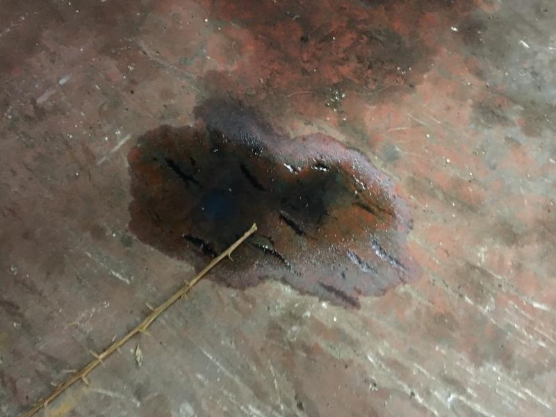

Here is how she sits assembled and the fuel puddle which is caused from excess fuel only when running and splashing back from carb.
It's not a leak in the lines which is what some might say. airbox side of carb even before motor (( Internal Combustion Engine ? )) swap has been covered with fuel and oil and always had top end bog.
Thinking higher compression new motor (( Internal Combustion Engine ? )) made it more noticeable!

PostPosted: Fri Apr 01, 2016 8:14 am
Joined: Sat Jul 11, 2015 8:04 pm
Posts: 122
Appears that your float valve isnt seating right...i would get a new one..you have to get a re uild kit for a honda atc because that's the only way i could find one when i was looking for one. I would remedy that problem before you try different jetting
