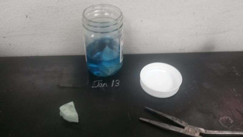

Just removed a piece of that rubber that I put into the Avgas/oil mix. It has been 24hrs now.
Happy to report that there was NO degradation of the material. Two pieces still left in the jar. Will remove them in about a week or so to check for degradation, but this first test seems to tell a lot.

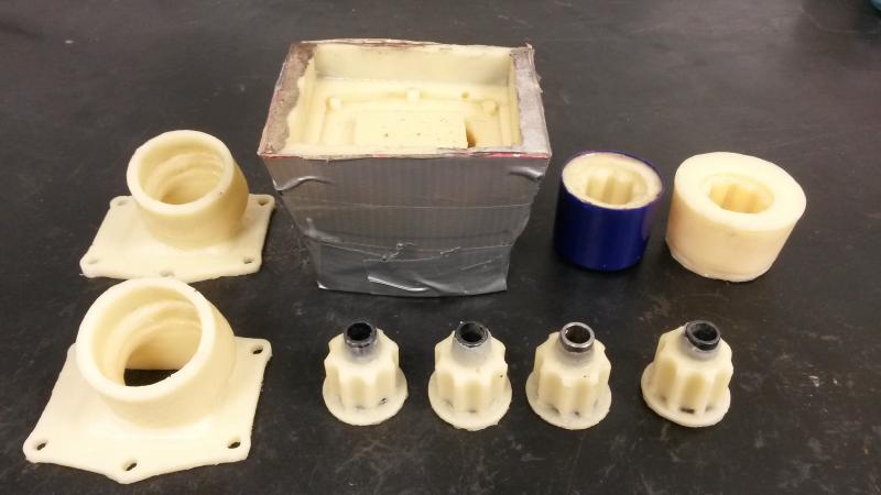

PostPosted: Sun Jan 15, 2017 9:25 pm

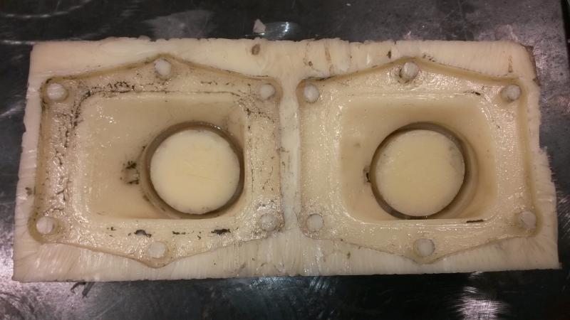

Well I have made a few parts now so I think I will let it rest for a while. If you look at the pic below you can still see some inclusions in the Engine mounts. It seems to me that when I build these I will have to rotate the metal insert around a couple of times to let any trapped air bubbles escape. At least that's what I think is happening. The intakes look good and I still may make a mold for the stock one. The reason is that I think I can get my 38 to squeeze into it since the rubber is flexible. For now I am going to move on to another project. I have many. Want to build a unit to attach to any semi auto weapon that turns it into a Gatling gun WITHOUT modifying the gun. Also want to build a few more guerilla guns so that I can bury them in the bush when we go riding, that way you only get caught with ammo. Also need to rebuild the death machine (the one that broke my back),repair the shocks on my brothers machine and install one of the new intakes I built on my machine. I love this laid off from work stuff. Man I could get a lot built if I was retired but I almost need help LOL. Not sure if we are going to the world series of poker in Las Vegas this year but we did talk about it. Damn shitty dollar.

a proper mold release would probably be better that vaseline, and if your worried about air bubbles, just build a small vacuum chamber to put them in right after you pour it..it will suck all the bubbles out....other than that looks great..

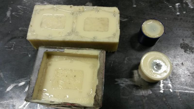

Well I know that I said I wasn't going to make a stock intake mold but I did. The reason is that I want to see if my 38 will fit into the stock manifold since the rubber is more flexible than the stock rubber. My feeling is that the stock units got hard after 30yrs. Also wanted to check to see if I could make a better Engine mount. Just poured it a few minutes ago. Need to wait until tomorrow to pull them.

Single guy... Cold long winter up north, between jobs. Why mold at all? Make blocks and wittle away. :shock: :-)
Looking very good indeed.

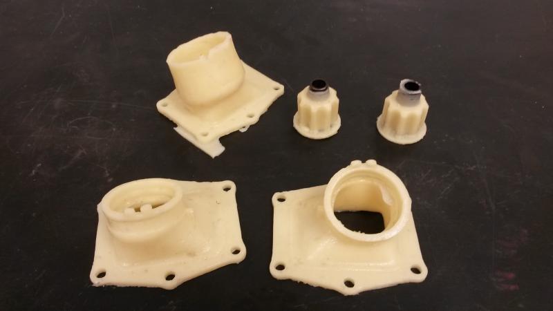

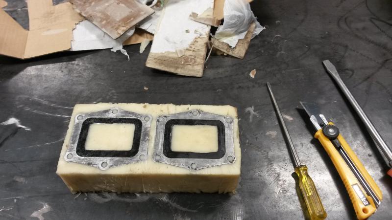

Well I just pulled the stock intake molds. They look awesome to me. In the pic you can see that the intakes require a small amount of trimming with scissors, but they look good. On a side note I did mention earlier that this rubber is very tough and hard to puncture. Well I did poke a hole in one of them when I was removing it from the mold. I was getting real rammy with the screwdriver and it went through (one with the over size end for the after market carb). The stock units have a ridge that fits into the groove on the stock carb to hold it in place. I may have to die grinder this off to get it to seat properly on my TM38.

If you can poke a hole in these with a screw driver are you sure they will hold up to the vibration of a 2 stroke FL350 Engine?
 Post subject: Re: Mold making
PostPosted: Wed Jan 18, 2017 7:53 pm
Trust me, I really had to work at it to poke that hole in it. It's a large screwdriver and I was working on it. I feel confident they will hold up. We are going to find out this summer aren't we ??

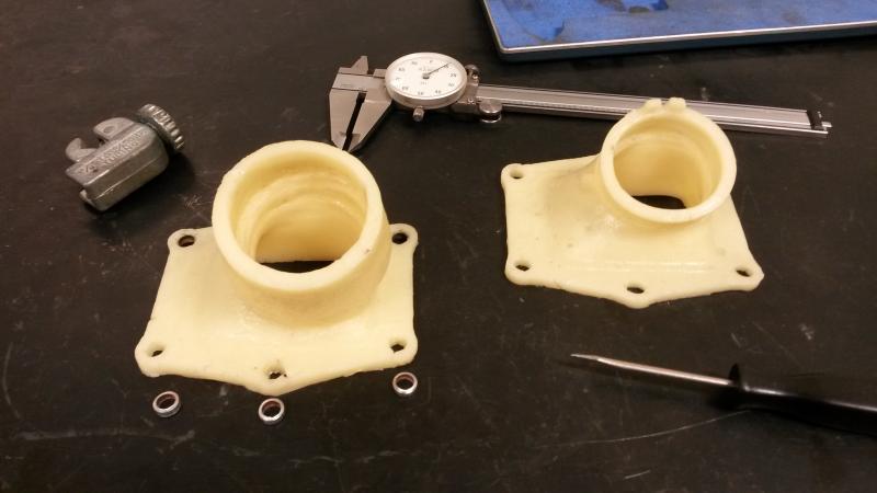

Have decided to use rmesser's idea and use a crush spacer/sleeve in the holes in the rubber intake.
I cut them from a piece of metal brake line. It will allow for 50% crush. Not sure yet but I don't think this stuff compresses well, it's tough. I tried to squeeze it with my fingers and it don't compress much. May be with bolts and the added power associated with that it may compress. Also have decided to go with the larger modified intake because the hole is larger and will allow the Engine to breathe. I will still try to see if the TM38 fits into the stock units.

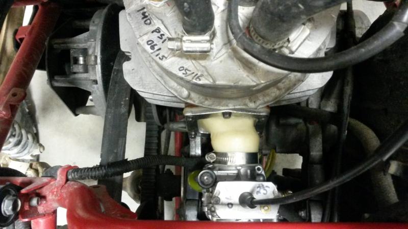

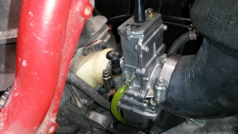

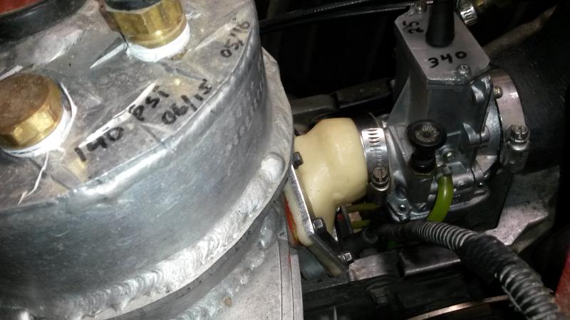

Well the new intake is installed.
Not sure what to think. The TM38 will fit into the stock size intake I made, but it tries to "spit it out" which is why I went with the larger opening intake. After installation I did notice that it is very flexible. Only when I mounted the bracket for the air filter did everything seem to firm up. As I see it now there is lots of isolation for the carb. All I can think of is that the original Honda intakes were made of a much harder durometer. When I had this carb mounted with the all aluminum intake and a radiator hose it was very stiff. A radiator hose has webbing in the rubber which is why it is so firm, even though it is the same durometer as the stuff I used to make these intakes. The only real test will be next spring when we get out for our first ride. Lots of snow in the hills here so I don't see us getting out until June for any of the high rides, and even then I think the roads will be badly damaged from the run off.
On a side note here, without question in my opinion this stuff is good for making the Engine mounts. So if I failed on the intakes then at least the Engine mounts are good. Time will tell.

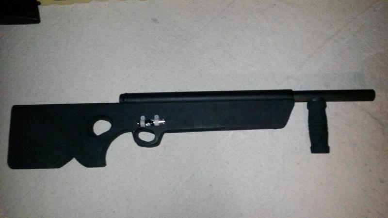

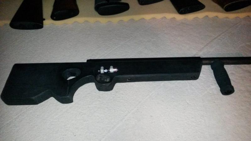

4) How about some more details on your gun projects?
Below are some pics of what I call a guerilla gun. You can make it for less than twenty bucks. It's a 12 gauge slam fire and it is made with two pieces of pipe and a 2x4 board. It has a laser sight that you get at the dollar store. You make these and put them in a sewer pipe and bury it in the bush somewhere. Then you don't have to pack a gun around with you all the time. With regards to the full auto conversion, I don't really want to comment yet. It's a very very very simple concept and if you think about it and are mechanically inclined you can figure it out. It uses an 9v electric-motor (( Internal Combustion Engine ? )). Not sure if I can find a motor (( Internal Combustion Engine ? )) strong enough for the purpose though.

Well it has been a week now since I tested the rubber in the Avgas/oil mix.
I removed a piece from the jar and the rubber passes the test. There was no degradation of the material. I see no reason at this point to continue. As far as I am concerned this test is over.
This whole thing was just a proof of concept anyways. I will not be installing the Engine mounts because I don't feel like tearing my machine apart just to install them for a "test". I know they will pass. As for the intakes, I feel they will work also. When I first installed the intake I did not have the air cleaner hooked up at that point, and the carb seemed to flop around a lot. When I completed the installation everything firmed up just as it should. The first ride of the year will be the real test but I am positive it will pass.
Confidence is high in this project at this time. So that will be it for any entries in this post for me.

Went for our first ride of the year and got to the snow level. The homemade intake works perfectly. Both machines ran like factory :-) .
