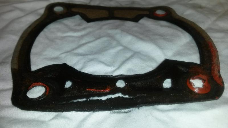

2) had to replace base gasket and used paper one -- that's very bad, see pic of mine below.
3) used goo on pull side case because of leak -- it is leaking there because you have not done the vent mod. Most of us do the vent mod because the counter balancer on the other side of the Engine is vented to the pull start side. Oil migrates from the counter balancer and fills your starter up with oil as well as contaminates the entire flywheel area and electrical. I will find this vent mod thing and post later or you can look for it using the search box. Just type vent mod.

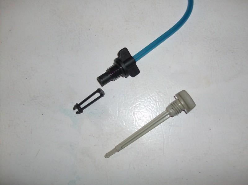

Basically what you do is remove the dip stick and make an attachment for a hose. Randman found a screw in barb on feebay that had the correct thread pitch. You can also use a Ford radiator drain plug as those have the same thread as well.
Then you buy a bellows from Can-Am and attach it at the end of the hose.
Then you remove the pull start housing and run a screw with silicone on it into the vent hole coming from the counter balancer side. It is located in the top right corner on the pull start side of the Engine.

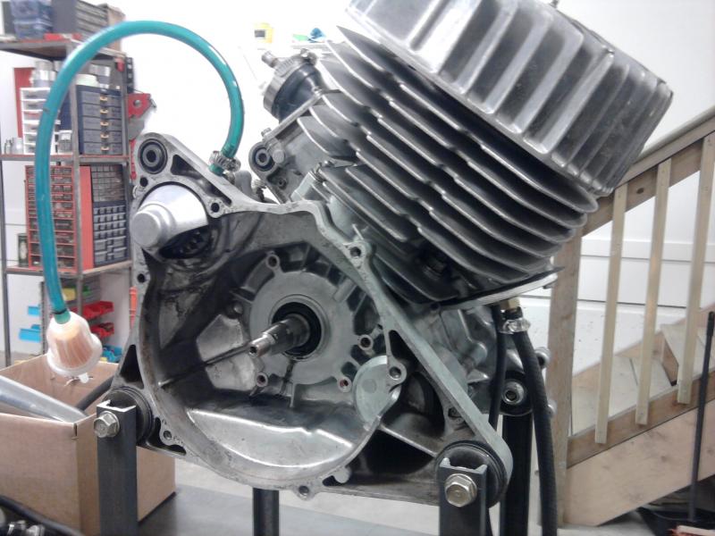

You do not have to do this mod but it saves future problems. You can run a little less oil like Honda recommended in a service bulletin. There is a picture of this bulletin in the thread I posted for you. There should be no oil coming out the pull start side of the Engine LOL.
Also note that there is a tube sticking out of the case near the starter on the pull start side of the Engine. This is the vent to atmosphere for that whole system.
File comment: Here is a good pic of it as I have a filter on the end of the hose

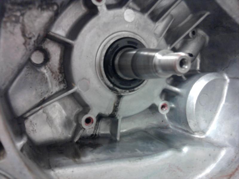

File comment: If you do actually decide to do the vent mod then here is a pic of the hole you must plug. It is located in the top right corner.

It is difficult to hold the hose into it. Mine actually came out and I lost all the oil. Lucky I didn't blow up my machine. The fitting Randman found online is the answer. I actually modified my original dip stick. It's your choice and your machine.

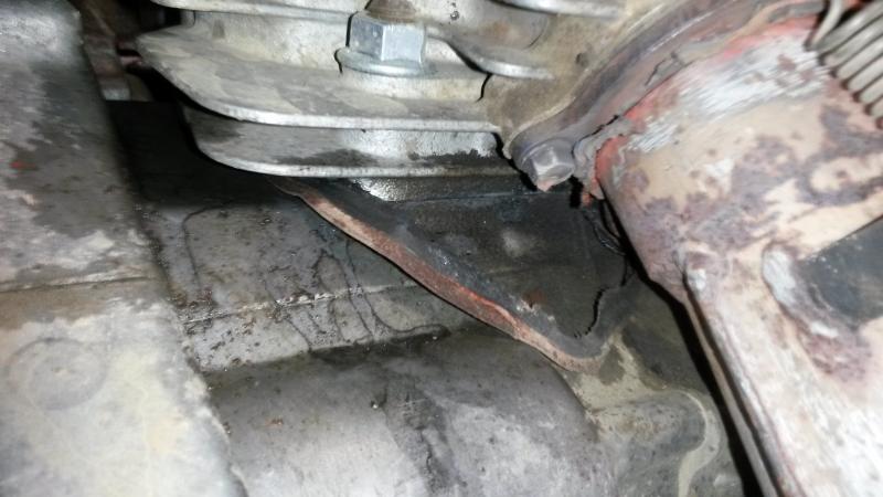

If you look closely at that those two pictures you will see that there is an oily river running down from the cylinder base gasket. This is different than what you seem to be saying about an exhaust leak. Most guys have an exhaust leak so you need to distinguish between the two. The exhaust is real black in color and this is an oily river coming directly from the base gasket.
What I would do if I was you is wipe CLEAN around the base gasket area each time you go out for a ride. If you don't see that pic above your good. You can easily see this during a ride when you stop for a coffee. Just look each time you stop. It's no big deal to look, I do this all the time. As long as you don't see that your good. If you do see it then I would pull the Engine and switch to the metal base gasket.
You will most likely only blow this bass gasket when you are really flying.
