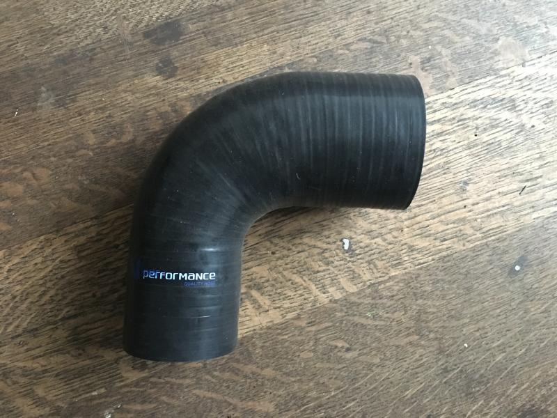

PostPosted: Sat Jun 02, 2018 10:14 am
I been looking for this link and Found it
This might help
viewtopic.php?f=1&t=17190&p=165427&hilit=air+intake+elbow#p165427

wyeeoddy:
That silicone elbow you posted is exactly what I used to connect the airbox to the carb. I have had zero issues with it coming loose or popping off. It's quite a tight fit... That's what she said.
PostPosted: Mon Jun 04, 2018 3:56 am
That's good to know as I have been looking for a supplier in Oz but no luck yet
as I try to fine local supplier first before I buy OS.
