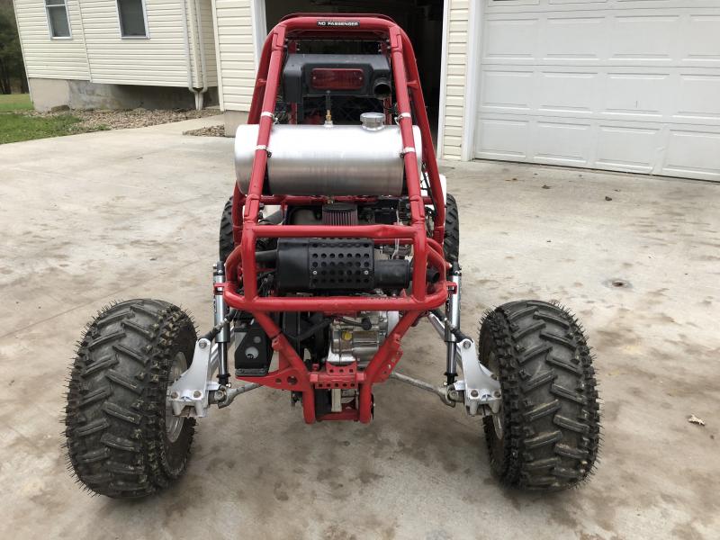

Ok new bearings in, the back left hub was almost basically locked up the bearings were so bad now its reaaal smooth, probably just gained 5hp haha. Paints on skipped the axles, axles are greased up and aligned, camber is set i didnt pull the caliper off i just sprayed it off good and its clean, i remembered the parking brake doesnt work tho so i gotta fix that, think its just slack.
I think everything is good... like my pearly whites? Lol

Oh ok so heres a thing i noticed the rear wheels are toed out not toed in like the manual sayd it should be, so removing the washer that weeyoddy mentioned woyld toe it in a bit right, what else would? Or is a little rear end toe out okay
PostPosted: Thu Nov 01, 2018 8:59 pm
Careful what you do here.
The wheels on my oddy's camber funny sometimes to but when you jump on the back of the machine suddenly everything looks ok. The rear suspension travels in an arc on an oddy. This causes your wheels to change camber and toe. You can change your toe by unscrewing the large rod end at the end of the trailing arm as well as changing the shim you are talking about. I use a tape measure to see what my toe actually is. You can't just do this by eye.

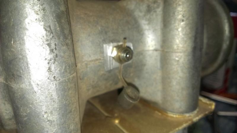

Just a silly ? when you get in the are you getting any rear sag
Meaning the rear drops down
i am only asking as the rear looks real stiff
? maybe too much air in the shock
The Right rear still looks the top of the tire is leaning it at the top
Oh ps little late put a grease nipple in the bearing carrier see pic
Also check out the rear stance of mine now my shocks a the same length if not a little longer
than yours
wyeeoddy
PostPosted: Mon Nov 05, 2018 4:11 pm
Joined: Wed Jan 10, 2018 5:53 pm
Posts: 124
Had a long work weekend but finally got back out to the garage.
So oddy after taking measurements i ended up leaving the washers in.
Because combined with wyeeoddys point yeah my stance is quite a bit taller than yours, shocks were at 240 psi i lowered it to 200 and now i actually get some sag with me sitting in it... may need to reduce psi some more? To say 180 maybe. It feels better bow than it did before.
And that's a good idea wyeeoddy, when its cold with no snow to play in ill put some fittings in, are the ones you used self-tapping?
Edit: and that right wheel is fine by the measurements, it just looks funky in the pic
