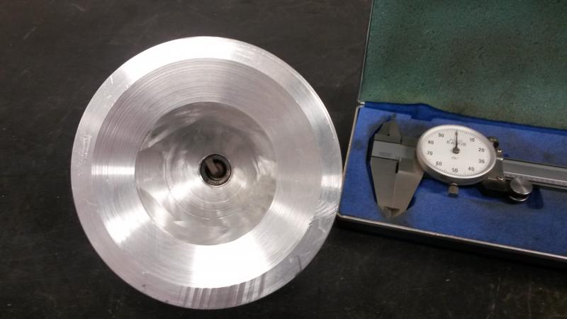

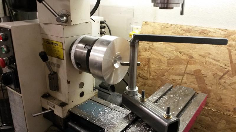

Decided to play around with making the head tonight because the 14mm tap showed up in the mail.
Tapped a hole in the blank. Cut a sparkplug and used it to mount everything in the lathe. Installed the tool I used to make the bending die awhile ago (use the search box). This tool lets you cut a curve profile. Things started out ok but then I got a lot of chatter. What was happening is that you can't get a good grip on the sparkplug because it starts to collapse with no guts on the inside of it. So tomorrow I will have to make something so that I can hold this better in the lathe.
I also tried to use the compound slide and a standard lathe bit, but if you do that then the combustion chamber will not have the curved wall and will just have a 45' straight bevel. Also had some clearance issues when I tried this.
Not sure what I am gona do tomorrow but it's all experimental for me, I have never done this.
I don't have any high quality tools to work with like a "real" lathe or milling machine.
I really wish that my piston casting experiment worked out because you could cast a head a lot easier than what I am doing now. The piston casting idea was just a test to see if I was able to reasonably cast a product, but the real reason I did that was to try to cast liquid cooled heads. So you see there was an ulterior motive behind that coo coo idea.
If Methodical saw me do this crap tonight he would shut the whole company down. He would have called for an intervention or fired my azz.

I think you could improve the chatter issue if you triangulated the tool holder. Having nothing to support the top lets it flex too easily. I guess you could double the height of the base , but that may cause clearance issues as the depth of the cut increases. The more support you have closer to the cutting tool the more solid it will be. Slowing feed/rotation rate of the cutter, but increasing the speed of the lathe can sometimes help too. Experimenting with the depth of the cut could have an effect too.

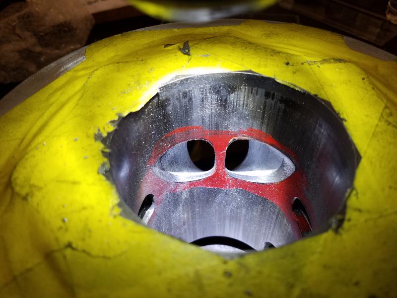

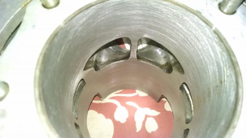

CO, I thought that cylinder looked familiar. If I were porting a post recall cylinder I would not cut the port square. I would look to what RPM I intended to run the Engine at, then I would determine the exhaust, transfer and intake duration I need to run that rpm. I would cut the exhaust ports in a manner that increases the mean effective area in the appropriate location compared to the transfers. If you will, picture the exhaust ports cut larger at the top portion of the port, with a slightly arched top edge, that then tapers down to the bottom edge of the port. You want the exhaust to flow out of the cylinder as much as possible before the transfers open which aids in minimizing the charge blown out the exhaust. Remember that when determining the exhaust and transfer durations focus on blow down duration as this is an important part of power production. The attached pic is a port job in process but should show the idea of shape I'm referring to.
PostPosted: Sun Nov 18, 2018 4:08 pm
Yeah I see what you have done there.
I am not an Engine guy, I am a hack n whack guy and have never studied anything related to porting so bear with me on incompetent questions:
1) Is it not desired to have the exhaust blow out as quick as possible as soon as the port opens ??
2) The pressure in the combustion chamber when it lights up is about 750 psi. Therefore if the top of the exhaust port is square wouldn't it allow the exhaust to blast out quicker with a bigger area at the top because it is square ?? What I see in all the cylinders is the exhaust port oval shaped and yours shown there is similar. Why not square the top end ?? I'm missing something here on the theory.
Edit: I just read your post SLOWLY this time. I guess what you are saying is that if the port is square a lot of the fresh intake charge blows out the big exhaust hole. Makes sense now. As soon as the transfer ports close you want to start choking off the exhaust hole to prevent the new charge from escaping.

CO, you have more great ideas then you give yourself credit. A round hole always has more volume then a similarly sized square hole. The exhaust port size is relative. I make the widest part of my ports 90% of the bore diameter. The top of the port where I mentioned mean effective area is made larger so more exhaust blows out quicker, prior to opening the transfers You nailed that idea, but by widening the port to 90% you take even more advantage of moving expelling gases. The pic below is an example of a ported pre recall cylinder. The ports as you've shown are square, when these cylinders are ported look how wide the top part of the exhaust port is made. Also notice how all edges are rounded to keep the rings from snagging.

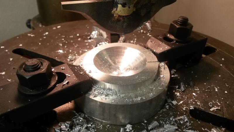

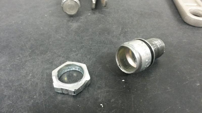

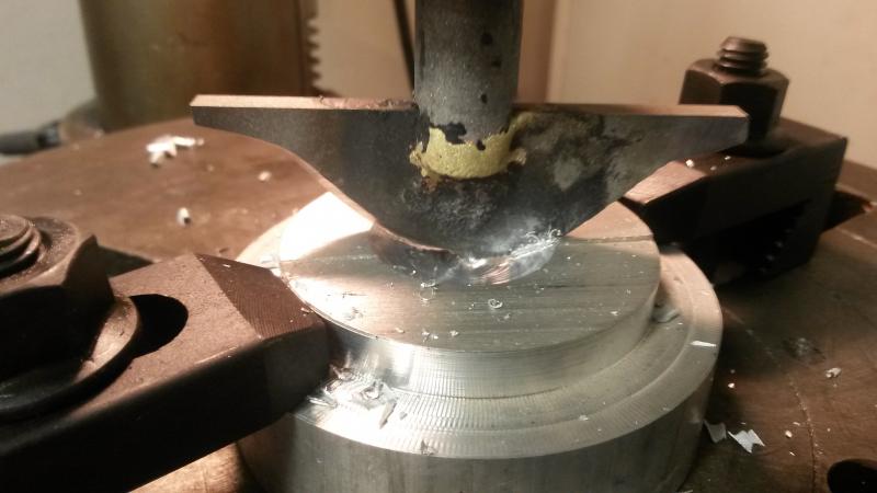

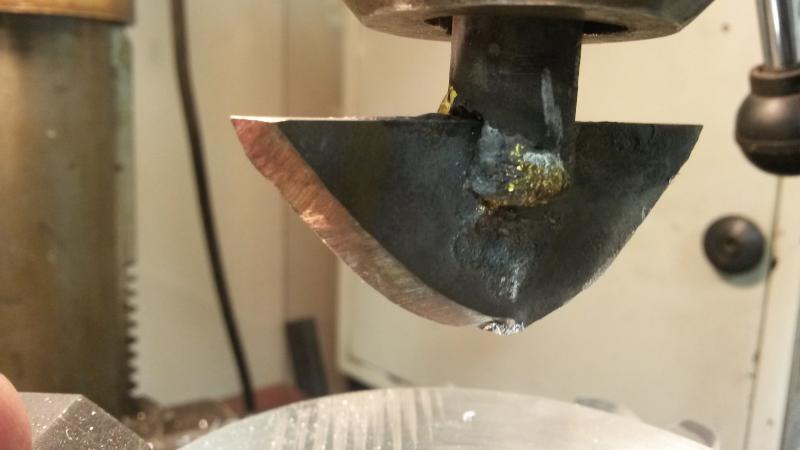

Got some time tonight to play.
Made a cutter shaped like the combustion chamber out of an old planer blade I had here. These are the industrial kind that we had at a place I worked. They get thrown in the garbage after a while so grabbed a few. This is high quality high speed steel. I didn't do a very good job on this tool but tried it anyways. Turned out better than expected but still not right. Below is a pic of a test piece and then I tried to fix the head I did on the lathe. The shape of that combustion chamber was definitely no good so I had nothing to lose. At the end of the day this piece is probably junk.
Also of note is that if you use a sparkplug to hold anything keep in mind that the hexagon part your socket fits on is just friction welded on the body of the sparkplug. This is probably why I was having trouble holding that piece in the lathe. Tonight when I tried to remove the sparkplug from the homemade head it just peeled off. See pic.

CO, how bad did the cutter chatter when plunging to cut the chamber? I've seen some guys on other boards do something similar. That actually doesn't look bad.....
PostPosted: Mon Nov 26, 2018 9:30 pm
Chatter was bad because I couldn't get the cutter in line with center. I did trim it a bit the other day and cut the wings off for the squish band cut. This all helped a lot with regards to chatter. One of the keys was gently cuts. No hogging. At the end of the day my northern skillbilly solutions will require some buffing with a flap wheel. Got a long way to go with respect to making my own heads. If I do get there then I will have to cut the squish band manually in the lathe. I wish I had the skills and machines you got.

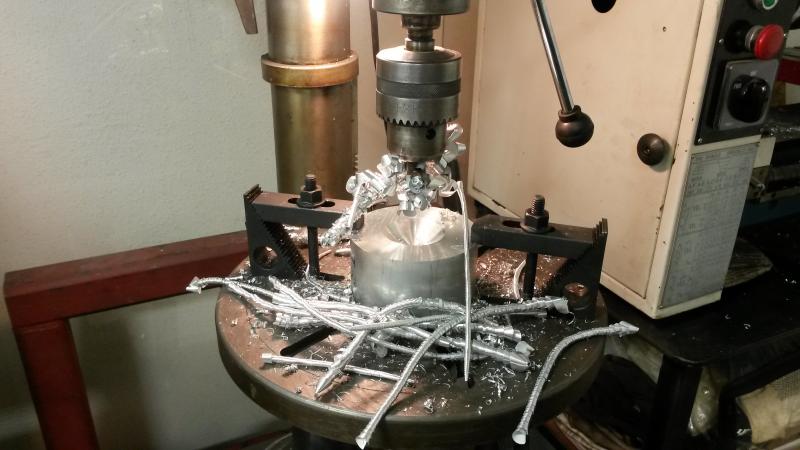

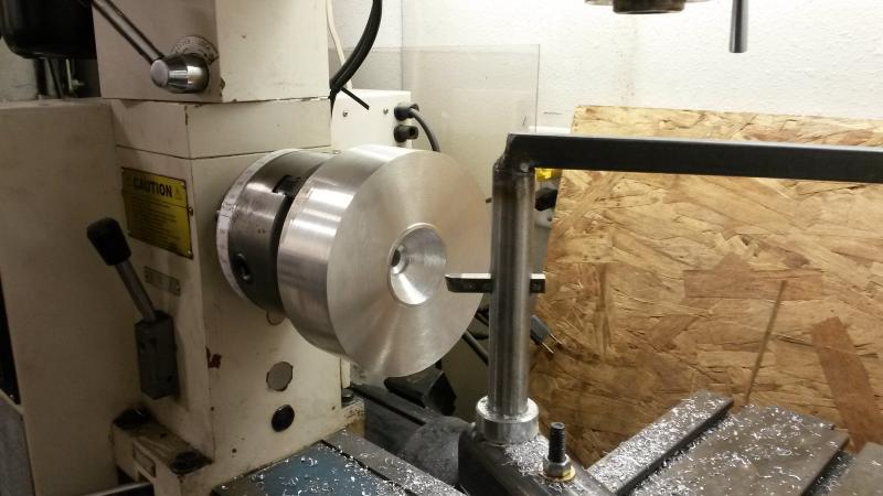

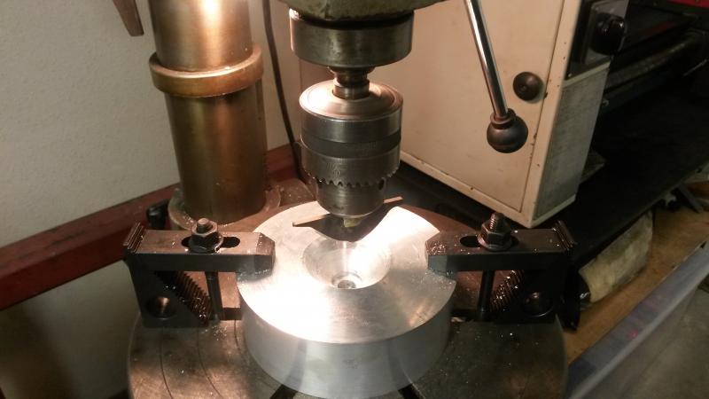

I am very happy with what just happened in my shop.
I cut a piece of aluminum round stock and cut a combustion chamber in it with that cutter I made.
Learned a few important lessons. One lesson is that you DO NOT CUT A PILOT HOLE for this homemade cutter. When I tried to do this same thing on that piece of 6" round stock the other day, that I had already cut and tapped a sparkplug hole, I ended up getting bad chatter marks as well as it tried to "run off". That piece is now junk. This new piece of 4" round stock I did tonight has NO chatter marks. The marks you see in the picture are the actual rough grinding I did to make the cutter edge.
The second lesson I learned was to apply a lot of pressure to the drill press handle until the cutter actually stalled. Then back off a bit. As you can see the chaff is nice and curly .
It only took about 10mins to cut this, but another almost 20min to make sure is was deep enough to hold 30cc of water. How did I chose 30cc ?? Well because earlier in another thread I calculated that the squish band holds 5cc. An oddy head is about 35cc. If I am out a cc or two then fire me boss .
Now I have to manually cut the squish band on the lathe.
Like I said this thing is experimental and it's about a challenge and having fun. A positive end result will be awesome with this project but it is not a prerequisite.

Later tonight (about midnight west coast time) I will try to post a pic of the combustion chamber with the squish band cut and what the final plan is for this. Also why I am doing it this way.
PostPosted: Sat Dec 01, 2018 2:46 am

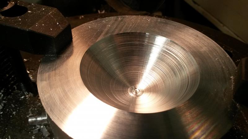

Well I got finished a bit early.
Unfortunately I cut the squish band slightly wider than I wanted but it's close enough for me.
I guess I could trim it a bit to get the squish band correct width but then I will have to trim out the combustion chamber a bit more. Not sure yet.
I measured the head volume and it came in at 33cc approx. But I still have to radius the edge of the squish band where it ends inside the combustion chamber. In the pic you can see the sharp edge where the two meet. Then I should be able to get the 2cc I need or at least close.

PostPosted: Sat Dec 01, 2018 3:24 am
Mystery pic.
Anyone wana guess what the plan is ?? :-)
I did end up trimming the squish band and cut a bevel where the squish band and combustion chamber meet. Still have to buff it with a flapper wheel and re-measure the cc's.
