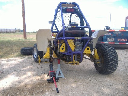

Whats with the shocks the spring rate looks a little stiff?
How do they work?
PostPosted: Sun Sep 10, 2006 5:56 pm
I like what he did on the rear link Maybe he can post some reviews and how to's
But yea look a little stiff to me also... Here is a picture of mine on a jack... You guy's forgot to remind me that the rear wheel is wider, and I hit a tree at about 30mph... I am beating the rim back in shape and letting 25 lbs of air reseat the bead... all else seems ok...
File comment: Stock shocks!!!!

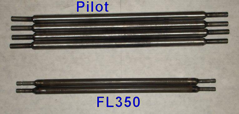

Ok today I straighten out the tie rods in a press then cut the tubing and squared up the ends in the lathe, tomorrow I will weld them up.

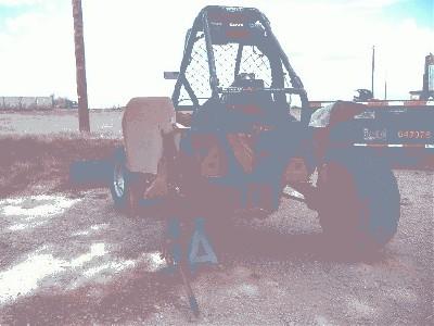

Yeah cool I'll give them a try out.
Those are steel toed blue fuzzy slippers.....
BTW: Whats up with the color in a couple pics? Is it my PC or does the last one look washed out?
PostPosted: Tue Sep 12, 2006 8:53 pm
Click on the pics then see this posthttp://pilotodyssey.com/PO/viewtopic.php?t=2466

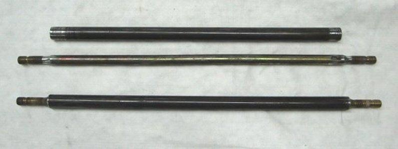

Ok Mudbogger and MasOdy your hoserized tie rods are done and ready to ship tomorrow.
PostPosted: Wed Mar 07, 2007 8:55 pm
Posts: 805
Location: Bolton Ma
Very Nice.
thanks!
I give them a whirl.
