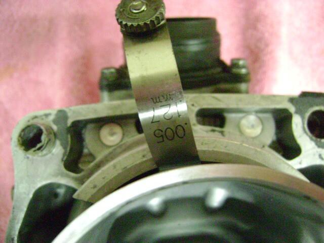

Here is a perfect example as to why I started this thread.
Here is the cylinder ludedude sold afastcar through his http://p-o-ps.com/pops/portal.php web site and ebay account, BUYER BEWARE of this guy below is why, the cylinder is on its last bore, he knew this he installed the LAST OVER BORE Wiseco piston into this cylinder and DIDNT TELL ANYBODY IN THE AUCTION.
All Ludedude of http://p-o-ps.com/pops/portal.php had to do is this simple test if he did NOT have the proper measuring tools.
In the pictures I have TWO .005 feeler gauges one on each side of the piston between the piston and cylinder wall.
IF the piston to cylinder clearance was CLOSE to being right those would be .0025 feeler gauges NOT .005
Piston to cylinder clearance is defined as the DIFFERENCE between the SMALLEST INSIDE DIAMETER found in the cylinder and the LARGEST OUTSIDE DIAMETER found on the piston.
You would think even if Ludedude of http://p-o-ps.com/pops/portal.php was DUMB AS A ROCK he would consult one of his "Tech Advisor - Guru's" and they would help the guy out.
IMO the .010 clearance was intentional Ludedude of http://p-o-ps.com/pops/portal.php had been SCHOOLED on piston to cylinder clearance and Wiseco pistons the first few weeks he joined my message board. IE he knew he was selling JUNK to someone on ebay when he listed it.
BUYER BEWARE of this MUTT!!!! Here is his ebay account http://myworld.ebay.com/ebaymotors/www- ... allel-net/
consider this thread a "FEEDBACK"
PostPosted: Fri Aug 17, 2007 10:16 am
.005 on the exhaust side.

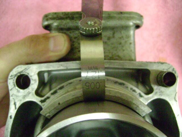

PostPosted: Fri Aug 17, 2007 10:17 am
.005 on the intake side.
in case you cant add .005 PLUS .005 = .010

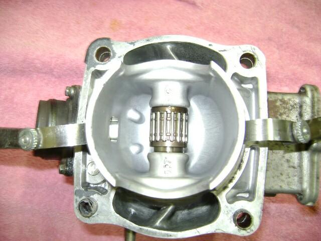

You can do it either way long as you find the DIFFERENCE between the smallest cylinder bore size and the largest size found on the piston.
I measured the piston and found the largest part, then I locked the dial so it cant turn and put it in the vise then I set the dial bore gauge to 0 when I insert it into the bore and it reads .0035 on the dial that means I have .0035 piston to cylinder clearance, follow me? I am just letting the tools do the math for me, were both doing the same thing.
