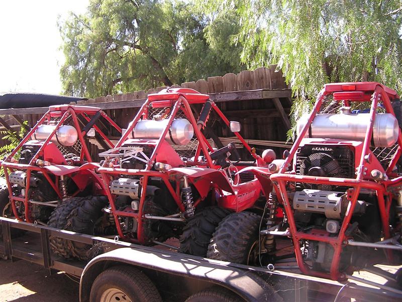

The alum tank IMO isnt a good choice due to the size-see in the picture now the ends protrude out from the roll cage-in a rollover situation it is totally exposed-not good, and also the potential of fuel spillage onto a hot motor (( Internal Combustion Engine ? )) in the same situation is a definie possibility for sure-not good.Those fuel caps do not seal as well as the stock fuel cell does IMO.

I've done them on Odysseys and Pilots and have never had an issue with them, some do, it's a preference thing, pros and cons both ways.
Try this guy, price is decent and he's always done good by me:
http://dansperformanceparts.com/buggy/f ... yfuel1.htm
But I'd try to keep the stock system before making any permanent modifications.

The 3.5 gal 8x16 will fit inside the frame, but the 5 gal 8x24 tanks won't (as seen in the pics above).
Some prefer aluminum, some poly. I have seen the poly tanks rupture on a roll-over, whereas the aluminum tanks usually just get dented.
Others have said the opposite, so you take your chances either way unless you keep it tucked inside the frame.

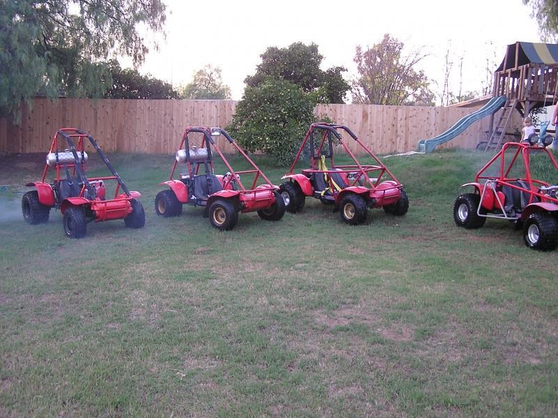

PostPosted: Tue Nov 25, 2008 3:15 am
Dude that's a whole lot of buggies... Got riders for all of them?
PostPosted: Tue Nov 25, 2008 10:35 am
Posts: 1419
Location: San Diego
We currently don't have enough vehicles for everyone........
We've sold all but one of our 5 250's and are down to 3 pilots, 2 350's and the one 250.
