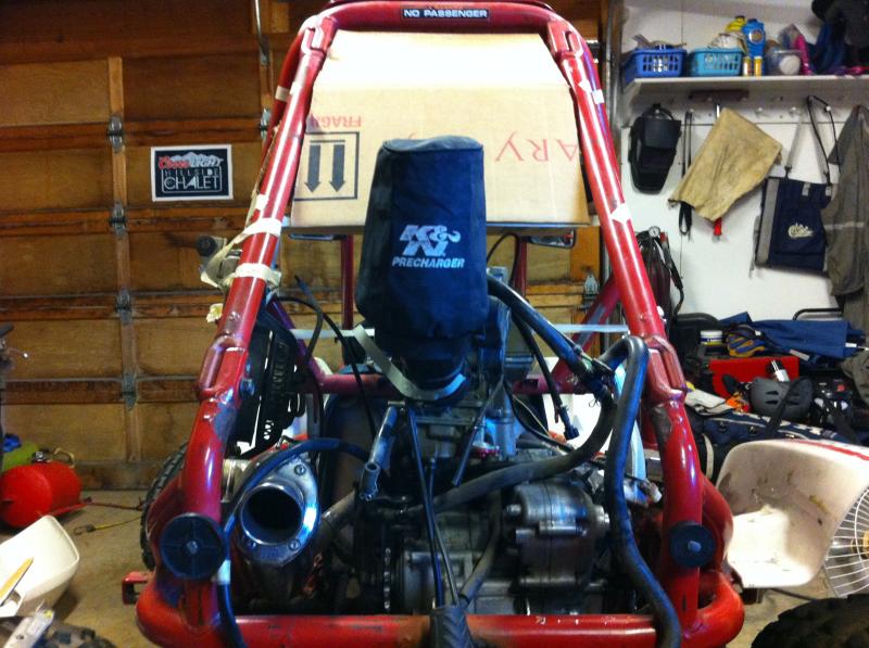

well i think i am going to go with the gravity feed, and move the rad. it the only way i am going to get a descent size gas tank. so this is what i have mocked up so far, the cardboard will be the gas tank, i can lower it a little more but not too much as i need access to the spark plug. i can drop it down on the one side but i might look goofy, so i might just do something like what is shown.

Whats wrong with behind the seat?
I'd put the rad where you have the cardboard ,but on the back down tubes, as low as you can get it, inside the tubes.
How big of tank do you need?
How about on the right side of the Engine? Kinda next to/along the cylinder for the tank?
Whats in the stock tank location?
I looked back at your pics, looks like plenty of room in front of the Engine down low? Maybe even use the stock Motorengine mounts?

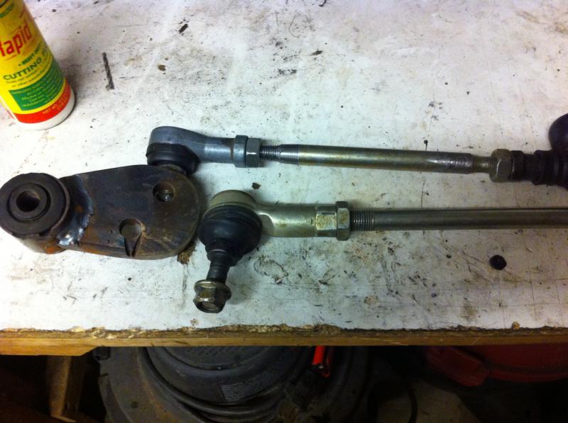

well i got a little more done tonight, got the valves set, they were way out, so glad i took care of that, also took the stock tie rods put them in my drill and used it like a lathe, tied the trigger back and used my grinder to slowly make the diameter smaller to i could thread them to the length i needed, that was for the inner tie rods, the outer just need to be cut down and threaded but i don't have a 12x 1.25 die. so will have to find one tomorrow. need to make a couple more brackets for the steering and i can weld it all in. i think it will be stronger, than on my 360, so far it looks alot better and beefier.

1) i thought about it but just didnt seem right. might try again and take pic and see what it looks like
2) bigger the better, would be nice to ride 40+ miles on a tank, that's what the average rally is up here.
3) kind of thought about a saddle tank that would come down on both sides, just need to keep the spark plug in mind.
4) electronics and battery tray
5) thought about that as well. it would require a electric pump for sure, and the way the exhaust worked out its kind of in the middle, so i would have to redo the exhaust, i am also going to dump this seat and go with a high back plastic seat like in my other oddy, you sit up alittle straighter and gain a little leg room as well, going to need all i can get with having a clutch in down there
