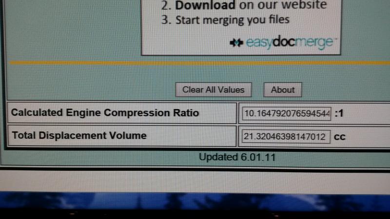

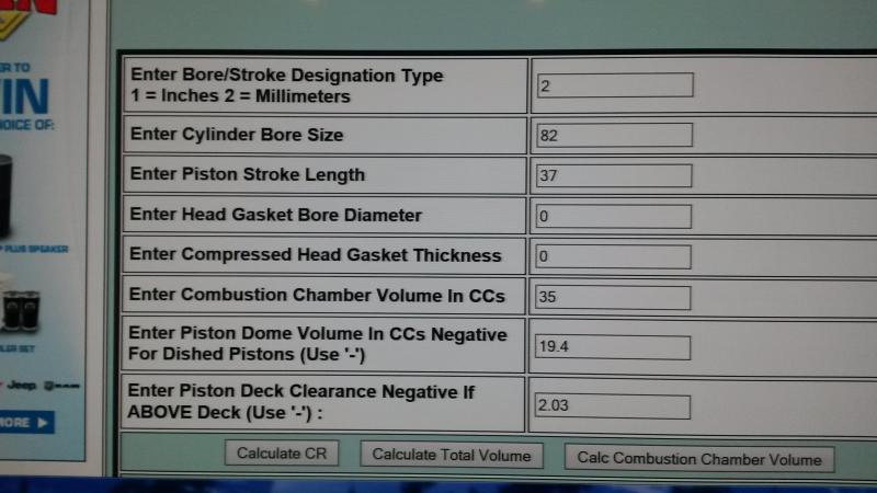

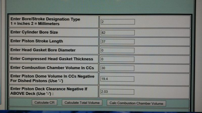

PostPosted: Mon Dec 03, 2018 1:46 am
Here are some pics of that online calculator results.
The first pic shows the 30cc head numbers with no head. I'm not running a gasket. I'm running an o-ring.
Second pic is the projected CR.
Third pic is the stock 35cc oddy head.
Fourth pic is the projected CR.
Interestingly when I did the calculations with a standard head gasket (.042") I got 8.25 to 1 with the 30cc head and 7.12 to 1 with the 35cc head.
So if I have to I can still run a full size standard head gasket to bring down the compression.
I am really interested right now to see how close these calculated numbers are gona be.

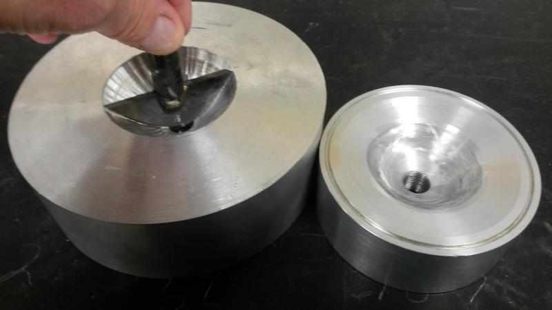

PostPosted: Mon Dec 03, 2018 4:05 pm
liduno --- here is a closer pic of both of those heads.
If you look close you can see the chatter marks on the 6" head.
What you can't see unless you were here and holding it in your hand is that the cutter "ran off" to one side by nearly and 1/8" and the sparkplug hole is no longer in the center of the combustion chamber. It's junk. I suppose I could buff out those chatter marks and use it anyways but I don't want to. An oddy cylinder head has the sparkplug angled so maybe it is "good enough" but I'll pass.
I suppose I could start over and make another head but I suddenly got a woody when I ran the numbers and figure I could build a grenade with 200psi compression and a welded piston :-) . If this thing holds together it might be a Polaris/Honda slayer :-) .

Besides if you enter 68mm stroke you will get a ridiculous compression ratio. It's obviously wrong.
Yes I tried it -- after bug posted that.
PostPosted: Tue Dec 04, 2018 10:37 am
Posts: 1070
Theres a better online calculator somewhere for 2-strokes.
Measuring CR using the distance from the top of the exhaust port for calculation will give you STATIC CR. Then, using the calculation for full Engine stroke from BDC to TDC (Top Dead Center) -> on a 2-stroke that is called DYNAMIC CR.
The actual CR of a 2-stroke will end up being somewhere between STATIC and DYNAMIC based on tune of the pipe, Engine rpm, efficiency, port configuration, etc. This is what makes determining the actual CR of a 2-stroke much more difficult to calculate.
What I would recommend is to use a fuel who's octane will cover 75~85% of the dynamic CR. This would be for safety of the Engine. Set the squish to .40 thou, then adjust your chamber volume to get your Engine compression up to about 180psi. Ending Engine compression in PSI will pivot around your STATIC CR btw.
I run VP110 or C12 on all my machines, and my jetski with a DASA Engine is running the highest CR and compression. Dynamically, I'm at 14.7:1 CR. Squish is at 50thou. Chambers are very small and the Engine is making 220psi on a gauge. Keep in mind this Engine is used for low rpm torque/brap which only sees full throttle for less than 5 seconds at any time (Because the whole jetski is usually inverted by the time the power comes on full).
PostPosted: Tue Dec 04, 2018 11:00 am
Posts: 1070
Also how are you figuring your deck height to be 2.03mm? That seems to not be right at all and will affect your final CRs calculated. I think my Pilot and Ody have a deck height at about 0.75mm. Arnt you using an ody piston?
