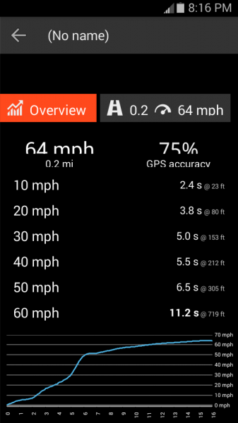

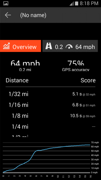

Ralph's machine (super Engine)
CO

This is the data:
Mph - seconds - feet
Ralph corrected times (minus 1 second for wheel spin)
10 - 1.4 -23
20 - 2.8 - 80
30 - 4 - 153
40 - 4.5 - 212
50 - 6.5 - 305
60 - 10.2 - 719

a problem with most of the GPS apps is they only update 1/sec, unless you get something at least 10X/sec ideally 1000x/sec. I think the data is going to be all over the place.

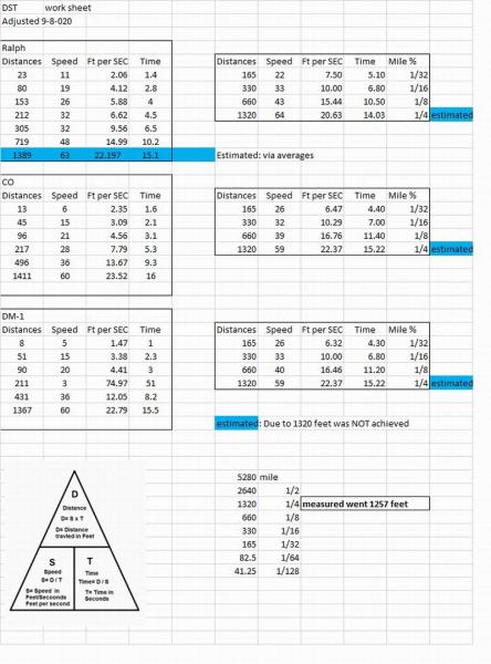

 Post subject: Re: 0-60
PostPosted: Tue Sep 08, 2020 7:29 pm
OK what I did was use some of the data to get a corrected the best I can.
An Item to note is the estimated stuff.
Most likely since you did not travel the 1/4 mile it did not register.
What I did was use top speed and set it for 1/4 mile. since you almost ran that far.
Looking at the numbers not there seam to be a pattern that look ok.
Please let me know if you feel this is OK and I will move forward to the rest.
It does make the data entry a little more rough to do on a large scale. I decided to use the distance scale and took times from that and turn that into speed. So every one log both and post so I can enter for comparison.
File comment: CO adjusted
PostPosted: Wed Sep 09, 2020 1:29 am
Hey adnoh I was just looking at that last chart you posted.
Something doesn't look right to me.
Take a look at the 1/8 mile and the 1/4 mile lines of Ralph's machine and CO machine.
My brothers machine shows 64 mph and 20.63 ft/sec
Mine shows 59 mph and 22.37 ft/sec
That don't make sense to me. How can the ft/sec be slower if a machine is running more mph than the other machine ??
