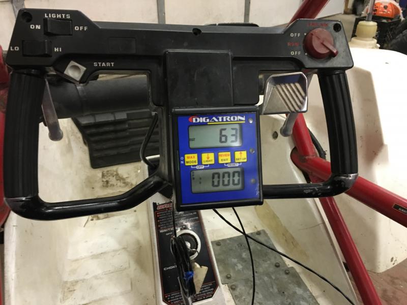

Back from a little vaca with kids and wife.
Put about an easy hour or so on it since good base jetting.
Got the digitron mounted. What is the egt location spec. I think others have learned before me. Going to check the wet line when I take it off but with the springs and limited locations figured you already have the answer.
Also got the missing tool box stores the outerwears cover for the egt nice!
Thanks in advance.

PostPosted: Thu Apr 28, 2016 9:39 am
Joined: Thu May 07, 2015 3:47 pm
Posts: 151
Location: Haverhill, MA and Conway, NH
Got some of the sensors routed. I went with the most common location of 2.5 inches down the pipe between the springs for the egt and then hooked cht and tach up.
Love it so far and haven't even run it yet other than a warm up.
ODDY COOL- This is a must in my opinion. It is amazing how quickly this brings down the CHT. I only let it get to about 220F warm up and as soon as you click the fan on watch the numbers go backwards.
