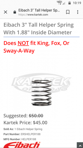

Is this one?

adnoh wrote:
Is this one?
Yeah I seen those ones but I was looking for some helper springs with some spring rate and not just take up slack caused by the shorter 10" main spring we will be forced to run.
Edit: Here is the site: https://eibach.com/us/c-41-ers-helper-spring.html
You will notice that the only 188 spring they got has only 12.34lbs of spring rate.
Not much help.

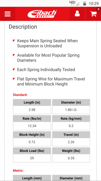

Spec

adnoh wrote:
Spec
Haahahahaha I just posted that with an edit.
12 lbs of spring rate won't help us much will it ??
Edit: and the yoyo's want $50 for it. You can get a whole spring for that.

I think it may help.
This would allow for a softer rate like 140 and allow for the sag with out to much preload.
With your weight and balance and sprung weight of 180 it could give you the sag you need with some peload adjustability with a bottom out around 420 to 460.

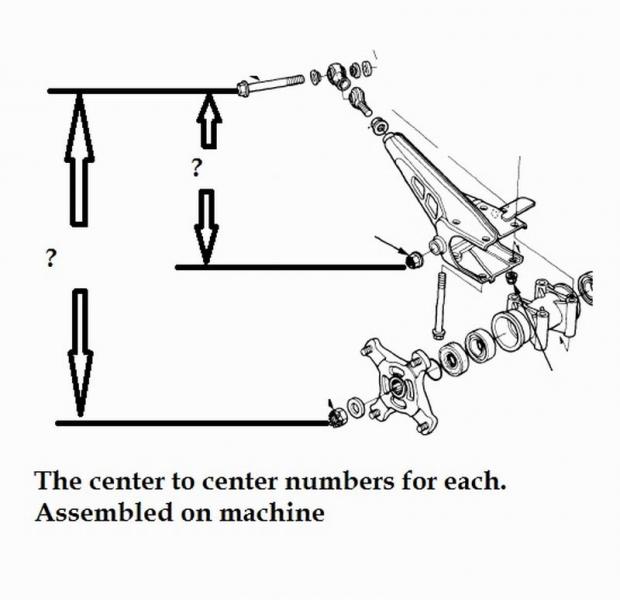

need info, see pic

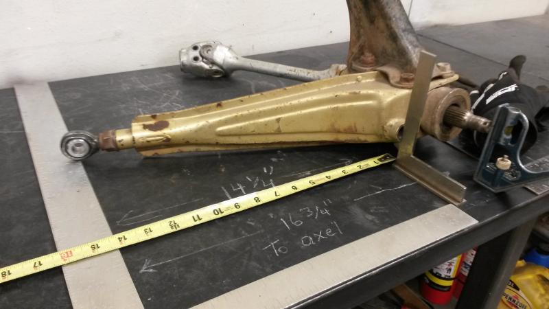

 Post subject: Re: Rear springs...
PostPosted: Sat Mar 16, 2019 8:11 pm
adnoh wrote:
need info, see pic
It's 14 1/4" from center of hiem to center of shock bolt
It's 16 3/4" from center of hiem to center of axel
Keep in mind that the hiem can be unscrewed for adjustments but lets just get a close enough number here.

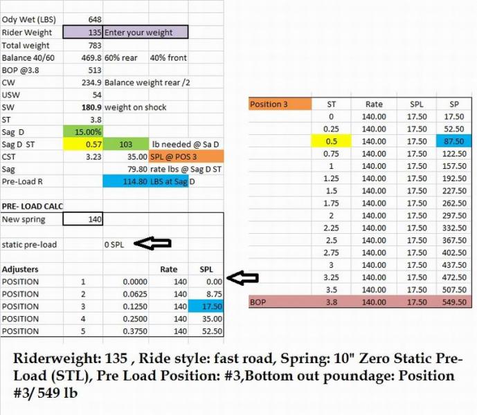

Take a look at this and see what you think

PostPosted: Tue Mar 19, 2019 8:34 pm
Wow that's pretty complete.
I can actually figure it out. Nicely done.
I have a question:
How do I know that based on the spring rate I choose, that my shocks won't bottom out ?? What am I suppose to be looking for on that chart and future charts ??

Forgive me if I have missed this, but does this account for the spacer as well? Does the spacer change anything in the equation?
PostPosted: Tue Mar 19, 2019 10:43 pm
CO, it will bottom out at the listed BOP. Compare to the stock spring. Here is where a good bottom out bumper helps.
Garrmie, the spacer it at zero preload. This means the thickness of the solid spacer is cut so no static preload poundage is on the shock. Then you go to the adjuster position for poundage change. Remembermber this is per wheel.
With this info one can go with softer or stiffer depending on there type of ridding.
The posted chart is a starting point. I will show some examples of how it can change and what adjustment are required for different requirements.

PostPosted: Tue Mar 19, 2019 11:18 pm
I might be reading this part wrong on the chart.
1) I see on the chart some figures just above the Position 1 and Position 2 boxes.
That first line at the end says "Honda base line" and the line below it says "race tech confirmed".
Can you explain these two.
I think I know but not sure. Please clue me in.
2) Edit: I think I also see a boo boo there -- on the top left of that chart it says "103 lbs needed at Sa D (sag desired) and 35.00 SPL (static preload) at pos 3
Well if the desired sag needed is 0.5" and 103 lbs needed then that would be pos 4 and NOT pos 3 ??

see if this helps
PostPosted: Wed Mar 20, 2019 11:44 am
According to the chart you need 103 lbs +/-
Look at chart you take pre-load position #3 @ 17.50 then add shaft travel for that position 87.5 =105
I do not now how accurate the info is since we no measurable base line for correction. It is based from what I come up with with the numbers supplied.
Once terry H is done I can adjust. I will post up a chart based on his weight and spring package. Then we will see what adjustment need to be done to chart for a better or more accurate chart.
We have to start some where. I would hate for some one to buy springs that don't work for them.
What you don't see is the effect on wheel rate which is not a one to one relation ship to spring rate. I left this out to try to keep it simple. The math is done behind the seen.If you would like I can do a short babble sheet for you.
