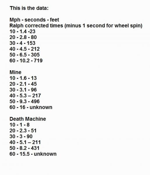

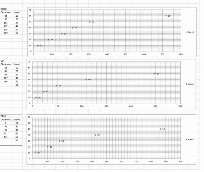

Any body want to take a shot at why??

Here is the spreed sheet cell math

CO: Question
Hey adnoh I was just looking at that last chart you posted.
Something doesn't look right to me.
Take a look at the 1/8 mile and the 1/4 mile lines of Ralph's machine and CO machine.
My brothers machine shows 64 mph and 20.63 ft/sec
Mine shows 59 mph and 22.37 ft/sec
 Post subject: Re: 0-60
PostPosted: Wed Sep 09, 2020 12:21 pm
This site is real slow now a days so you might be waiting a few weeks for a reply LOL.
I won't even try to take a shot at why. All I know is it don't seem square.
CO
PostPosted: Wed Sep 09, 2020 12:23 pm
Were solving: corrected MPH for a given time (ET)
So if we take the fixed 1257 for all three than divide each ET into it, you will get the number that look right to your way of thinking.
Ralf: 1257/13.28=94.65 feet per sec.
CO: 1257/14.49=86.479 feet per sec.
DM-1: same as CO
Now this shows Ralf to travel future per sec. So Ralf is quicker over all.
Now what if we plot this in an X and Y graph. We have two linear lines and the graph will only show Ralf is faster all the way there at a fixed rate and CO and DM-1 is the same.
Ask your self is this what happened???

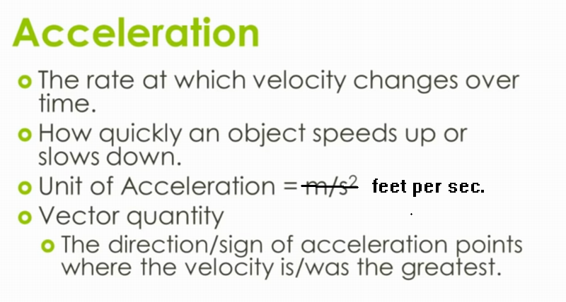

Once we agree on a set value(s) on the numbers we can move forward. I have to have a way to input everyone data to given set points to get information other than 1/4 trap speed.
Maybe should not have labeled the cell reference(I can hide it) the way I did as it leads to confusion. Just like to show the hacker math.
That leads us to where I hope were going, see pic.
Its very important your understand as your info is the base line.
I can back up and try to explain the best I can or maybe some one else jump in and help. Your dealing with 9th grade math skills here. A lot of what I come up with is based off my Electrical Training over the years. like 746 watts = 1 HP.
Hell that's not even really true any more once you factor in other items.
OOPS!!!! starting to babble

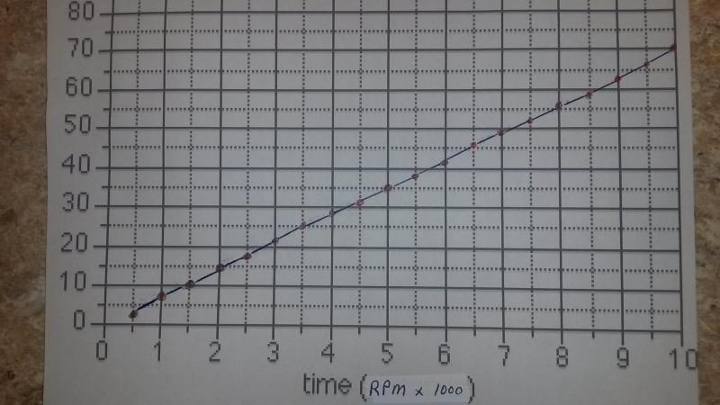

Going to bring this old thread back to life one more time.
I just did a speed vs rpm chart for an oddy.
This is for stock size tires running between 5 psi and 7 psi.
Your tire size changes a bit based on the amount of air pressure (I've already done a thread on that) but most of us run these pressures.
The oddy cvt drive runs from 2 to 1 down to 1 to 1 (did that in the dyno thread) and the gearbox is a 10 to 1 reduction.
Below is the chart and you can clearly see that a basically stock oddy Engine will run about 62 mph and a built Engine can run to about 70 mph tops.
CO

I am probably wrong but not buying that, my CVT doesn't engage until about 4500 rpm and maxis out at around 7800 but keeps going faster and faster depending on where the CVT is at, your numbers are probably correct got a fully engaged CVT package.
PostPosted: Fri Jan 29, 2021 7:54 pm
You are correct.
But this chart shows what your speed is if the CVT was at the 1 to 1 top end ratio.
It shows what your max speed can be based on mathematics and your CVT at 1 to 1.
This is all the oddy can do based on math.
The reason I posted this was because I seen an ad where the guy was claiming his machine would do quote: "70 mph no problem". LMAO. It was a total piece of shyte based on the pics in that ad and the Engine was stock LOL.
A stock oddy Engine will pull to 9000 tops with a pipe, carb and AVGAS. A built Engine 10000 plus.
In other words, only a built Engine can do 70 mph.
