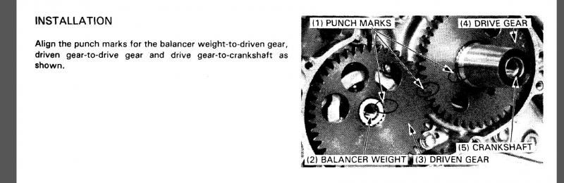

Thanks to both you guys for the quick replys. I have been on this site sence the first day I bought my oddy and I have read just about everyting on the site. I know how to do the Engine mods and have the tools to do it right. I have worked on several engines so it is not a big deal to do it. I just don't want the counter balancer to be off even one tooth. I am using my iPhone for my Internet so I can't download the manual. I guess I'll try and find a computer and get it that way and look at it. I was just wondering if anyone knew off hand how to align and time the counterbalancer to the crank off hand. Thanks a million to this site and everyone in it.
PostPosted: Tue May 22, 2012 3:52 pm
This is from the manual. Please download and read the entire manual.

Thank you thank you thank you. That's exactly what I needed to know. I can't believe I missed that mark on the crank but I see it now. You guys are the best!!
