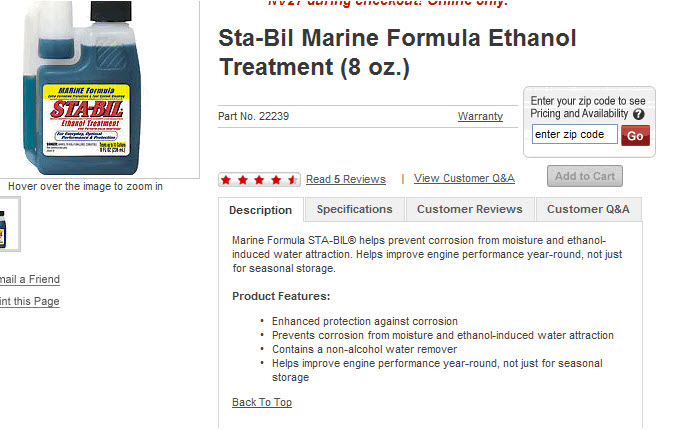

The only bit of additional information I found was to use marine sta-bil in the gas.
I do not have test data to back this up but a couple of the guys have older bikes and they swear by it.
