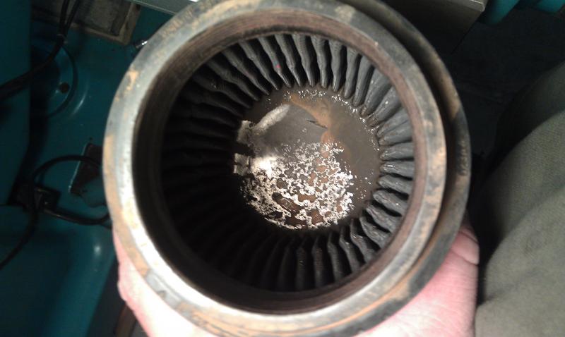

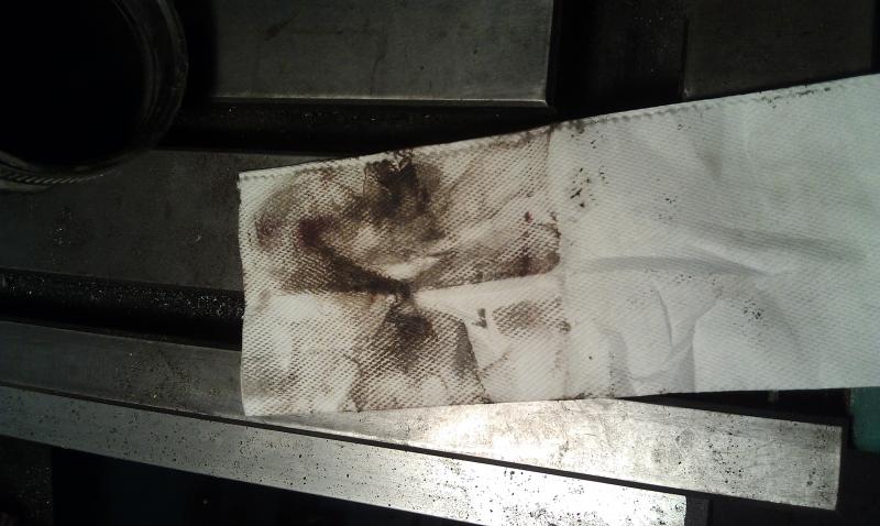

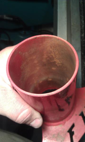

45 min to 1 hr use after clean and reoil
File comment: K&n shit

File comment: The reason why k&n sucks ballz
