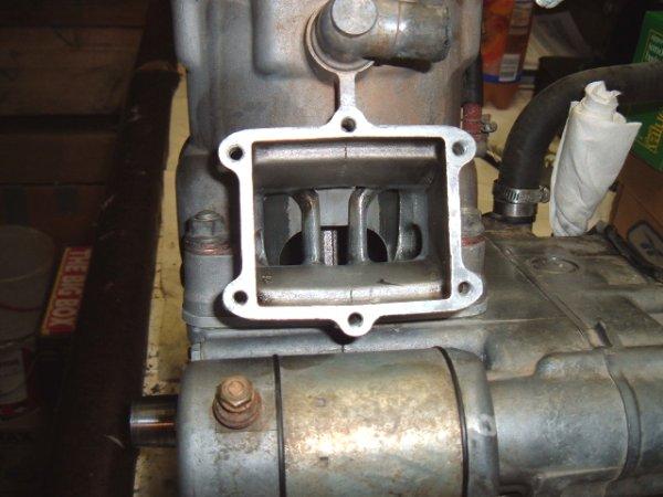

Well as our story begins, it is late fall 2004 and I am just finishing up doing the last (or so I thought) bit of maintance on the two machines I am going to take to the Fall Jambo at Litte Sahara
I have checked all the fluids and given both my Stock FL400 (wifes ride - or so called) and my Bad500 (My LT Pilot with a 400cc Cylinder Punched out to 500cc) the 10 point check over...
It's a nice fall evening and I've already done a couple of plug chops and everything is looking great.
I decide to take the Bad500 for a little spin around the farm and down the country roads...
I return about 15 minutes later and the Pilot is running great - One last pass to the top of the hill and I'm going to load it on the trailer for the trip. As I aproach the top of the hill, running about 50 MPH the Engine slowly dies... I immediately reach down and pull the choke hoping that if I did get it hot I would be able to cool her off as I coast to a stop...
I hop out hoping that something simple happened like a) plug wire came off b) I accidently hit the kill switch c) the plug unscrewed itself (hey it's happend before) but everything looks normal...
After letting it cool down for about 10 minutes I try to give it a little pull via the start rope - Nothing doing - AH CRAP - At this point I'm guessing 4 point seizure.
Anyhow with very little time left before the Jambo I decide to push it in the garage and take my Work-in-progress FL670R instead... (In hind sight I'd guess I'd rather it blew before I loaded and halled it 8.5 hours to a ride area)
MAN I MUST BE A WORDY GUSS...
Anyhow - here it is today (or so) and I have finially started tearing into the BAD500 to see what happened.
NOTE:
For those of you that didn't know the BAD500 has been my adopted experimental project since I bought it - no one seems to know its origin or who created such a beast. Many such as ATVR have said that they never punch out a FL400 to run the CR500 piston. CW Racing has admitted to doing this mod to some Pilots but claims his all have his markings on them...
It's been two years since I have had to tear into this machine so I (an others I assume) are kinda interested in seeing what has been going on...
Enjoy the Picts - Any/All thoughts are welcome...
Dennis

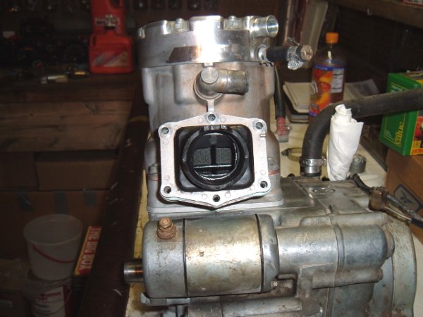

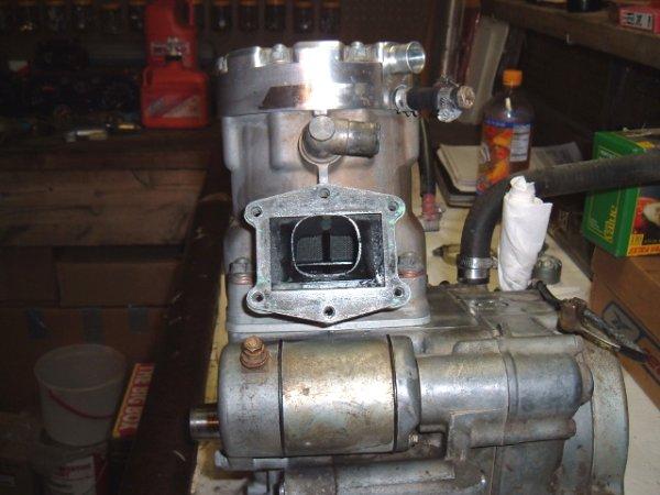

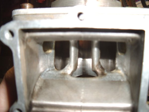

File comment: Here you can see some of the porting work done to the intake

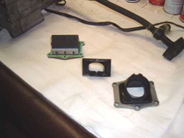

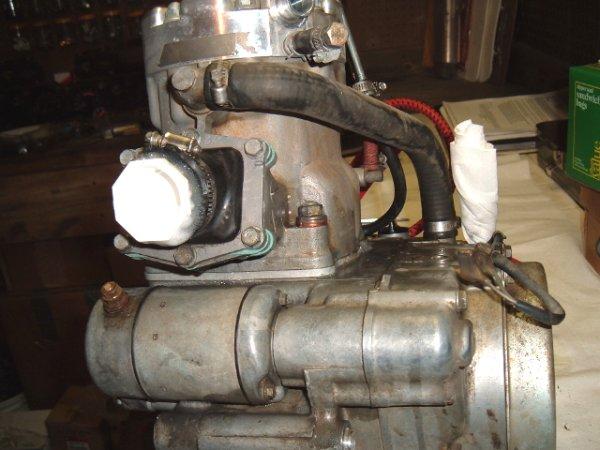

File comment: parts is parts right - anyone know who made that stuffer ?
File comment: I'm not sure if this is a 90 FL400 reed Cage or a CR Reed Cage or ? - Any Ideas
File comment: Custom Stuffer - Fits intake boot very well
File comment: Notice that this is not a FL400 intake boot
It is center mounted - Did someone have a part number for this ? It fits the 39mm carb very nicely

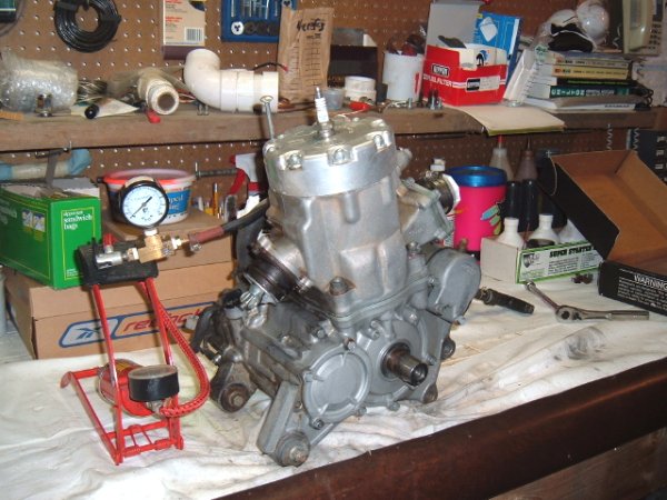

File comment: Bonus points if you didn't read the Subject and can tell me what you are looking at ?
I pressure tested the Engine she held 6lbs for about 10 minues - I did find one small leak (Check Next Pict)

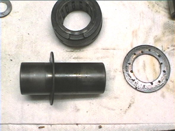

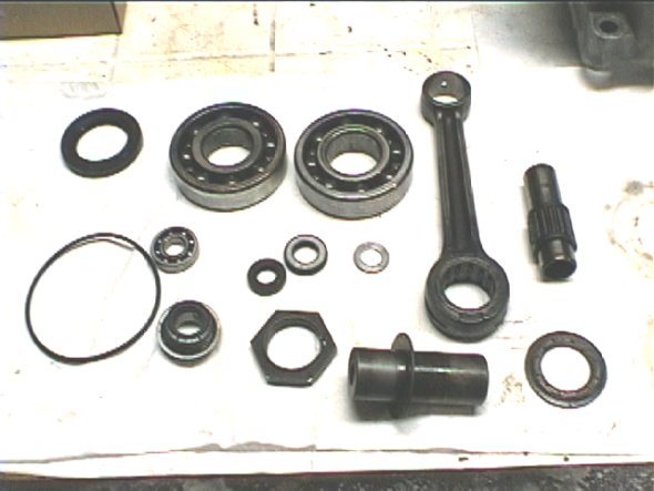

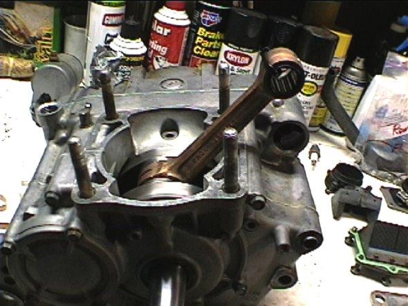

File comment: These are the lower unit parts that were replaced

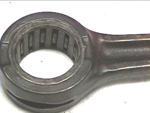

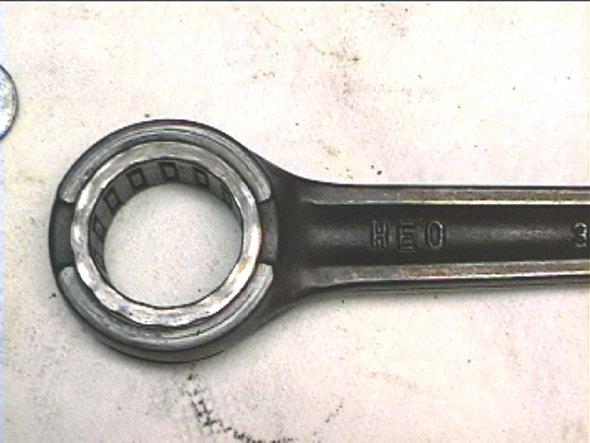

File comment: Lower rod bearing was Toast

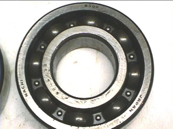

File comment: They looked great
File comment: Here are the two Crank bearings - both appear to still be in excellent shape

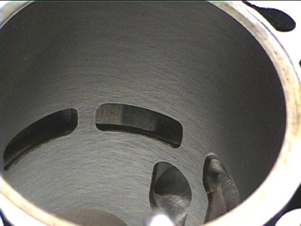

Since I had the lower unit torn apart and sent out to be fix I also decided to send the upper unit to Bore Tech to have them treat it...
Some picts of their work below...

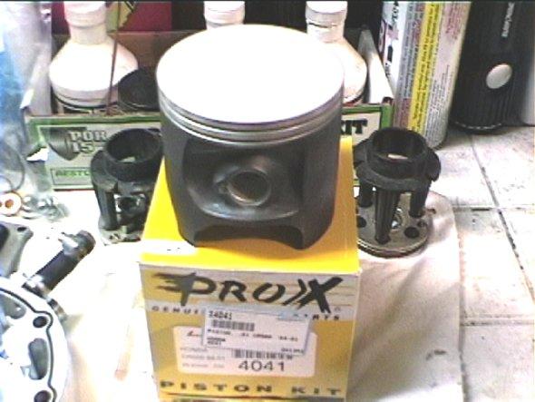

File comment: How about that nice new ProX piston - pretty isn't it...

File comment: Another shot - Notice how thin the cylinder walls and sleeve is in this beast...
File comment: Bore Tech applied the Carbon Bore Process to the cylinder
