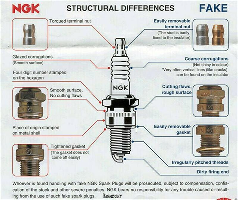

What to look for guys...

wow,are the boxes or packaging identical ?
