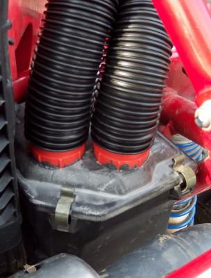

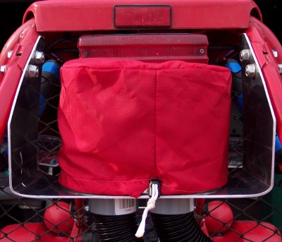

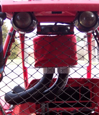

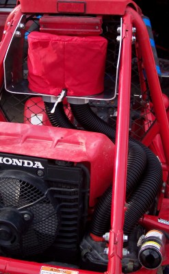

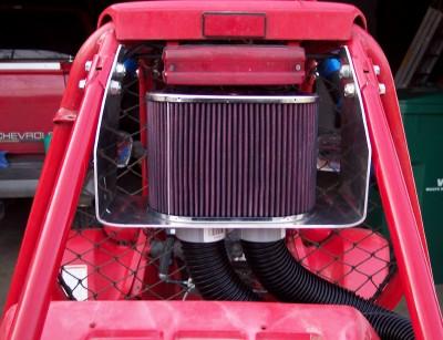

Here are a few pics of the modified Litespeed Pilot airbox mod and pre-filter set up.
This is really a great idea and looks sharp also. All it takes is a shop vac hose set, some conduit fittings and nuts, some epoxy, a small piece of aluminium and a filter from a buggy shop.
Much thanks and appreciation go out to Litespeed(and family) for taking his time and knowhow to hook me up!
