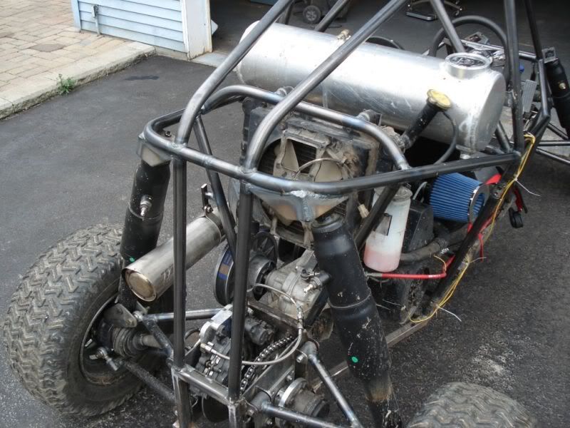

This is my buddies son's buggy. It has a 2000 Sportsman 500 Engine in it. Scrambler 3:1 FNR box, 3:1 chain reduction, 25" tall tire.
Great running little Engine. For the most part, for the trail riding that we do, it works good. But he has to push it pretty hard to keep-up. It will turn 7000rpm, but it is not making any power up there. It pulls good at 5500-6000. Might do 50mph on a hard flat run but takes a while to get there. If speed and power is the goal... maybe not the best choice.
Depending on the type of riding you do, I'd be concerned that the extra reduction of the Oddy gearbox is going to keep this Engine above optimum rpm. Your clutching is going to need some good overdrive to keep some load on the Engine.
As far as the carb mount, it'll work.

Athis wrote:
Ok...excellent info and thank you for the video! But help me out a little...."Scrambler 3:1 FNR box, 3:1 chain reduction" <---- you mean it is not using the Ody stock Tranny?
This isn't an Odyssey, it's a homebuilt machine. It has a Polaris Scrambler 400 trans to get the CVT and FNR, which is 3:1 reduction. Then chain drive to the back axle, which is another ~3:1 reduction. This and tire size gives you final drive ratio's.
(This pic was before the Sportsman500 install)
The FL350 box is about 10% more reduction than this set-up, (with an equivalent size tire). Couple that with an Engine that is maybe 2000rpm shy of the stock 350 and you can see that you'll be down on top end, and need to do some clutch test and tune to find the 500's sweetspot. If your Engine is running above it's powerband all the time it will feel lazy and slow. Your not utilizing the power well. If your short on gear ratio the Engine will be screaming at cruising speed . In order to keep the 500 in it's optimum say 5000-6500 range you are going to have to either give up a bunch of top end and risk high rpm cruising, or increase the amount of overdrive in the CVT.
