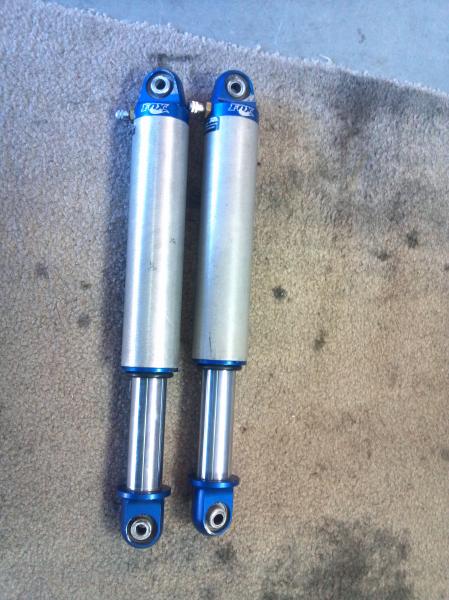

Hows 325 shipped sounds they are in great condition. They are the exact same lenght as my works. Just set the presure to your liking and way cheaper then works

I have no clue what the part number is. The shaft measurement is 4 1/8 inches and will work with the works shock bolt kit and some push in spacers in the frame up top for a smaller bolt and bolt right in. If i don't hear back by the end of the day these will go to the next person in line that pmed me. I have 2 people that pmed me

the part # for the fox air shock i believe is 980-02-013 4" stroke 2" dia

Can someone verify the part number on these?
By doing a google search it shows the part number 980-02-013 A as 15.53" extended length. If this is an eye to eye measurement they are too long. If this is an overall length, then these bad boys would work and are only 211 a piece. Considerably less than the works shock.
If so I'm going to buy a set!

those r the shortest 2" body air shocks fox makes from what i could find and the 4" stroke matched what shoub and some other posts i had seen said so im pretty sure they r it.and actually most of the sites i have found it on claim ext length is 15.29 but quite few sites r showing an a after the number don't know what it refers 2. im starting to think the 15.29 is eye to eye and 15.53 is actual shock length

I was just looking at that myself. 15.29 should work although it might take an ever so slight adjustment on the upper link to give a slightly positive camber of a degree or two.
There is another part number of 980-99-013A that lists the same length but can't tell what the difference is between the two.
Here is what I got from a google search.
2.0 Pro-Series Air Shock 4.0" Travel, 1.25" Shaft dia. Extended length 15.29" and collapsed length 11.29" from eye to eye. You can adjust the nitrogen air pressure in this shock from 10-500psi.

I just measured and my works rears are 15.1875 eye to eye
They've got 4" of shaft before the rubber bump stop
I can tell how much of the stroke is used
My question would be...on the fl350 is the shock acting as the limit stop on these?
If so, someone should check if these fox shots are meant to be used as a bump stock shock
Also, remember that you will need access to, or own a nitrogen setup, to adjust these
PostPosted: Tue Mar 12, 2013 5:42 pm
Yes the stock shocks are the limiting stop.
Fortunately I have access to a nitrogen supply!

The shocks we are talking about are not too long so there is no need to run a limit strap or have them shortened if they are truly 15.29". They would only be .040" longer than the Works shock which specs in at 15.25".
As I said before that if they are indeed too long and cause the U joints to bind, this could easily be compensated for by running 1 or 2 degrees negative rear camber.
