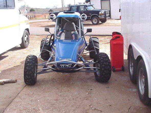

Drakman has FOX air shocks on his Drakart, when he pulled it off the trailer after
setting all winter he noticed the front suspension was setting low, I checked the p
pressure and the left side (looking at pic) was low (150 psi?) and the right side
(looking at pic) was 0 psi, I charged them back up to 200 psi, no signs of leaking
oil, since the nitrogen is over the oil the nitrogen had to leak out some place at
the top of the shock, the nitrogen only occupies about the top 2" of the shock,
I suspect it leaked around the valve stems where they thread into the shock
or the valve core...

It is simply amazing the items/tools/supplies that Hoser has in the ritz.
When I first pulled the Drak out, I thought I was screwed, then to my amazement, out of the Ritz rolls a tank of nitrogen.
Thanks again Hoser, you saved my trip!
