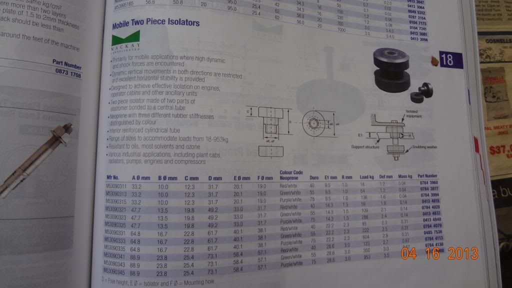

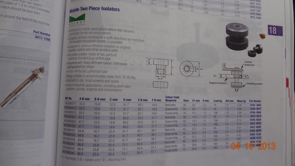

Came across these mobile 2 piece mounts a while back.
Reminds me of the Pilot/Ody style.
The larger main portion MAY be another alternative?
Anyone out there have a pic with dimensions of their OEM mounts for comparison?
Diablo,maybe another poss option?

Good thing is that this range of hardness is within the polyurethane spectrum and looks like that catalog page you showed offers a mount in 55A.
