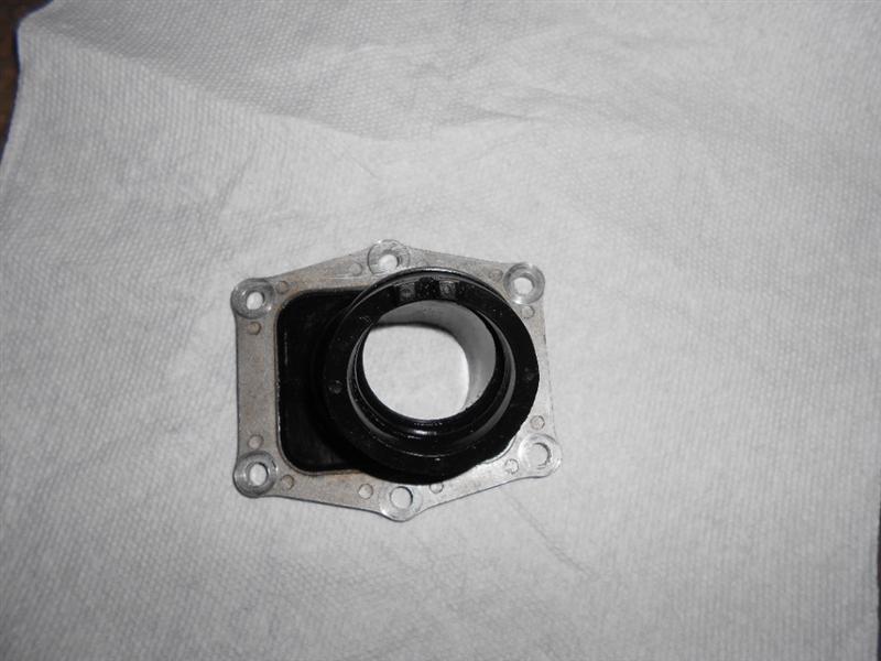

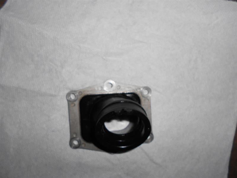

I have a bunch of intake manifolds that the rubber is rock hard I mean so hard you cant flex them at all, no visible damage its just the rubber is rock hard been waiting to find a way to breathe new life in them for years finally the other day after running across a old one on the bench I decided I would try a few things.
I have seen kart racers take old hard tires and make them soft and sticky by soaking them in diesel fuel then washing in soap and water makes them stick like glue, only negative side affect is the smell whilst treating them, once word got out about this locally you no longer seen used kart old dry hard kart tires for sale "cheap" in the pits, was a farmer that discovered this trick...
When I wash parts with brake cleaner and or carb cleaner I do it in a tub then pour the used dirty cleaner into glass jars keep it for future parts washing use the dirty stuff only use new for the final rinse, things you do when the price of these cleaners has more than doubled in the past few years, before I just let it evaporate and bought more cleaner 12 cans at a time on sale, by adopting NEW work procedures here at the hoser compound I have cut my solvent expenses greatly. .
Anyways I took that old rock hard Pilot intake manifold and put it in a coffee can of this used solvent and let it soak about 24 hrs then it was softer than it was when new, I broke out the brand new manifold I have and confirmed it was way softer.
I then allowed the manifold to set on the bench for a few days and as you might guess it returned to the rock hard state it was in before I soaked it in the brake and carb cleaner mix.
So I got to thinking soak it again in the solvents and get it soft then remove, dry with a towel then submerge in automotive Engine oil for a few days, it appears to have absorbed some of the Engine oil into the rubber and is now as soft as a new manifold but not like most oil soaked rubber you have seen in the past.
Got it setting outside in the sun I want to make sure the heat form the sun will evaporate out all the solvents it absorbed before the oil soaking see what happens.
Next I soak one then when soft install it on a 39mm carb let it dry a few days see if it will retain the fit on a 39mm carb might be a new procedure for installing carbs in the future.
Need to make something like a chunk of aluminum to put in the manifold and simulate the weight of a carb hanging on the treated manifold then bolt it to my Pilot and drive several thousand miles off road see if it falls apart or splits.
What else could I submerge the manifold in other than Engine oil to soften that might be better to condition the rubber, silicone spray, armorall ?
Thoughts?

PostPosted: Mon Jun 11, 2012 4:54 pm
Are those factory or aftermarket?
PostPosted: Mon Jun 11, 2012 6:02 pm
Factory I am playing with 3 different manifolds at the moment the one pictured is the manifold off my Pilot, second one is off a ATC250R Engine, third is a stock manifold off a FL350
