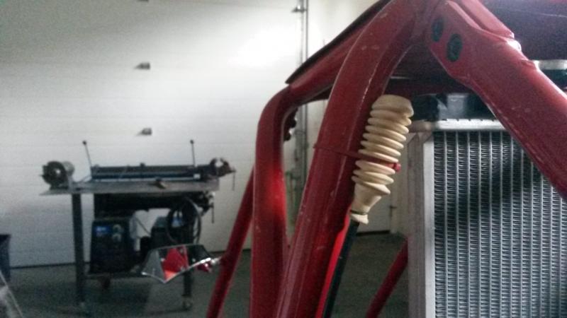

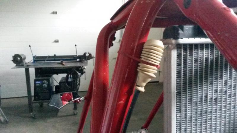

During the last ride we blew a belt on the death machine, busted the left rear shock eye and then I noticed a collapsed bellows. I'm suspecting that the crank seal on this Engine is on the way out. This is the Engine with the welded piston and the Engine that blew up the clutch on the homemade dyno.
This machine and Engine have seen a lot of action.
The good part seems to be that it's not pulling oil out of the counter balancer area and the oil is clean.
The clean oil means that the seal is not allowing two stroke oil into that area from the crank case.
The collapsed bellows does tell me that it's pulling a vacuum. What puzzles me is that there is no oil missing.
CO
File comment: Possible crank seal leaking and pulling a vacuum.
File comment: The bellows as it would look when all is normal.

Does that when it's running? Or does it do that after cooling of, after running?

I didn't notice until we got home so I can't say for sure when it happened.

My first thought was it just happened because it cooled off. If the system is sealed, but vents with enough pressure, wouldn't it make sense that the bellows would look like that after it cooled?

I used the word ''sealed'' loosely. Even if the system were only able hold a percentage of a psi before it leaks at, lets say where the hose goes into the bellows, then as the system cools, you get a small amount of vacuum.
Kind of like when a plastic gas can swells up, some of the pressure then slowly leaks out through the threads in the cap, or the vent cap, then as the can cools, it looks like it's caving in.
