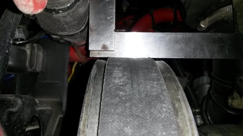

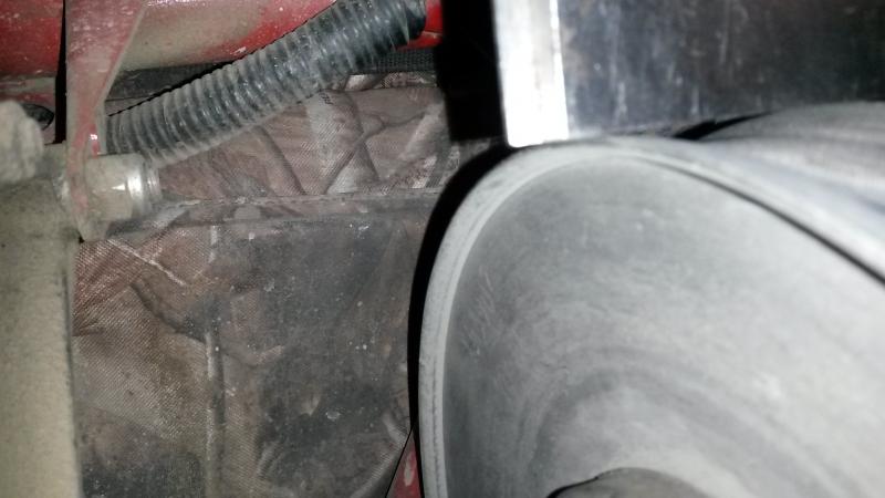

Most of us here already know this, but for the new members or those who don't, here are a couple of pics to tell. This is a real easy check on a ride as well, just by looking at it.
Below are two pics.
One is a new belt I just put on and it's well above the driven shiv. I laid a machinist square on top of it so you can see better.
The other pic shows the belt well below the driven shiv. This one is almost toast as I could here and feel it slipping bad on the ride home.

File comment: New belt
File comment: Couple years old belt -- toast
PostPosted: Tue Jul 07, 2020 2:42 pm
Posts: 1070
Any idea how many hours are on the worn belt? How about on your machines in general?
PostPosted: Tue Jul 07, 2020 3:22 pm
on the worn pic, are you sure the shives are fully closed? I think depending if the machine was turned off in gear or allowed to spin down could make a difference, a new belt will be noticeably better in grip.
I can't do that on mine I'm using a wide sled belt, it rides up high on the driven clutch, at first I thought it might be an issue but it did well last year so I think we're good, I am using a sled drive clutch which takes the wide belt.
PostPosted: Tue Jul 07, 2020 3:57 pm
Sorry no idea on how many hours on that belt.
I think it's been two years since last belt. Most rides are about 5 hrs. Number of rides per yr vary depending on weather, work etc.
Shiv is closed.
CO
PostPosted: Tue Jul 07, 2020 4:08 pm
I think you got your moneys worth out of that belt :-)
I don't think I ever actually wore out a belt, they usually self destruct :shock:
most have some warranty and I have returned them after exploding and received replacements, probably just waring out would not be returnable.
