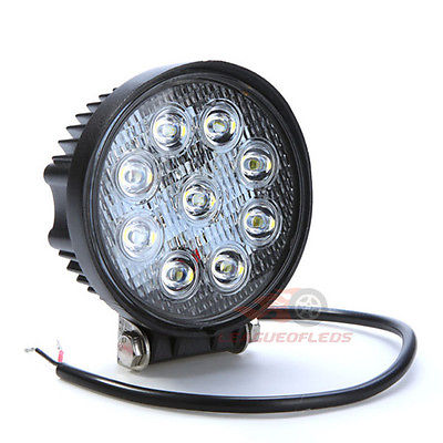

I have one of my headlights out and am wondering what's a good replacement headlight or set of bulbs if they can be changed. It's on a fl350
PostPosted: Fri Apr 18, 2014 7:51 pm
If you want to replace just the bulb, get the Zenon replacement bulbs, They are quite a bit brighter than the stock http://www.ebay.com/itm/HONDA-FL350R-OD ... 9f&vxp=mtr . I bought the 27 watt LED, its much much brighter than the Zenon. These are not the same brand I bought mine are made in USA. http://www.ebay.com/itm/2pcs-27W-LED-Wo ... 06&vxp=mtr

PostPosted: Sun Apr 20, 2014 12:43 pm
you can install HID bulbs in the stock housings. I believe they are the same as the yamaha rhino, that is what I used in my pilots stock housings.
http://www.ebay.com/itm/Yamaha-Rhino-Ze ... aa&vxp=mtr
bulb is the H6m

Be nice if you could get the LED guts to fit the stock Pilot head light bucket.
PostPosted: Sun Apr 20, 2014 1:58 pm
Good idea, I might get in a pair and try that on the wifes Pilot

I installed them ,not that same bulb, but on some aftermarket housings. They worked well but sometimes they were flakey and would not "start", had them wired correctly on thier own circuit but thay put out good light. I like the LEDs because they are bright and less hassle with the HID transformers and stuff
