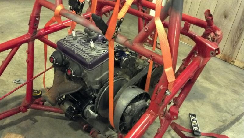

PostPosted: Sun Feb 02, 2014 12:55 pm
Posts: 224
Location: Ontario Canada
Here is a picture of Nitrosport's Engine. Look at the difference in diameter of the ring gear compared to mine. I used the ring gear from the first go round of parts that was tagged and marked 670 only so I/we figured it was right. Maybe we found the root of the trouble I had. Wrong, smaller diameter ring gear, the correct starter and brackets wouldn't work.
More info for the pool.
